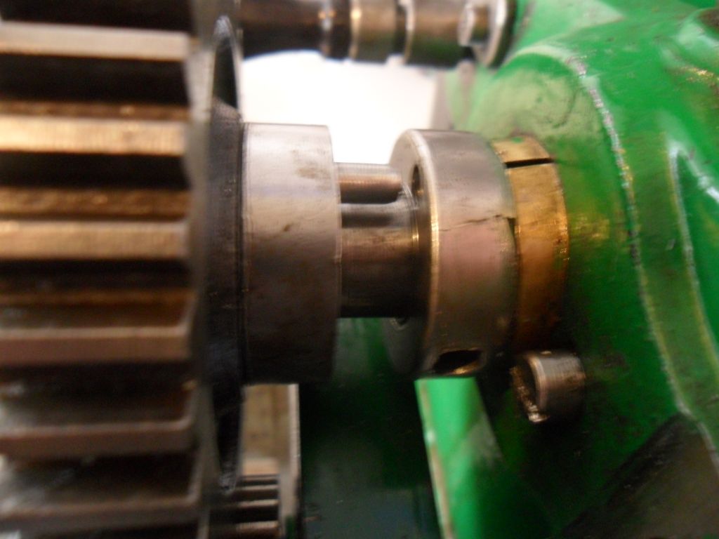

                        Graham Meek has a version of his clutch to suit the ML7.
                        #291401

                          Muzzer's posting with the LINK to the "interknot" regarding the BH600 actually has the picture of my Myford S7 version!!
                          THere are indeed many more versions for other lathes that have been drawn.

                              The advantage of the Meek system is that the spindle does not need to be stopped and reversed to run the carriage back to start again, as the "single dog clutch" is used also to reverse the drive to the leadscrew with the spindle still spinning. The leadscrew clasp nuts stay engaged at all times.
                              #292290
                                Graham Meek has sent me this photo, which may be useful:
