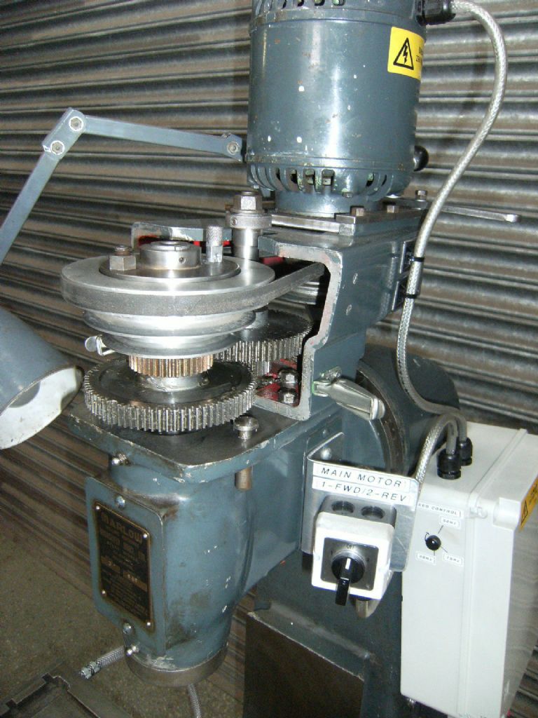

        Back asking for more advise please.
        A previous owner fitted the intermediate pulley as shown below, together with a DIY motor mount, all well done.
        That mounting plate is big and heavy!
        Now, do I leave well alone or remove?
        I do not, however, have the original motor mount with shield that bolted to the spindle pulley shield, that I do have.
        I'm very tempted to leave well alone a see how I get on with that extra pulley in the system with VFD.
        Marlo A3 Album added that has a side-on photo of that big plate.

          The motor on my Marlow mill is a 3 phase flange mount and it is possible that in the past the motor failed and the previous owner fitted a foot mounted motor and to get the drive to work added the pulley.
          Mine runs fine on a micromaster converter and I tend to use the middle ratio on the pulleys for most jobs allowing the micromaster to vary the speed.
          Does yours have one belt or two?
          Bob
          #166925
          Robbo
            @robbo
            Bob is right in his suggestion that a previous owner has used a foot mount motor (mounted on that bracket at the rear) and added an intermediate pulley to increase the range of speeds available on the pulleys, and has removed the original backgear.
            Originally had a flange mounted motor with 3-speed pulley drive and a further 3 speeds available through the backgear.
            I don't think there is much option other than to stick with what you've got unless you want to do another complete redesign of the drive system.
            Picture attached of how it originally looked. Apologies if you already know this

              Mine is not like that as it has no gear wheels just belt driven 5 speeds originally but variable now due to the micromaster converter. I think mine originally went from 375 to 2250rpm and the geared 6 speed version from 85 to 1450rpm.
              Edited By Bob Brown 1 on 18/10/2014 22:06:47
              #166934
              Robbo
                @robbo
                Bob,
                I think the detailed spec varies depending on where the machine was built. You can see from the plate that Geoff's was made by Victa Engineering, I've forgotten where that was, but mine was made by Dronsfield Brothers in Oldham.
                Even so my feedscrews are different from those detailed in Dronsfield own advertising literature. There is sparse information on when and where they were built

                  Found my Marlow advertising leaflet, and there were 2 drive options, the 5-speed direct, and the 6-speed with backgear and 3-speed pulley. The 5-speed is illustrated on the leaflet.
                  So Bob's and Geoff's are the 5-speed option, mine is the 6-speed.
                  Bob is quite correct about the speeds, 375 – 2250 on the 5-speed, and 85 – 1450 on the 6-speed. Given the noise the backgear makes, a VFD would make for a quieter life on the 6-speed.
                  Geoff, with a VFD fitted, why not forget the intermediate pulley and have a direct 5-speed from motor to spindle.

                      One belt, and the motor had a 3-step pulley ranging from 65-48mm measured at the outer edges, 5/8" shaft.
                      New motor has 24mm shaft so a new pulley ordered from RDG.
                      The intermediate pulley is easy to remove, but I think I will use it as a jockey pulley, as a belt from motor to spindle will be somewhat long with possible mismatch with pulleys, so a bit of tensioning will not go amiss I think. Can always remove it.
                      Robbo,
                      Its the first time I've seen that set-up.
                      The motor I've taken off is a 1hp Gryphon, foot mount.
                      The thought of redesigning the drive train fills me with the heeby jeebies. Let's play with what I have.

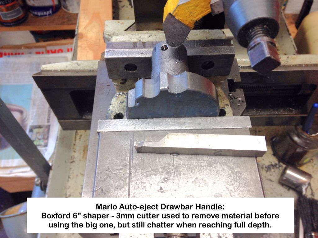

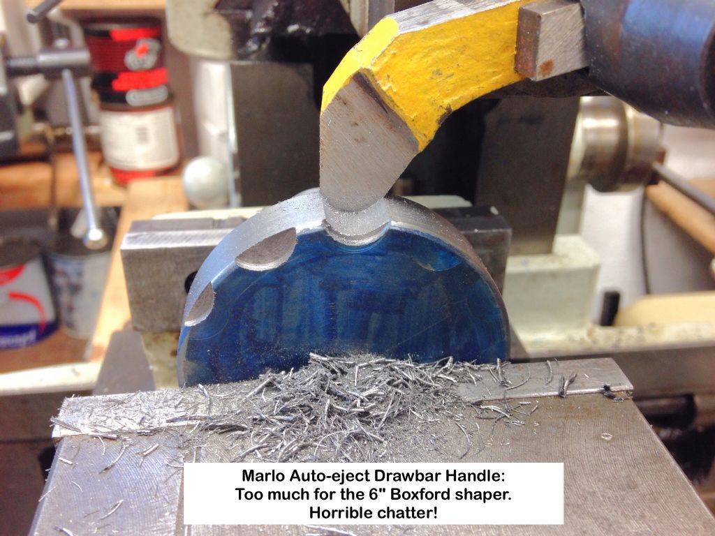

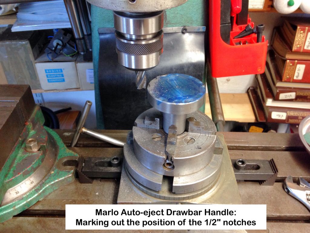

                                          Need help from the Collective please.
                                          Last stage to finish the Auto-eject drawbar, made from the Hemingway kit.
                                          I need to machine the half round 1/2" notches in/around the periphery of the handle.
                                          Any ideas please.
                                          This set-up for marking them out is just a little light weight for either a slot drill or milling cutter:
                                          Marlo A3 Milling Machine Drawbar
                                          This on the Boxford 6" just produces such monumental chatter, it feels as if the shaper will shake itself to pieces:
                                          Have used the 3mm cutter to remove material first:
                                          Geoff – Actually getting things done disgust
                                          #172415
                                          Bob Brown 1
                                            @bobbrown1
                                            If I was doing that job I would use a round nose (ball) cutter in the mill

                                            #172434
                                            OuBallie
                                              @ouballie
                                              Posted by Bob Brown 1 on 13/12/2014 14:20:06:
                                              Edited By Bob Brown 1 on 13/12/2014 14:21:53
                                              "Damn and blast" as my old man was fond of saying when something obvious was pointed out.
                                              I have one of those, as well as the Excel filing machine that has been giving me verbals for not remembering what it's used for.
                                              May have already made too much of a whatsits so far, but will see tomorrow.

                                              mechman48
                                                @mechman48
                                                I would have used a 1/2" slot mill in the mill machine & plunge cut down or an end mill coming in from the OD as in your original set up, just take lighter cuts, or use a ball end mill as said, bearing in mind theoretically you can cut a depth of 1/2 the cutter dia. X 1/4 the width with an end mill… or is it Viky verky…. thinking , the old grey matter is slow today.
                                                George.

                                                OuBallie
                                                  @ouballie
                                                  George,
                                                  I did try that way, but I was either too greedy with the cut or that DIY rotary table is not up to it, so gave up.

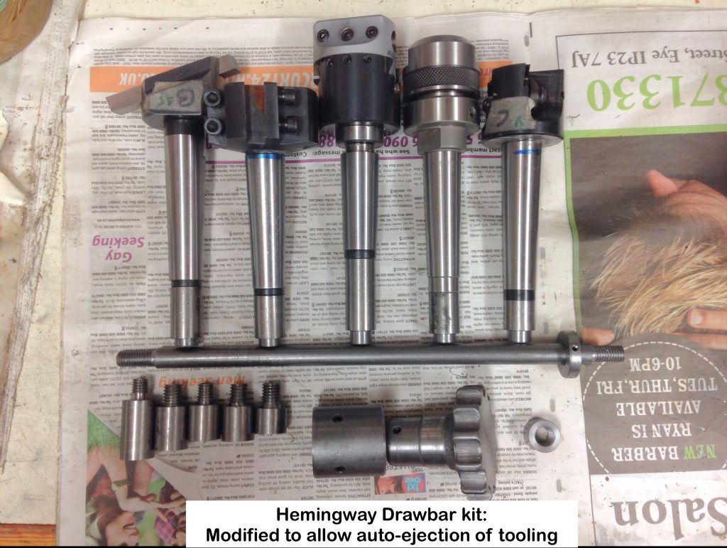

                                                  Drawbar:
                                                  I have just finished it and the photo shows all the completed parts, plus at bottom left, my first attempt at the MT tool extensions that have now been added to the scrap bin.
                                                  In my post when I said I had sorted the height of those extensions to allow the use of one drawbar, I spoke far far too soon, with fate giving me a real kick in the posterior.
                                                  I could not have made a bigger codswallop even if I tried, and then spent days trying to figure out where I went wrong, but eventually giving up in utter disgust with myself.
                                                  That was on Friday 28th November! I know I know, slow coach.
                                                  Then on the Saturday I thought (bad move) that I had sussed it out using Touchdraw on the iPad, but no, so retired to recuperate and give the old grey matter time to come to its senses.
                                                  Tuesday 2nd of this month brain at last started to operate, and I came up with the perfect solution of determining what length to make those MT tool extensions so that they all reached the same height inside the spindle, when screwed onto each tool.
                                                  The method I used can be seen on two of the MT tools in the photo.
                                                  Who can see how/what I did?
                                                  Will explain later of course if needed.
                                                  The handle was finished off using a combination of Excel filing machine, hand file then small grind stone in the battery drill.
                                                  The Auto-eject collar is attached to the drawbar, with the spindle cap, that the collar pushes against, and handle below.
                                                  All the 3MT tooling is shown at top, each fitted with its specific extension that allows for a single common drawbar to be used.
                                                  It took a little trial & error to get it to eject the 3MT tool, but does so now with about a 1/10th turn of the bar.
                                                  All I can say is that the time and angst this has caused me has proved well worth the effort, and I can recommend the system without reservation.
                                                  Now need to do one for the Tom Senior horizontal arbor.
