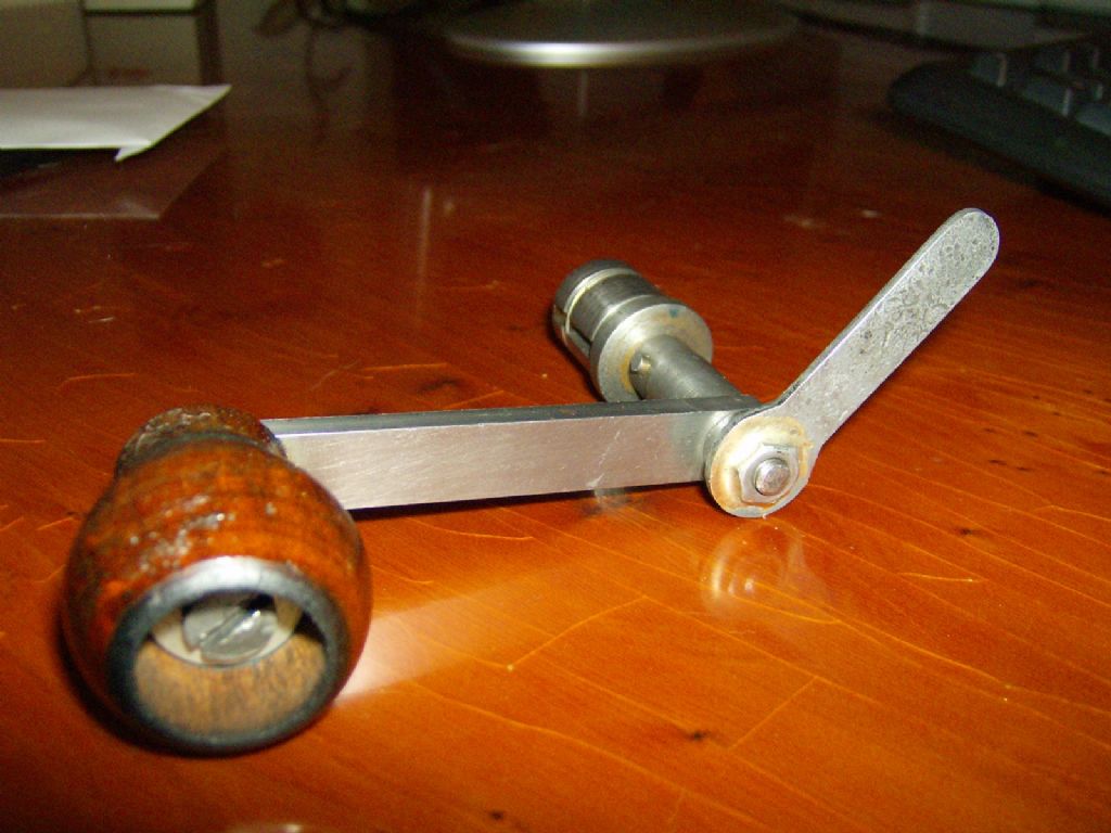

        About ten years ago I had a design for a mandrel handle published in ME. I was (and am) pleased with the 'floating collet' design that made it both short (so it doesn't fill up the whole spindle bore) and easy to fix. But it was alweays a bit slow as I needed an M10 spanner to tighten or loosen it. Over the last couple of months I started using a small steel plate spanner, the kind that come free with a flat-pack, and realised that if I silver soldered it to the nut life would become easy.
        It is literally a 2-second job to fit or remove the improved model. In these days of variable speed drives you see few designs for such handles, but I find mine invaluable for tapping and threading.

          Looks a LOT better than putting the key in the chuck!

            You may have seen my mandrel handle .I think there are great for tapping etc I use it for screw cutting as well .For saftey I have srung mine. I can also leave it Sprung loaded mandrel  handle in place when the lathe is running.

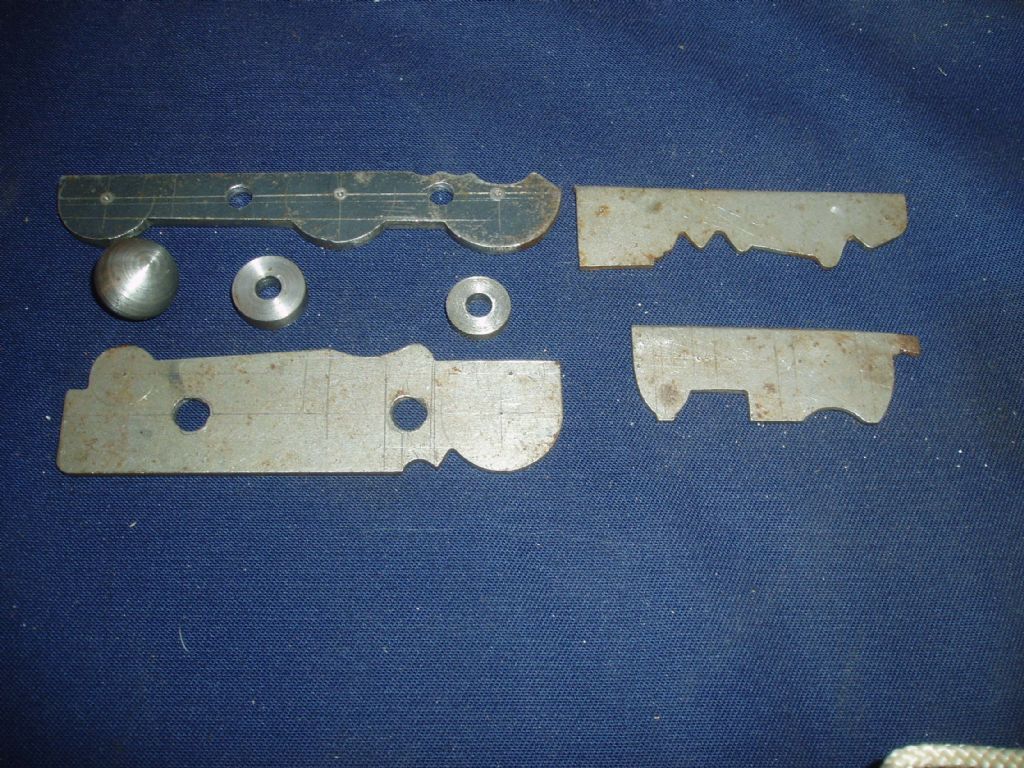

                Its a copy attatchment I made for ball handles etc works fine I will insert a couple pictures in a moment

                    Phew! So you apply the cut manually with the top lever which keeps the index against the template?

                      Thank you for elert email. The adjustment of the stylus is made by unlocking knurled screw and adjusting the screw bottom right in photo to adjust the cut . you cant see them but there are lines marked on it .
                      As its one to one. Its quite pleasing to use Not CNC !!!!!
                      Its important the the cutter shape is the same as the copy sylus. On the 2nd picture you can see the slide

                          Its my own work . The slide photo 2 was off an old plain lathe a Mate gave me The long slotted bar came from the side off a box I used to maake or compresssion moulding M/Cs. All the shaped knobs were made using itself wiith just standard nuts.I did use it on my Bantam lathe but the pattern was at the top. hench the slotted bar.
