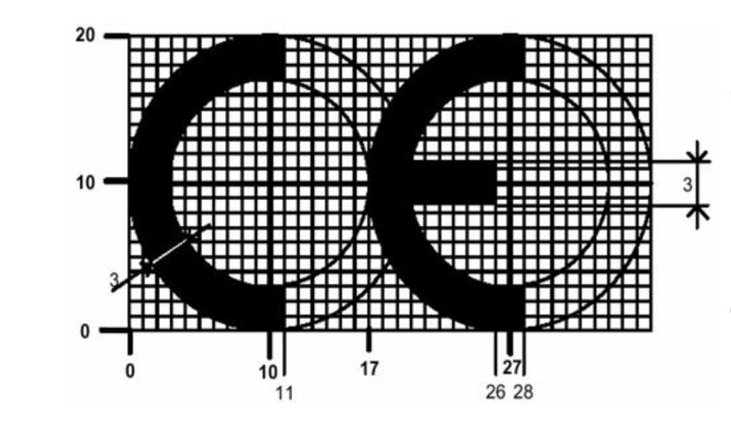

                                    Compare a typical 'Chinese Export' mark with the CE mark shown here: **LINK**
                                    http://www.underhillengineering.co.uk/CE-Marking
                                    Easy comparison here: http://www.icomuk.co.uk/News_Article/3794/17103/
                                    Edited By Michael Gilligan on 31/03/2017 08:34:43

                                              For my penance … here is the definititive European 'CE Mark'
                                              Copied from that troublesome 'underhillengineering' page:
                                              P.S. The culprit appears to be
                                              https://cdn.cookiescript.info/
                                              but I'm not making that an active link.
                                              Edited By Michael Gilligan on 31/03/2017 09:54:29
