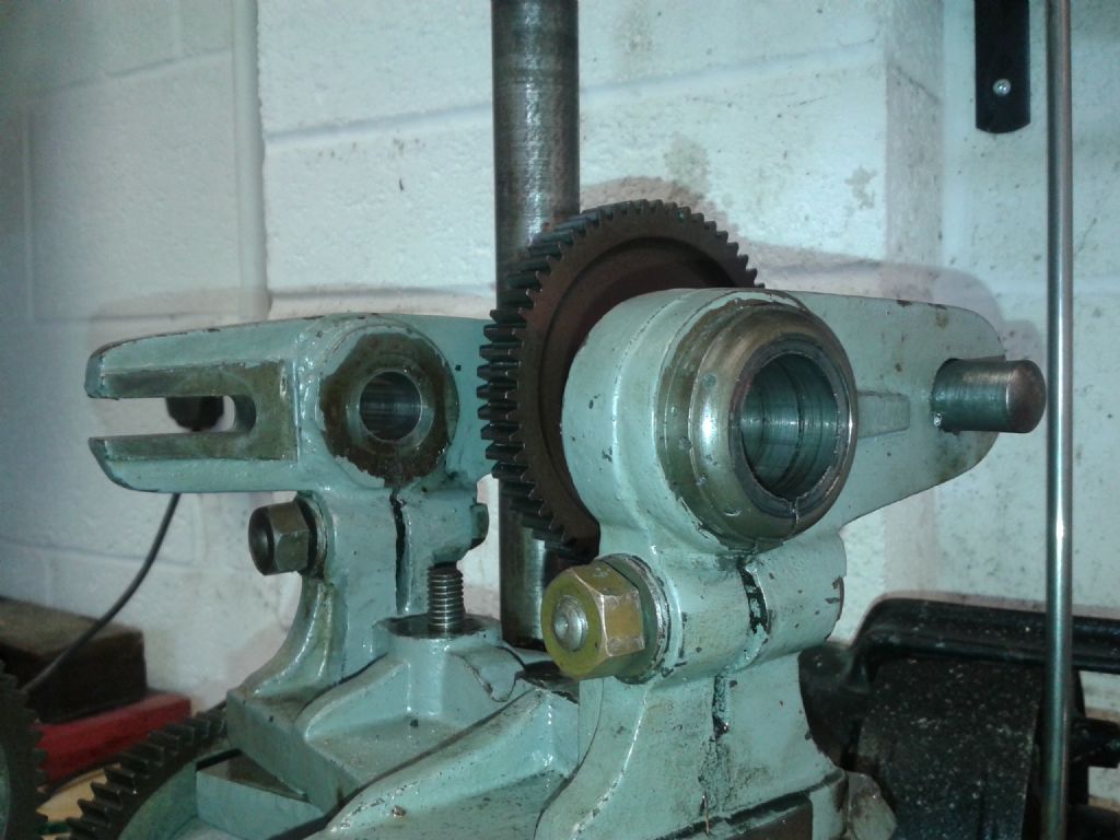

          Hang on, took a while to click, do you mean convert the front bearing to a taper roller bearing?

              Posted by Graeme Whitfield on 23/02/2015 19:11:22:
              Hmmm, i wonder if there is room…
              I really don't know if there is room for a full taper roller assembly, but; if not, you could use just the outer race, and then sleeve the existing spindle with a Bronze male taper …
              I think we need some dimensions.
                    I don't think I would personally consider a taper-roller bearing conversion with that design of headstock because there is no bracing between the bearing stanchions to take the necessary preload. I'm pretty sure those supports would close up when loaded and pull them out of alignment.
                    A new oversize spindle should be doable with a little care as should line-boring the headstock bearings with a between-centres boring bar.
                    Martin.

                      • Diameter of the spindle on its bearing surface
                      • A sketch of the existing plain bearing would be useful for reference. [Can you easily remove it from the casting?]
                      … It looks quite promising.

                        There is no bearing in the casting, tje spindle runs in the iron. Its shaped so it looks like a bearing but there isnt.

                          Good point blowlamp, I could probably rig something up to see how much pressure it takes to start closing that gap. As for boring, id have the headstock apart so couldnt power any cutting tools.

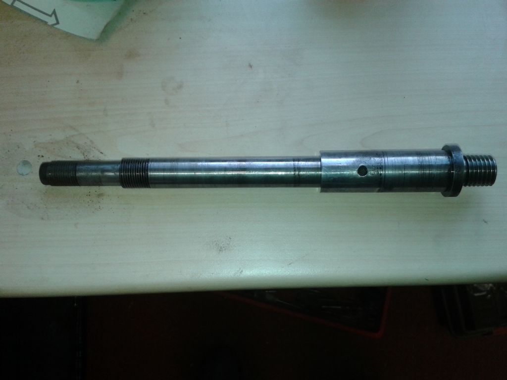

                                Spindle is 0.996″ but at bearing journal is worn down to 0.993″ housing is 1.156″ wide. The thrust area bit that looks like a bearing sticking out is 1.660″ diameter.
                                #180961
                                Graeme Whitfield
                                  @graemewhitfield34761
                                  I cant measure much wear in the bore. Trying to measure the bore using digital calipers I get 0.998″. Thats with the adjusting nut slack. Using internal calipers to feel drag I cant detect any difference in bore diameter anywhere.
                                  There must be though as thats only 0.002″ clearance, allow a bit of claming down with the adjuster and that should be well in spec for oil clearance in plain bearing. However, I can easily see/feel lift in chuck and have measured 0.12mm lift with my dti.
                                  (Sorry for switching from imperial to metric)
                                  #180962
                                  Graeme Whitfield
                                    Ahhh, im an idiot. Journal is worn to 0.993, giving me the play.
                                    So the spindle is worn more than the bore.
                                    Interesting, maybe just finding someone to plate/grind or sleeve the spindle is the way forward?
                                    also means making a new spindle is viable again. Nothing to loose in trying I guess. For a beginner I guess the through bore and taper will be the hard part.
                                    Edited By Graeme Whitfield on 23/02/2015 22:35:11

                                                Here is the spindle, its just the larger area that is worn.
                                                Options are, try and make a new one.
                                                Get it ground and plated.
                                                Get it turned down and sleeved.
                                                I have no idea, but my gut feeling is sleeved would be cheaper to get done than plated?20150223_152804.jpg

                                                    #181033
                                                    Graeme Whitfield
                                                      Been to see a few pro’s, they all said boring it isnt a good idea. They all said just grind, plate and re grind the spindle. Been quoted ?115-?130 from one company an ive another to go see. No one seems to think sleeving the spindle is a good idea either.
