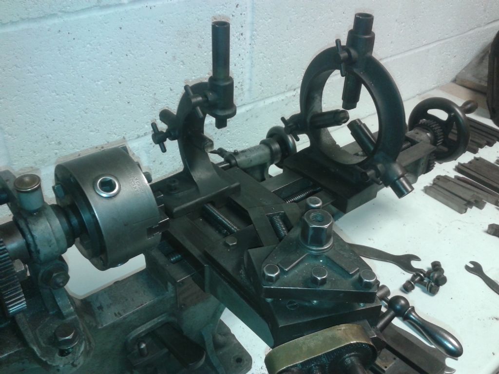

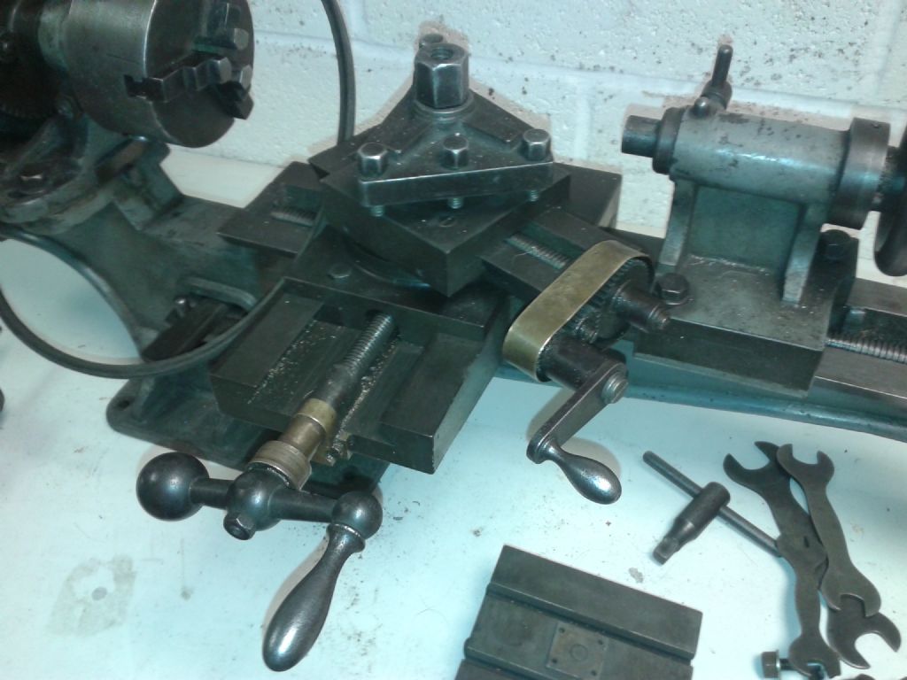

                                              I have considered, if making a spindle, seeing how much bigger I could go. I could increase diamater a fair bit, get a bigger bore, bigger nose thread and taper. Only limit is meat around the bearings and how far I could bore the pulley. I have 3 or 4 faceplates, one with lots of tapped holes, looks like a dividing plate but isnt, 2 faceplate chucks, a nice 4 jaw and a lovely 3 jaw so id need to bore and re thread all those too.
                                              Still, could be a good opertunity to upgrade it.
                                              Its been reground in its life, has new leadscrews and nuts and has been modified to fit a proper cross slide and top slide. I also have a traveling and fixed steady so on the whole, although its old and not all that stiff, its worth getting it sorted.
                                              In fact, ill add a pic of the cross slide to my album (I cant put it in the thread from my phone). If anyone wants to see if they know what its from, no one seems to recognise it. Looks very ‘britannia’ to me.

                                                #180920
                                                Graeme Whitfield
                                                  @graemewhitfield34761
                                                  Ok, so i worked out how to add a pic, but not how to put text as well!
                                                  Anyhow, getting sidetracked, anyone recognise these parts? Certainly not original.
