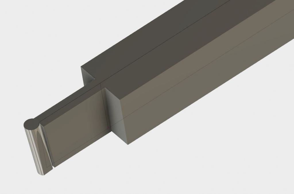

              You could make a steel shank and silver solder a piece of 2.5mm HSS or carbide drill shank to it. If your going deeper than 1.25mm then grind some side clearance.
              Some HSS drills do have a soft shank though, so a good quality drill will be needed. The temperature of silver soldering HSS won't effect the HSS hardness much.
              As illustrated below.

              #295577

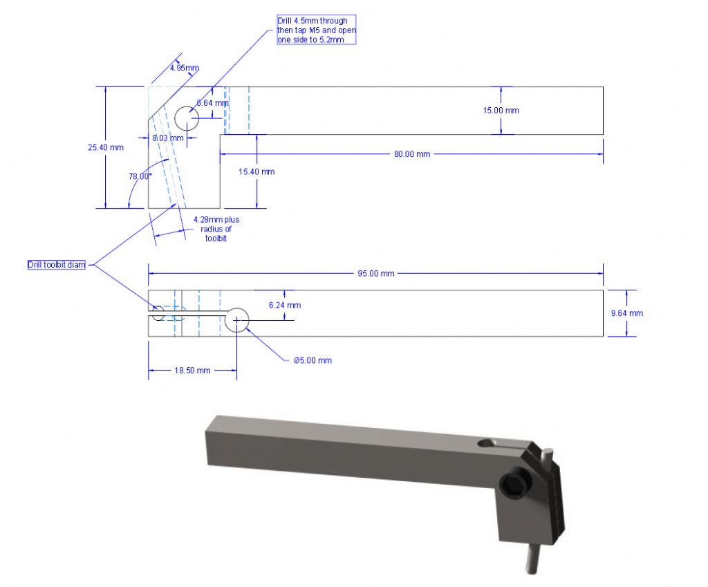

                    What a coincidence. I've just done exactly that. I got a bit of HSS drill rod and made the tool holder, shown in the following picture, from a piece of scrap. (That's why the thickness is a bit odd.)
                    The drill-rod is held at 12 degrees and ground off to be horizontal.
                    EDIT – I've just noticed that the TurboCAD imp has struck again. The dimension shown as 15.00mm should be 10.00mm. I used the Drafting Pallet and scaled it up by 1.5, for some reason the 10.00 was scaled to 15.00, but the 15.40 was left alone. Don't you just love bugs!
