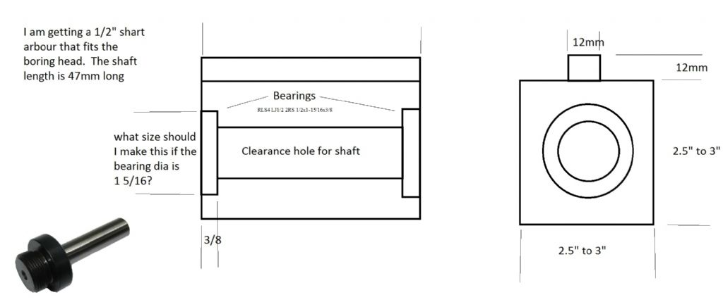

      Since I recently bought a boring head and seeing youtube videos of people using a boring head for turning radius and ball I thought I would make my own holder.
      This is my plan and would like any pointers please. I also would like to know whay size to bore the hole for the bearing so its a slight intereference fit
      Click on the drawing to make it bigger

        Thor 🇳🇴
          @thor
          I don't know what kind of bearing you intend to use, but I assume an Oilite bush should do the job. I have used such bushes in some of my projects, and make the hole for the bearing about 0.02mm under size.

            This is the bearings I am buying – **LINK**

              Here's a couple of links that may be of use:
              ***Link***
              ***Link***
              Or you can just use an adhesive.

                coulc i make this out of an aluminium billet or steel

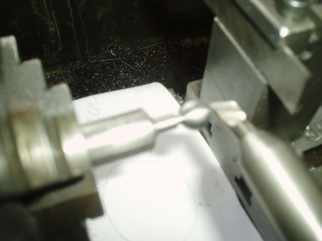

                  Hi Guys
                  Its a good idea' here is my one I maderadius turning

                    #294510
                    Nobby
                      @nobby
                      Hi
                      Only a close up of cutter shape not very clear ball turning
                      Edited By Nobby on 22/04/2017 17:57:34

                      Clive Foster
                        @clivefoster55965
                        I based mine on the design by Reed M Streifthau given in the second part of this link **LINK** .
                        I made the spindle with a female R8 taper so I could share the boring head with my Bridgeport. Didn't bother to invert the adjustment system so as to put it on top. Don't find it any great disadvantage with the adjuster on the bind side. No separate bearings. Just took care to get an accurate fit with really good finish on both bore and spindle.
                        A basic boring head is probably around 2" longer than the compact slide assembly used in most purpose built designs. So you need to pull the head as far back to the mount as possible. If the tool projects too far there won't be enough slide travel to bring the tip back onto centre line. Something to watch closely with smaller machines. I didn't pay special attention to this figuring there would be plenty of room a as my lathe is a 10" swing Smart & Brown 1024. although it fits fine there isn't a lot of excess slide travel, maybe 1/2". I figure a bit more attention to detail would have won another 1/4" to 3/8" and might well have been needful on a smaller machine. The pain shank carrier shown in the drawing on the first post can certainly be pulled back a bit further than my R8 spindle version. For smaller machines it may well be worth enlarging the body slightly so the flange on the shank assembly can be pulled back into a counterbore winning even more space.
                        Well worth the effort as it works just fine.
                        Clive.
