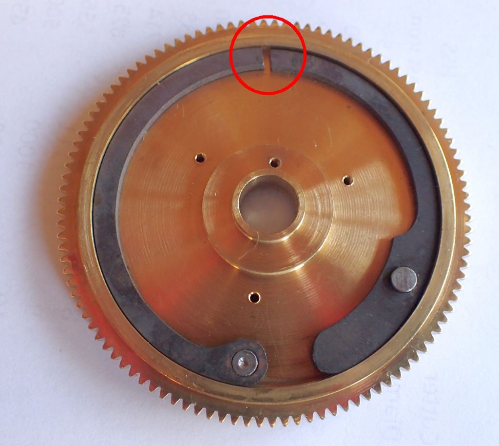

      I am still working on my Congreve. Having disassembled the fusee for cleaning, I discovered the maintaining power spring, has broken. It's a very strong spring!

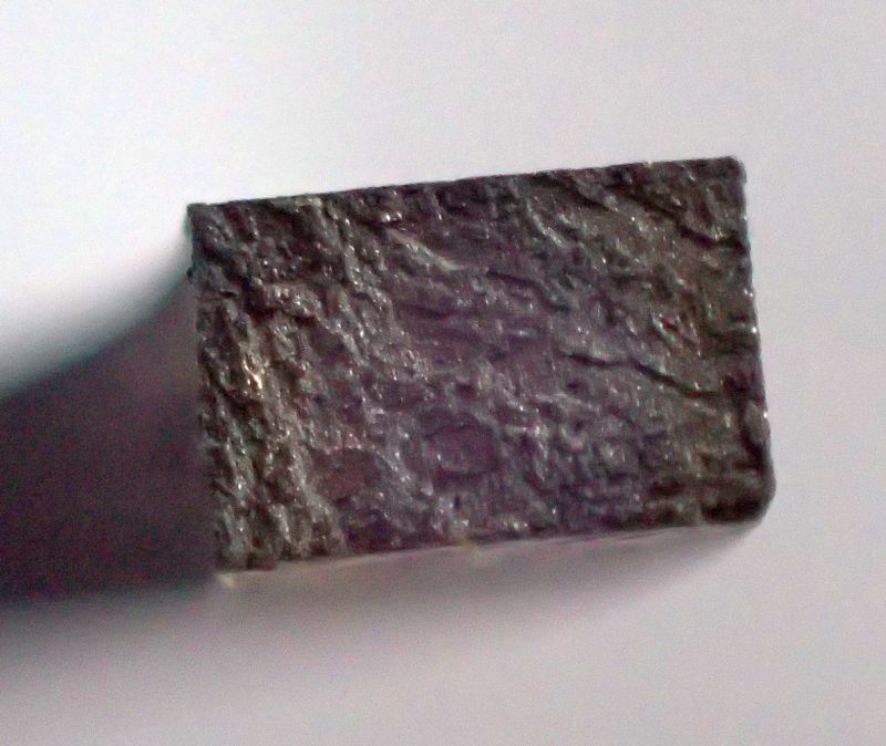

      My chances of sourcing a replacement are probably vanishingly small and I don't think any repair I could manage would be sufficiently strong. It appears to be steel (its magnetic), 1.8mm thick. The spring section is 2.75mm wide and the recess in the great wheel is 48mm in diameter and 2.5mm deep.
      The spring does not appear to be hardened – I can mark it with a file. Is it likely to be mild steel, or more likely to be some sort of spring steel? How can I tell?
      Does anyone have any suggestions as to how to make it, and suggestions as to what from. One idea being to cut it out of a steel disk on the mill. Will mild steel be a problem? The spring only gets flexed once a week when the clock is wound.

          Would it be possible to make one from a suitable size spring ring like used to retain bearings in housings. They are not hardened but can be filed?

            Thanks Clive, I had not considered a circlip as the basis. A 45mm circlip has an external (unsprung) diameter of 48.5mm which is close. I will go and see if the hole alignment can be made to work.

                I have made quite a few of these. I start with gauge plate of suitable thickness, cut a rough disc on the bandsaw, machine the inside and outside diameter on the lathe then finish on a rotary table on the milling machine followed by hand tools. Then harden, and temper to blue. Here is one I have just finished for a bracket clock project.
                I am guessing your spring was not tempered to the correct temperature?

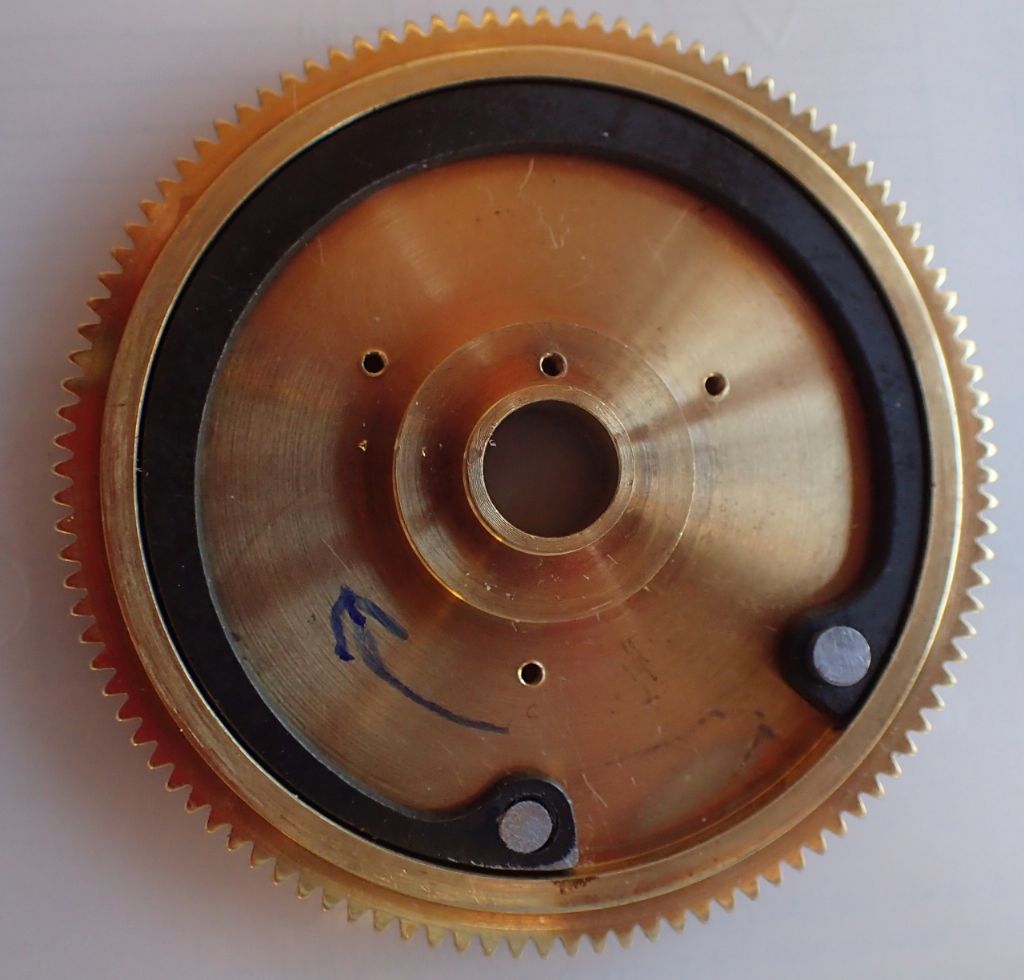

                  Just to report back, and in particular to thank Clive for the idea.
                  44mm nominal circlip arrived and has been fitted with the pins to make a replacement spring.
                  Seems fine, fits the inside of the wheel perfectly. Some quick math using an online beam calculator suggests it is not far off the original in stiffness. It will be tested when I get the clock back together.

                        Posted by lfoggy on 21/06/2022 07:15:38:
                        Great repair. Would never have thought of using a circlip. That spring though, it looks disproportionately stiff. Much bigger than a typical maintaining power spring. I guess the clock needs a lot of power to keep the tilting plate moving.
                        I didn't think of it, to give credit it was Clive Hartland's suggestion (post 2).
                        The replacement spring is definitely "stiff", however I have used an online beam calculator as a check. Treating the circlip and the original as simple cantilever beams where the length is the arc length of the thin parts in both cases, and using the true cross sections, it transpires that the circlip ( thicker but longer) has about 15% more deflection than the original for the same force.
