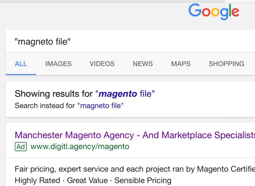

      Years back I remember cleaning the contacts of a large relay with a "magneto file". A flat file about 6" long including the handle which was integral with the blade – both being formed from a single piece of metal.
      Recently while examining some burnt relay contacts I was reminded of the file and wondered if such a thing actually existed or if it was just my memory playing tricks.
      A google such was surprisingly unhelpful. Only two hits on an actual tool, one from RS components (now listed as discontinued) and another from an Australian company called Boker. There were however dozens of hits on a comic-book character named Magneto
      I find it somewhat depressing that a piece of engineering equipment, probably around from the dawn of flight, can be so quickly displaced by an element of common culture that I hadn't even heard of.
      I was wondering if these tools perhaps had another name, or if they were just not widely known?

                                #292009
                                  Posted by clivel on 03/04/2017 21:15:40:
                                  Clive,
                                  Beware Google's nasty habit of replacing what you typed with what it "knows" you meant.
                                  You sometimes need to tell it who's Boss !!
                                  P.S. [just for completeness] A Magnetophile is someone who loves Magnetos devil
