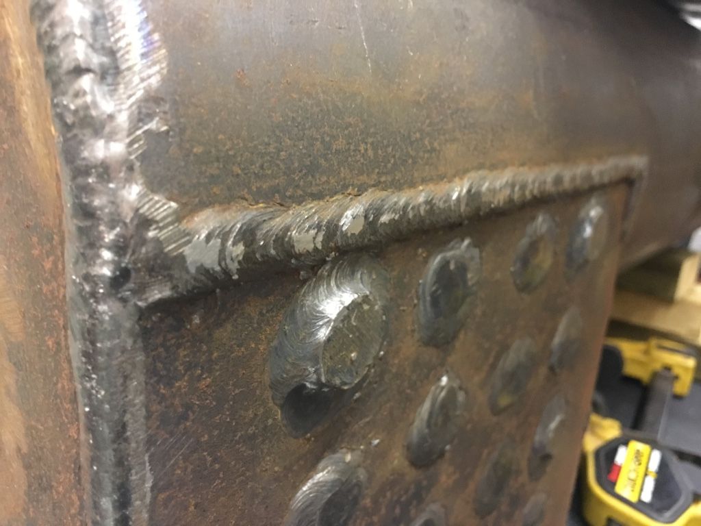

        Hi all,
        I am currently building a 4" scale traction engine for which I have purchased a professionally built steel boiler. The horn plates are to be bolted to the sides of the firebox into six of the stays on either side of the firebox. These stays have to be machined so that on either side they hold the horn plates approx 0.094" away from the firebox on each side, apparently to allow a small air gap to prevent the horn plates from becoming too hot during operation. The problem I have is that if I machine the stays to give the correct horn plate separation distance then the horn plates will be fouling the weld fillets on either side of the top of the outer firebox sides. My question is, can I machine the weld fillets down so they are flush with the outer edge of the boiler tube/firebox plate joint without compromising the structural integrity of the boiler or invalidating any future boiler test that will be required? Hopefully the photo will show the weld fillet in question which you can see is currently standing quite proud of the two plates that it is joining.
        Regards Martin.

          What model are you building? I would check all the measurements first. The gap is usually because the boiler is smaller than the distance between the horn plates. I wouldn't machine the welds without checking with your boiler inspector first.

            Martin, why not leave the stays a little bit longer so the hornplates are slightly wider apart and clear the weld bead. Then you need to increase the length of all the shafts and spectacle plates by the difference, everything outside the frames will stay the same. From the picture it does not look as if you would need to add much.

              I had considered your option but unfortunately at least 2 of the stays are already lower than the protrusion of the weld fillet even before machining them all to the same distance from the firebox side plate. It would seem my only option if I can't skim the weld fillets is to skim the stays so they are all equal length then fit suitable sized washers between stays and horn plates to provide enough offset for the horn plates to clear the weld fillets.

                Took me ages to sand the stays flat. I made a parallel template the same size as the horns and kept trying it over until it was a good fit.
                Took time but worked out well.

                  the answer is yes. use a flapper wheel 80 grit to flatten them quickly. they add no strength to the weld (which happen to look ruddy awful) and so can be rermoved. I build steel boilers, was coded for many years, and I flatten all my boiler welds. And how many stays….massive overkill, but safer all the same.

                    Not sure what your code requirements are but ours in Australia requires that the stays protrude by 3mm. Best to ask your inspector before yo do anything.

                      The hump on the weld adds nothing to its strength at all, it is only there to prevent undercutting of the plate thickness. in actual fact it reduces its strength by creating !stress raising changes of thickness, ie a weak spot along the joint. If a load is applied the material will move, and the the increased thickness will move less,This will induce stress at the junction of the weld where the thickness changes.If this is a professionally built boiler, I would send it back. What are they professional at? decorating!

                        Is that a hole at the T intersection ? That would be a big stress raiser. I agree that the raised weld does nothing for the strength, but this is model work and has to be passed by an inspector, so ask him before doing anything.

                          Likewise. Although an interesting comment regarding a thicker weld fillet possibly making the joint weaker, I'm not sure that the 120 psi working pressure of the boiler is going to cause any significant movement in the (heavily stayed) 10mm thick boiler plates. I'm also interested as to why you think the boiler should be returned to the manufacturer, do you consider it unsafe/unfit for purpose? The paperwork that accompanied the boiler confirms that the boiler has been inspected at various stages of construction and has successfully passed a 2 x working pressure hydraulic test.

                            You have said that "the boiler has already been inspected at various stages of construction". Why not ask the manufacturer if it is OK to grind back the welds. Get their answer in writing because if it is not acceptable to their inspector, their paperwork may become null and void.

                                    in fullsize loco boiler repairs the welds are always ground back to the plate. i dont see any reason not to apply the same procedure, and i cannot think of any sensible club boiler inspector disagreeing with this procedure. i totally agree with fizzy in this respect.
