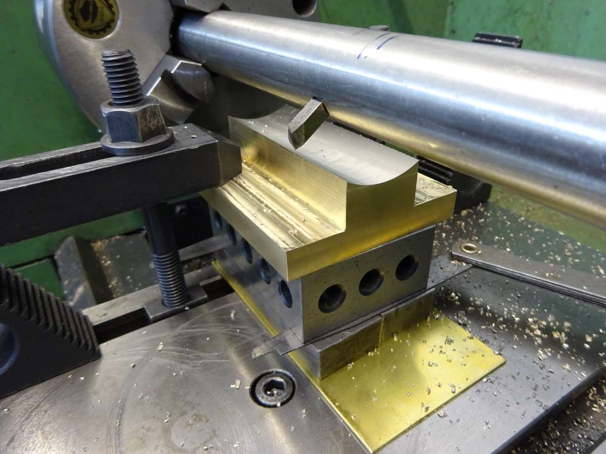

          #839221
          Charles Lamont
            @charleslamont71117
            I Googled for you. Here is a video: https://www.facebook.com/groups/714729802615009/posts/799517497469572/ and a photo:
            #839233
            Greensands
              @greensands
              Close inspection of the above photo  indicates that the saddle casting has been soft soldered to a temporary base plate to enable it to be bolted through to the vertical slide, an arrangement which I think answers my question.
              #839235
              Nigel Graham 2
                @nigelgraham2
                I assume the abrasive techique means the casting is already close to size, but I would fear that cleaning every last grain of abrasive from the machine afterwards could be something of a challenge.
                Looking at the photograph I wonder if the saddle casting, on its temporary base-plate, could be bolted to the cross-slide instead of the vertical slide, with a base of appropriate height. It would be a more rigid set-up.

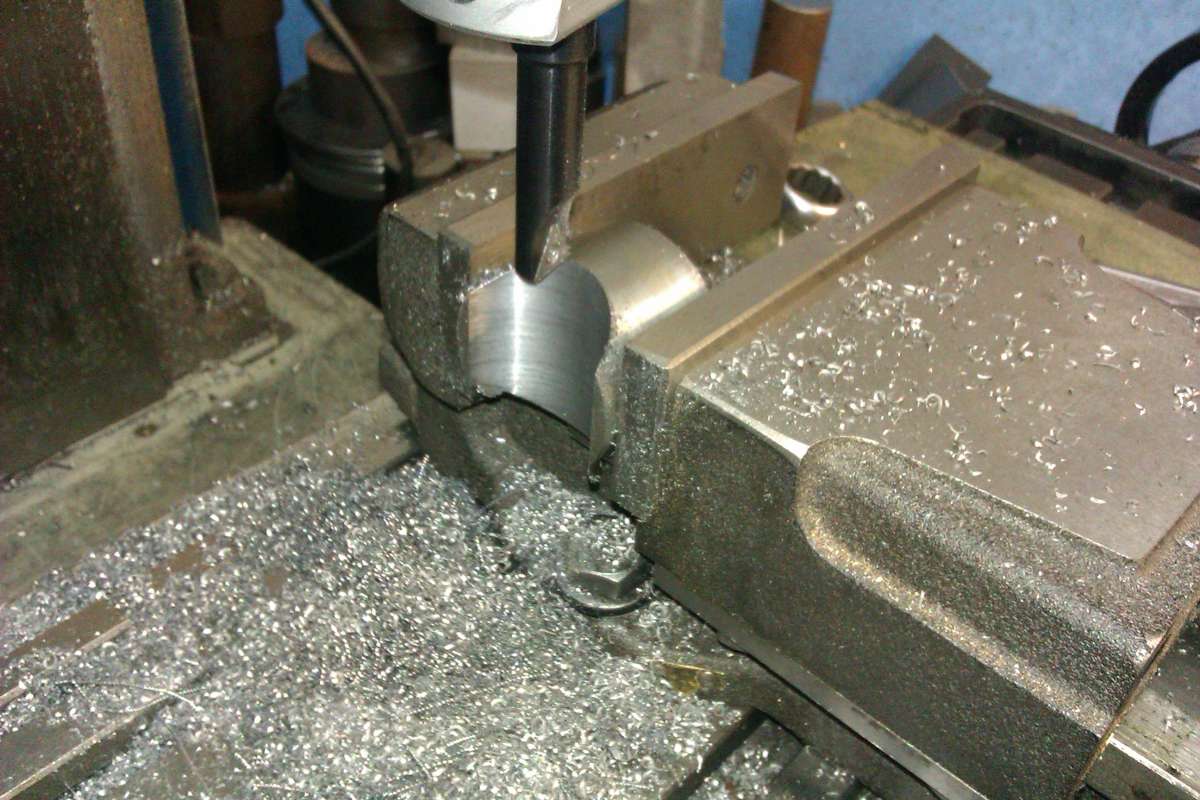

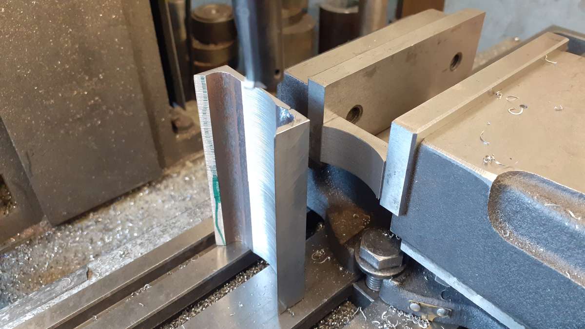

                #839248
                  You don’t use any machines if just rubbing the part on abrasive wrapped round the smokebos so how will it get on your machines
                  I do feel that when most of the books and articles about machining parts like this they were mased on most home workshops only haveing a lathe. Now I don’t make Locos but I often have the need to machine a concave surface and my machine of choice is the MILL. Simple to then mill the ends.
                  Set a boring head to the required radius though a flycutter could also be used with a suitable cutter. Then hold your work vertically either in the vice or fixed to an angle plate and us eX axis to put on a Cut and Z axis to feed. Initial roughing cuts with the quill by hand final pass lowering the head or raising the knee.
                  20231015_090126
                  IMAG3220
                  Lathe method is really no different to boring a hole except you are only doing part of it. I prefer to set the work on the cross slide as it is mor erigid, using packing to get it to height. Then just use a between ctrs bar. If you slip your smokebox tube over the tailstock ctr before you start then easy to stop the lathe and test the fit. Edges can be done with a side cutting tool in the between ctrs bar or a flycutter.
                  Tid112

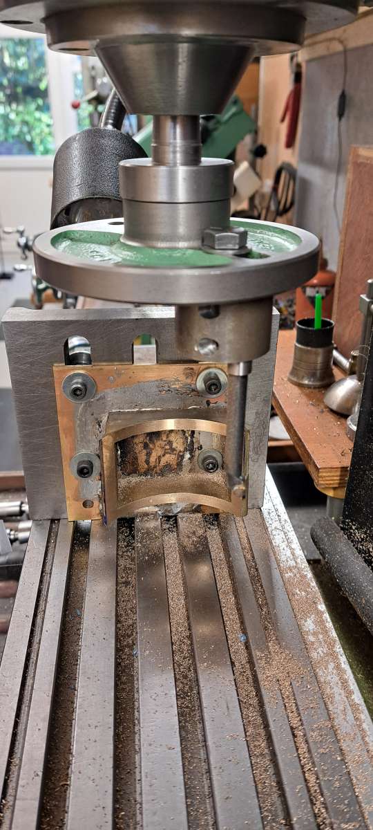

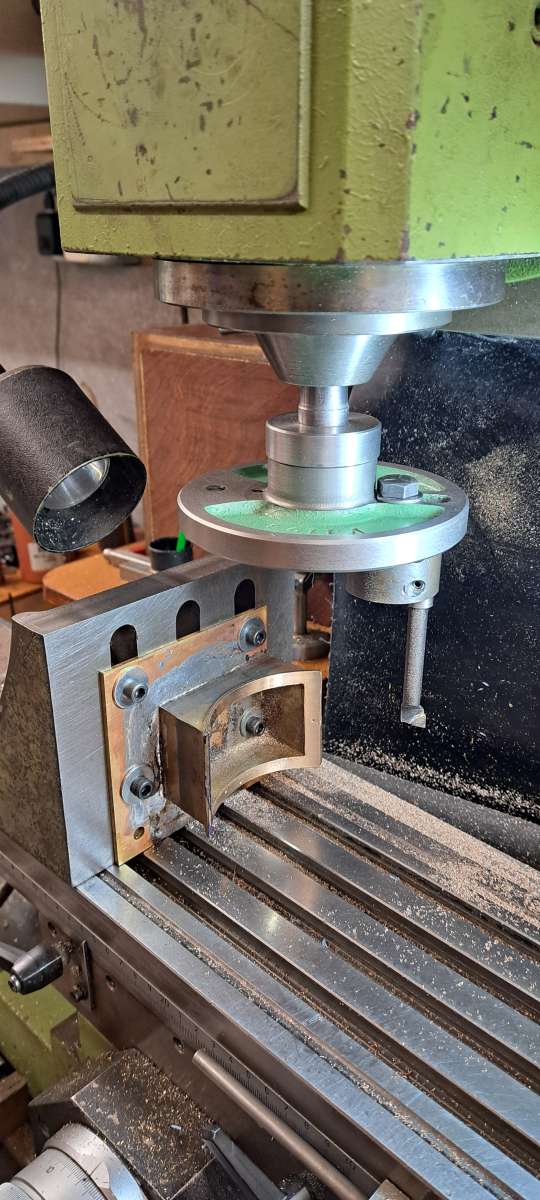

                    #840091
                    Greensands
                      @greensands
                      I have attached a couple of pics showing my final solution to machining the smokebox saddle after making a false start using the vertical slide mounted on the Myford. Depth of cut had to be limited to 5thou but I was quite happy with the end result.
                      #840093
                      Greensands
                        @greensands
                        20260303_15574420260303_155722
                        #840095
                        Greensands
                          @greensands
                          The issue with using the vertical slide on the lathe turned out to be insufficient travel available on the cross slide for the required radius of cut owing to the space taken up by the vertical slide.
