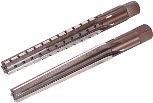

      Looking for an alternative approach I came across these reamers:
      The top one is 'roughing' and the other finishing. But I don't know how they are meant to be used. Could I get away with step drilling or boring, then use the rougher to take off the corners and finish with the other? They are cheap Oriental offerings made from carbon, not HS, steel, but it's a one-off in EN1A so maybe it could work.
      Has anyone used these tools and can advise? Or any suggestions for other methods?

          Robin
          i make a few mt 2 sockets and use just the finishing one
          i drill down the smaller diameter and then perhaps halfway with the middle diameter.
          hold the reamer in the drill chuck and at perhaps 500 rpm advance the reamer and cut just a couple of mm
          retract and clean the flutes apply cutting oil liberally and repeat until its cutting all it length.

                We use these at work to produce 4MT holes in graphite components & used similar form taper pin reamers at my previous employment.
                Just drilled a bit larger than the small end diameter of the roughing reamer to start. The roughing reamer requires retracting frequently to clear chip build up & we used Rocol RTD liquid as a lubricant for the taper pin reamers into steel or CI (dry for graphite). Leave a small amount to clean up to size with the finishing reamer.
                My recollection of using the taper pin reamers is that the rougher took a suprisingly long time to clear out the hole before a few turns of the finisher get a good finish. IIRC we used a magnetic base drill to both drill and rough ream, then finished by hand.
                The graphite components were produced on a vertical machining centre & were only around 40mm thick, so were quite quick to machine – still needed to retract the roughing reamer frequently to clear the flutes & prevent clogging. Graphite is abrasive though & the HSS reamers needed sending out for regrinding after every batch of components.

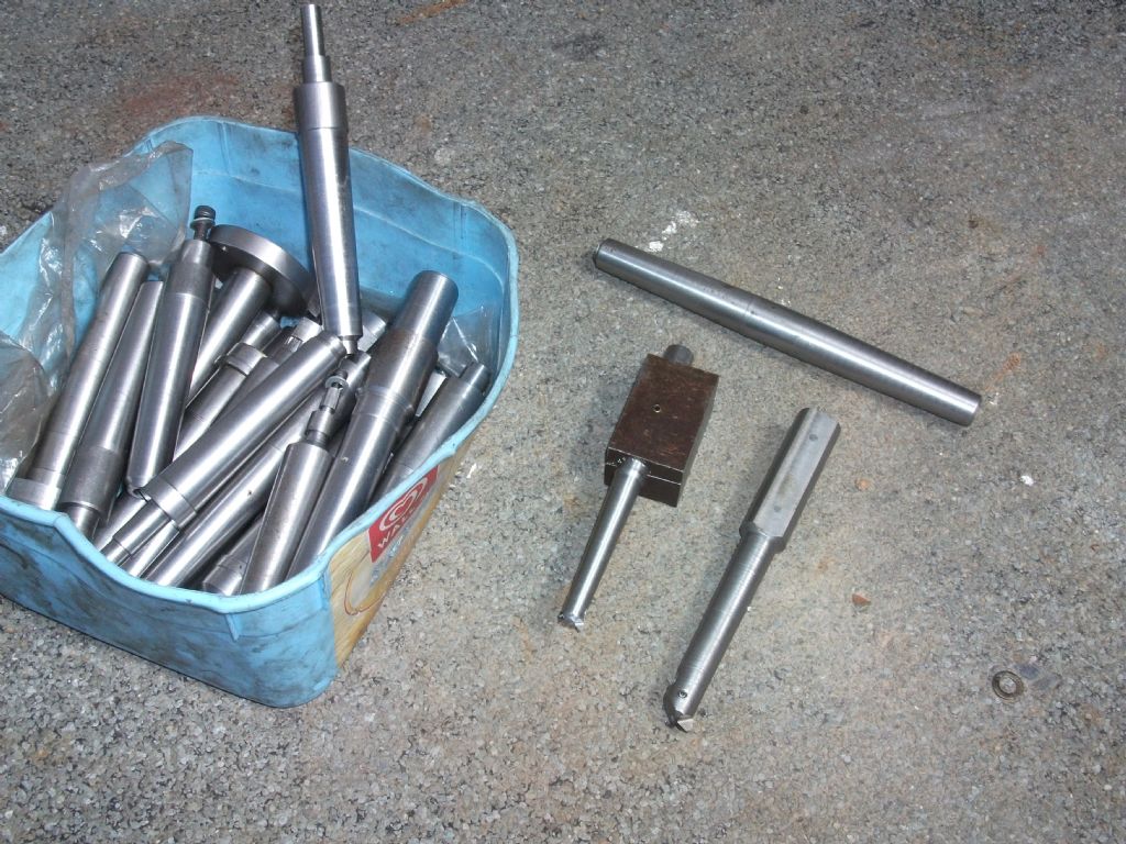

                    Hi,
                    The two things that are important when making an internal morse taper are the
                    fit of the the taper and the axial alignment within the spindle ,step drilling
                    or boring and then reaming is less likely for this to be so .It is a simple

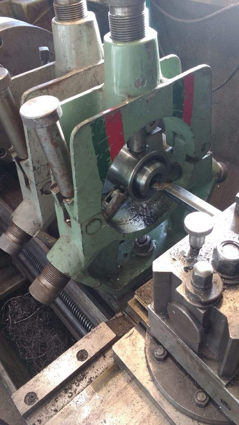

                    job to make a solid boring bar to cut these tapers ,the 2 here in the photo
                    are made just as morse taper for making 1 and 2 morse tapers but
                    undersize to allow the toolbit to protrude ,as such the boring bar will
                    be strong enough to not deflect and small enough to clear the small end.
                    When making these sort of spindles i find it easier to do the morse taper first
                    and use a double ended morse taper arbor and mount the job on this to cut
                    the outside parts of the spindle.

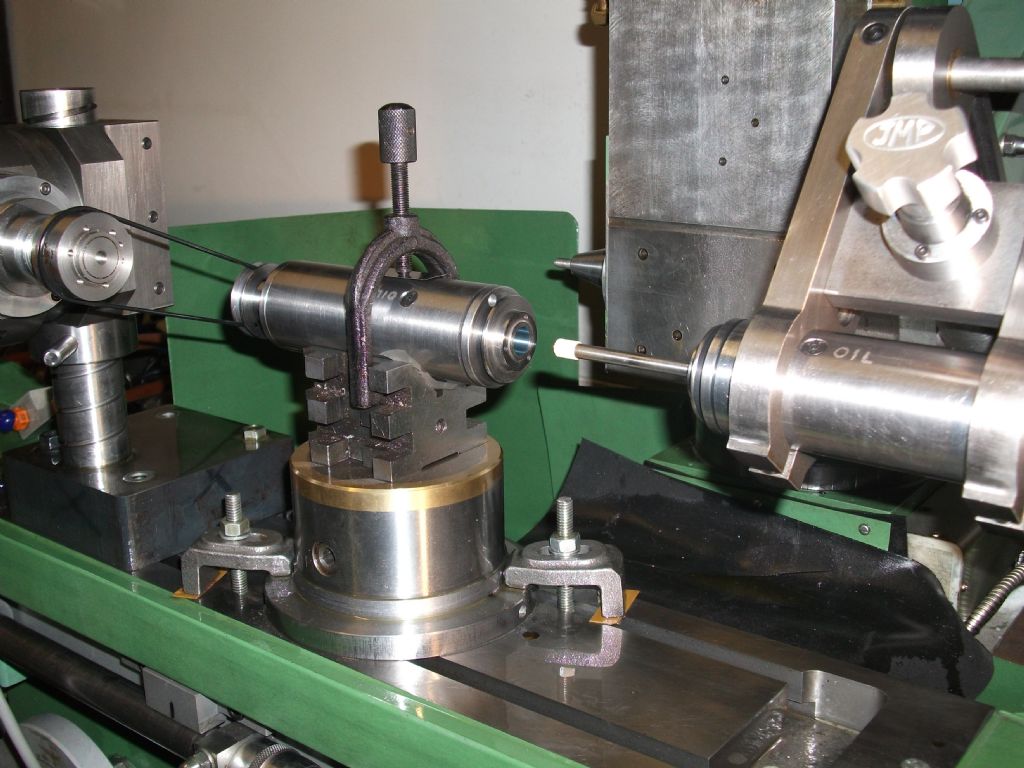

                    These days i leave enough in the taper to finish grind the taper mounted in
                    the spindle bearings , just because i can, seen here in the photo grinding
                    a 1 morse taper , the last 2 mt one that i had done was better than the
                    Myford 7 spindle nose and they are pretty good in any case.

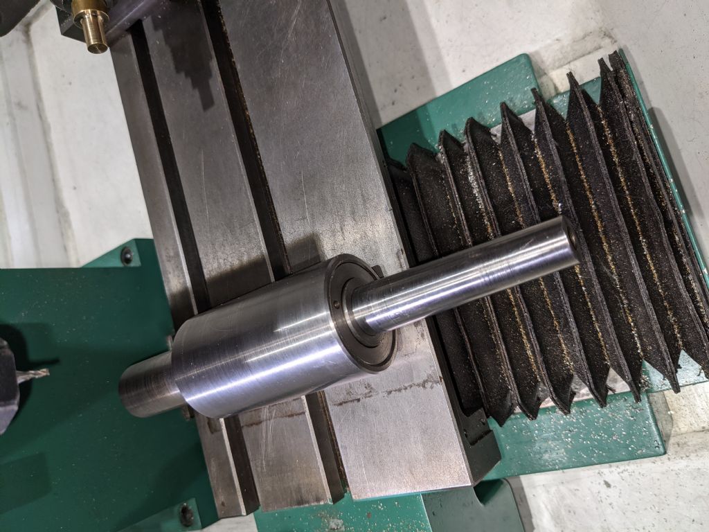

                      Couple of photos I posted that may be helpful when you've made the socket and want to turn the outside concentric. I wanted to make an MT2 ball bearing spindle and had a bit of bar with a socket already cut. So I made a double-ended MT2 arbor, shown to the right. on the left is the complete spindle with an M2 blank end arbor in the socket.
                      When it comes to turning the spindle I put one end of the arbor in the headstock with a drawbar and the taper in the spindle on the other end with another drawbar.
                      Then I could carefully turn the spindle OD concentric with the socket. If your spindle isn't too long you might do something similar?

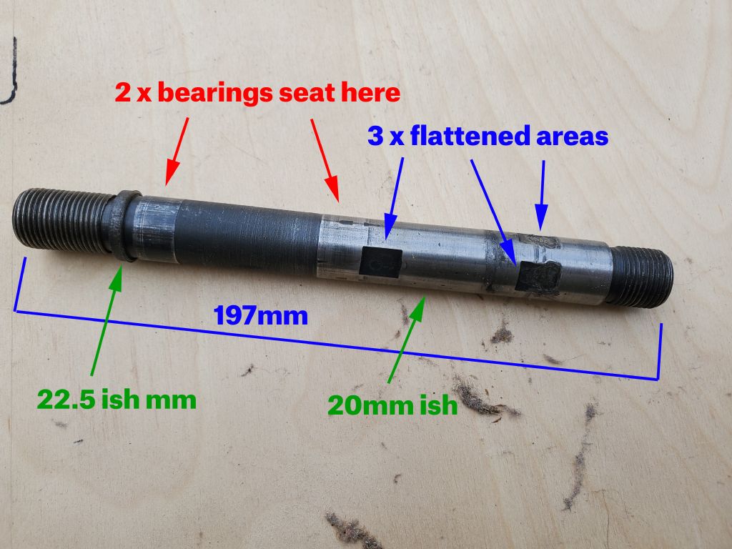

                        This is the spindle I want to reproduce:
                        The internal 1MT taper is on the left – the rest of the spindle is solid. My thinkings so far, based on the kit
                        I have are:
                        1. Mount an oversized bar between centres, turn the external features then remount on-axis in the 4-jaw to make the taper.
                        2. Make the taper first in oversized bar, put a small 60 degree chamfer at the end, mount between centres and then do the external features.
                        3. Make the taper in oversize bar first, bung in a 1MT soft arbor and rely on the centre hole in the soft end of the arbor to turn the external features between centres.
                        4. None of the above sad
                        It's for a wood turning lathe, so a couple of thou out isn't going to be a problem, but I want to get it as accurate as I possibly can – I took the job on for a small, but negative, financial gain as a way of advancing my skills and doing someone else a bit of good.
                        Robin.

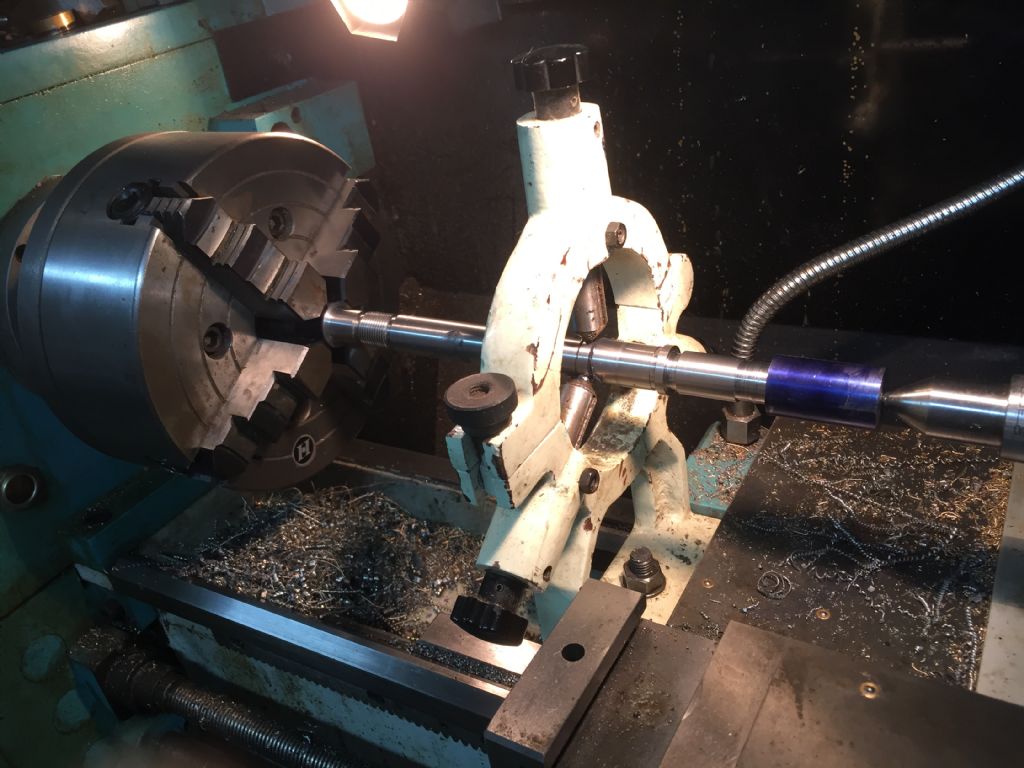

                          #544922
                          John P
                            @johnp77052
                            Hi Robin,
                            Seeing your last post , this illustration may be of some use it is not
                            often seen now days but is a viable method to retain some concentricity.
                            They show this here as you have described reaming the internal morse
                            taper ,i would have thought that it would be wise at least to pre bore the
                            hole to as near morse taper form before using the reamer.
                            The sequence is much the same as you have described except for
                            the mounting in a 4 jaw chuck.
                            The set up is to turn between centres ,fit and adjust the fixed steady
                            whilst still held on centres,remove the tailstock away ,retain the
                            part on the headstock centre with the spring dog.
                            When you say the shaft is solid,is there no through hole ,if so how
                            do you eject the centre?

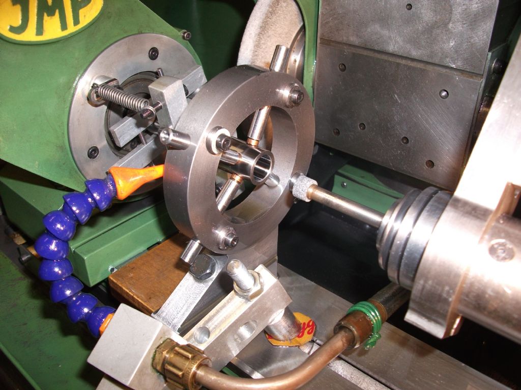

                                    Hi Robin,
                                    I've copied the whole of the illustration here and it shows the complete
                                    sequence of operations , these copies come from a re-print of a book
                                    from the 1920's and as such the working methods reflect that era , much
                                    of this is still relevant in home workshops today ,with that in mind the shaft
                                    depicted would most likely be hardened to run in plain bushings and need grinding ,the second
                                    print here shows a similar shaft set up to have the internal taper ground using
                                    this time belt lace to hold the shaft against the headstock centre.
                                    The third photo here shows a similar set up using a sprung dog holding
                                    the shaft on the headstock centre ,just for reference the springs have
                                    about 15 to 20 lbs tension in each one.
                                    No universal grinding machine about the only chance these day of owning
                                    such a thing is to build it yourself ,unless you are lucky to find an old one
                                    to restore ,don't think they are made these days.

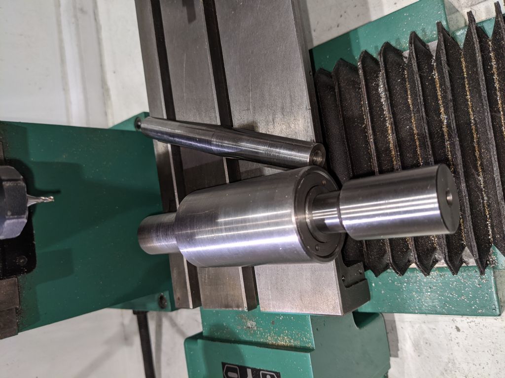

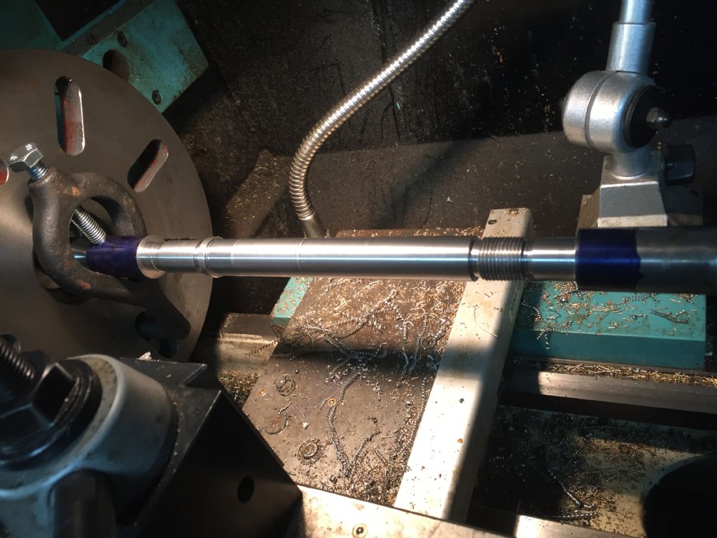

                                      #547740
                                      Robin Graham
                                        @robingraham42208

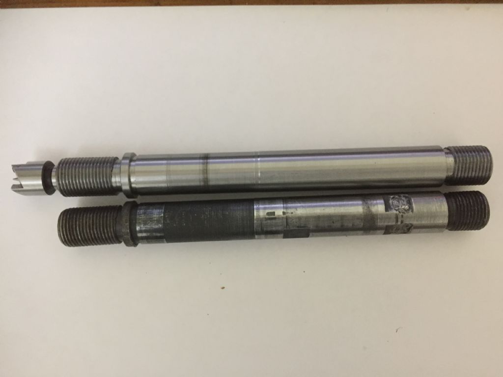

                                        Just to wind up with how it went. The repair didn't work (the spindle was too badly bent) so I reverted to plan A.
                                        I set up to turn between centres:
                                        and turned the outboard LH thread and other external features. I was pretty happy to find that (according to my Sunday Best Mtitutoyo mic) the parallel section was indeed parallel to 0.002mm over 100mm.
                                        Because I had no easy way of doing the spring-loaded dog thing, I turned the work round, set it in the 4-jaw and centered on the bearing seats by fiddling with the chuck and the steady arms:
                                        I then parted off the stub at the tailstock end (yes, I did take the tailstock off before finishing the cut), drilled, bored and reamed the internal taper and cut the RH thread with this setup.
                                        The finished spindle:
                                        has ~ 0.01mm TIR on the internal taper with respect the the bearing seats. OK, not great but not too bad.
                                        I nearly had a heart attack when I spun up the (commercial) drive centre and saw the spur point wobbling visibly – but it turned out the commercial part was at fault. I guess it really doesn't matter so much with woodturning,
                                        Many thanks for advice – I've learned a lot from this project, simple as it may seem to many of you.
                                        Robin.
