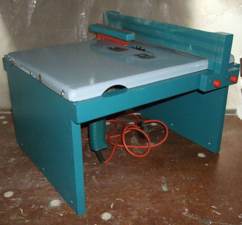

                  I did find the current topic a little worrying, as my last completed project was what to do with a 1970's vintage Black and Decker electric drill.

                              Posted by Ron Colvin on 05/04/2019 17:19:38:
                              I'd say a B for effort, but not compliant. The big problem is there appears to be on no-volt release (start/stop buttons) or emergency stop (or any other means of turning it on or off except at the socket or reaching under the table).
                              At very least put a switch on the table.
                              Robert G8RPI
