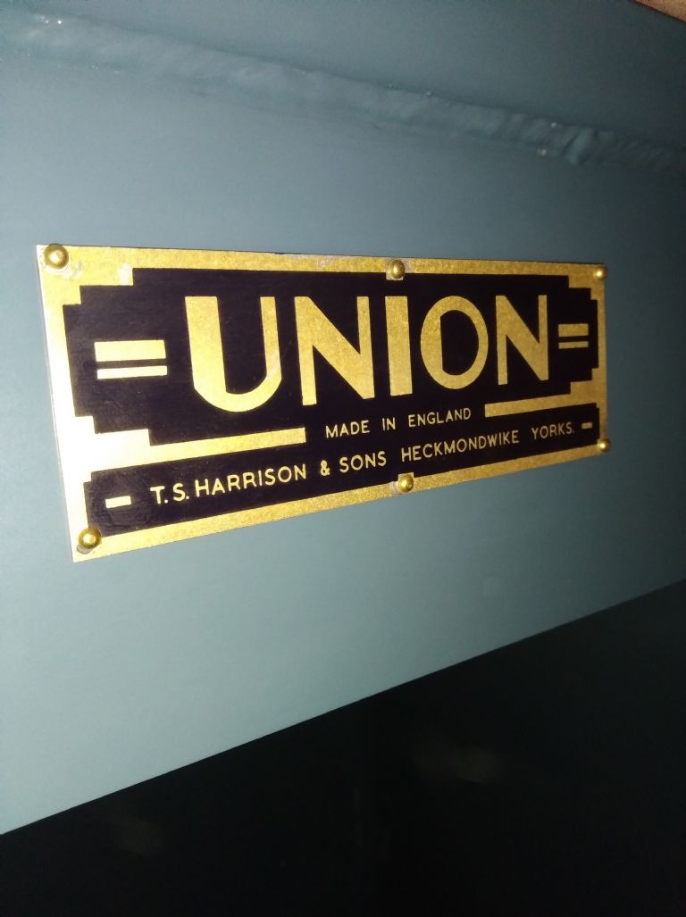

      HI, Does anyone know the correct term for the rivet headed, knock in fixings used to hold the ident and data plates on machines.
      And, where I can get them from.
      Regards. Steve Harris

        #627747
          Drive Screw or hammer drive screw

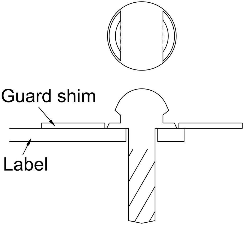

                    Macolm
                      @macolm
                      I have used a slotted wood chisel (under the label), and damage still seems unavoidable. To extract these quick thread drive pins, they need pulled out along the thread orientation.
                      I haven’t tried this, and have no intention of doing so, but I suggest using a Dremel or similar to cut slots per the attached. Anyone skilled in micro-surgery should find this easy. Then use strong end cutters to grip, rotate and pull. You may need to modify suitable end cutters by grinding them flat across the face so as that the gripping/cutting edge is outermost.

                                  The problem is that in many examples, the “thread” helix angle is too steep to allow unscrewing by a pure rotary torque. It jams instead because the component of force generated along the helix direction is less than the friction caused by the torque. Thus some added axial extraction force is needed. If the head is domed without a parallel diameter, this is difficult to apply.

                                          Hi. My original question was due to me taking the data plate off the headstock of my CZ motocross machine prior to having it powder coated. I was able to get behind the fixings and lever them part way out with a bar. Then an old wood chisel under the head.
                                          I will NOT now attempt the data plate on my Colchester lathe when I refurbish it, after reading the comments above, it's too risky.
                                          Well, it certainly provoked some comments and thanks to everyone who joined in.
