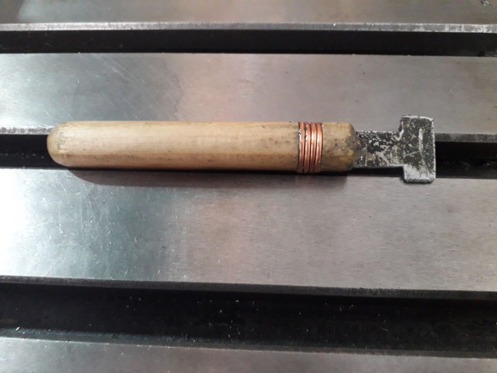

                                  Probably the most useful and cost effective tools for the mill is one of these Roger!
                                  #472532
                                  not done it yet
                                    @notdoneityet
                                    Posted by Henry Brown on 17/05/2020 20:57:46:
                                    And exactly how much did that useful little tool cost you? Looks really expensive.🙂 Mine don’t even have a wooden handle (although it may make finding them easier).🙂
                                    The OP might even consider a set-up (like doubleboost’s?) to make them – or just order one from him?
                                      Nicely done, Henry
                                      … That makes my old toothbrush look rather shabby blush
