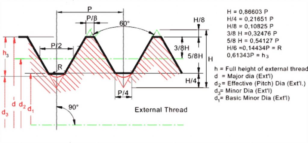

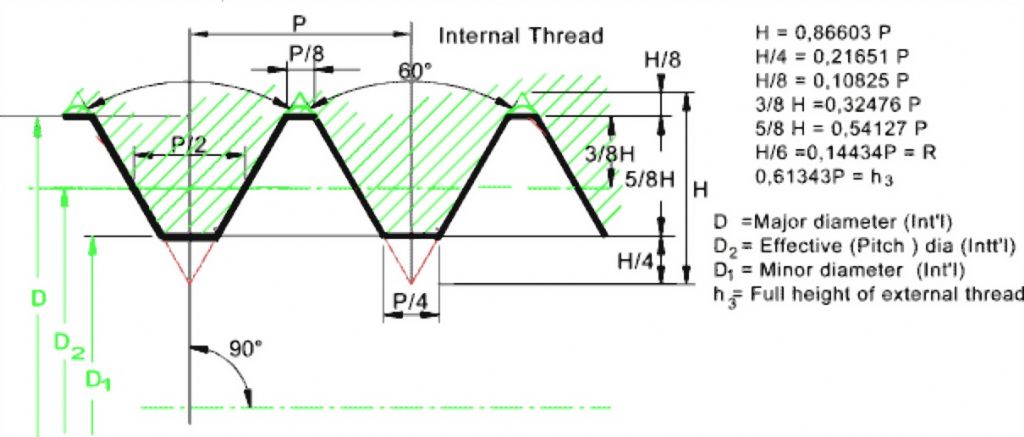

              I think that tap dia minus the pitch and plus a bit more is the safest option. When it gets up to M8 though they are pretty strong taps so the usual minus pitch should be ok but there is usually some variation in actual tap diameter these days. Or I can't buy taps as good as the ones I used at work which were smack on size.
              The standards I can find are odd in some ways. May be root rads etc may not be.
              ISO Internal
              ISO External
              Rad's according to DIN
              dont know Cutting tools usually have rads – Whitworth wasn't mad. There may be standards for rolled threads somewhere. Hard to see them having any sharp corners.

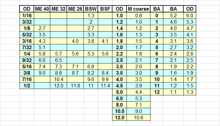

                This is the table I've put together based (mostly) on 60-70% engagement using my set of 0.1mm spaced drills
                For clearance, I take a view depending on the application, based on the OD which, apart from BA, is the nominal OD not the actual thread OD. E&OE

                  I really cant see why everyone is making tables or working out engagement for standard tapping drills – especially for metric…. why are you all using custom drill sizes?
                  As stated earlier, metric M8 is M8x1.25 (I design/draw for a living and we never put the pitch on unless it is non standard – m8x1.0 etc). This is what prompted me to ask what pitch was being used.
                  In industry, we use the standard published tapping drill size unless there is a special reason otherwise and use a minimum thread engagement of 1.5 times the thread diameter – 12mm in the case of M8.

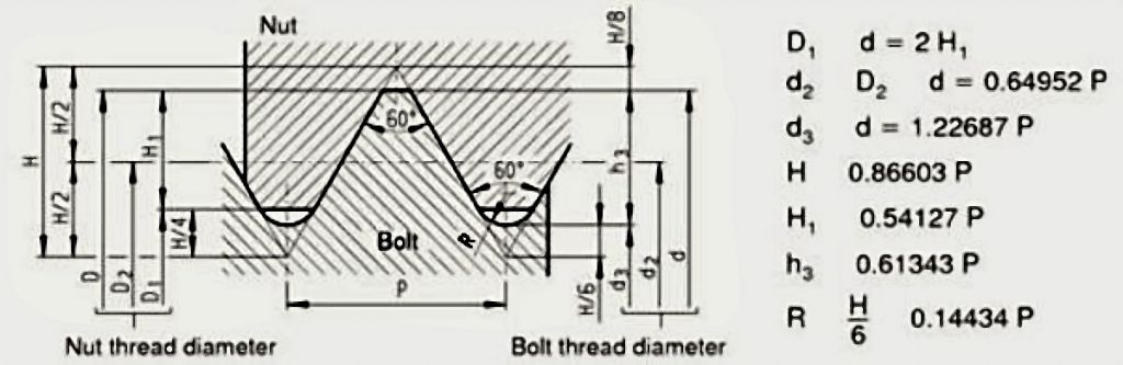

                          Strange limit on thread engagement to me Mark. I grew up in a TDO and the limit was min 1 dia and if over 1.5 they were trimmed down.
                          The reason for this is pitch tolerance. No gain past this max engagement limit and that is on precision screws too.
                          This is essentially how nut thickness's are derived. For example see
                          **LINK**
                          I have seen thicker nuts but only in unusual circumstance – angry One in particular springs to mind. Big end bolts on a car I used to own. Nuts and bolts had to be replaced once undone. No stock so had to use them and one sheared bending a massive crankshaft and breaking the block. They can be seen in other places too but much over 1 dia is rather unusual.
                          On diameters when ever I measure a tap I have bought it's over size probably within H6 tolerance. At work they were all ground thread and on size. My impression is that they are generally now made mid tolerance like many other precision hole makers.
