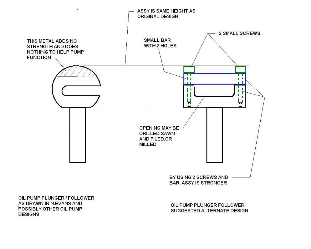

                            Hi Andrew,
                            One other thing about the pump design drawn in several of Neville Evans' loco series. The plunger/follower design did not make sense to me as it was drawn. It may have been carried over from the Ewins design, I'm not sure. Anyway my sketch below shows a possible alternate way to make it that may be stronger and be easier for assembly and disassembly. I also agree 100% that better support of the drive shaft at both ends would be a good idea. One caution re the suggestion to clean these clutches with paraffin etc – fine if the internal roller springs are metal but many small roller clutches now have polymer springs – these should not be cleaned with any mineral solvent.
                            oil pump plunger alt design

                              Thanks to everybody for the contributions. I have got the lubricator working after a fashion by increasing the driven angle on the lubricator. In the light of all the comments I may do a rethink on the design once the Loco is running and I can see what's happening in steady state running conditions.
