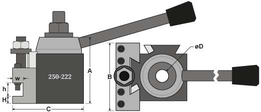

          Been doing some more measuring.
          I have attached a tool holder with a 12mm tool. Made sure the tip is centered.
          Looking at the diagram of the wedge
          My tool holder size H=8.5mm. The gap from the bottom of the tool holder to the cross slide is 6mm. Total 14.5mm
          On the 222 H=12.5. so a couple mm spare
          Does that make sence?
          The problem with the 111 is it only takes 14mm tools and I have a couple of 16mm boring bars
          Edited By petro1head on 06/01/2020 11:11:17

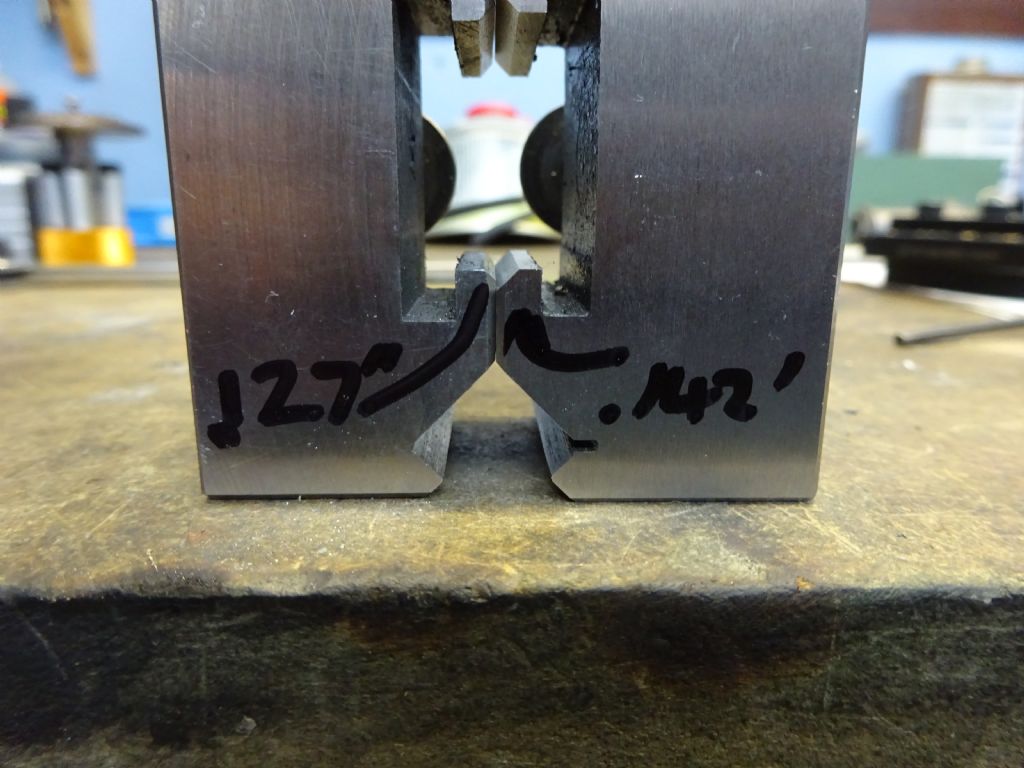

                      As Clive says it is usually the Tee slot that gives the problems. I posted this photo a while ago where you can see the difference in thickness between the genuine article on the left and another make on the right which stops the cam turning far enough. Cured by sacrificing a woodruff cutter.
                      The other problem area is where I have the two holders touching in the photo some make contact here first which means the angled faces are not tightly together, this can be cured quite quickly with a linisher or belt sander, milling with carbide should also remove the offending material.

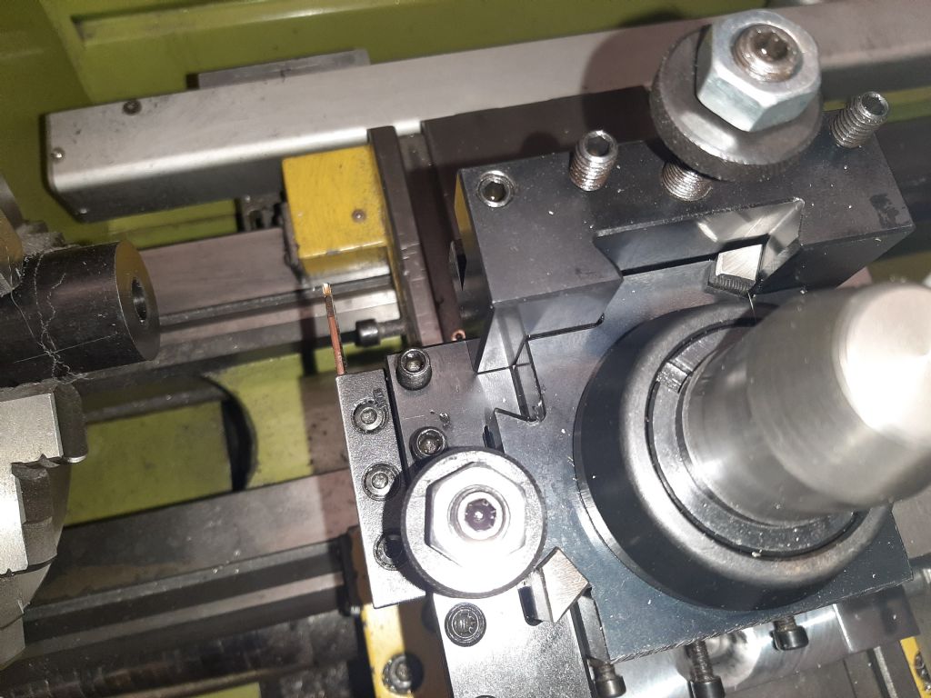

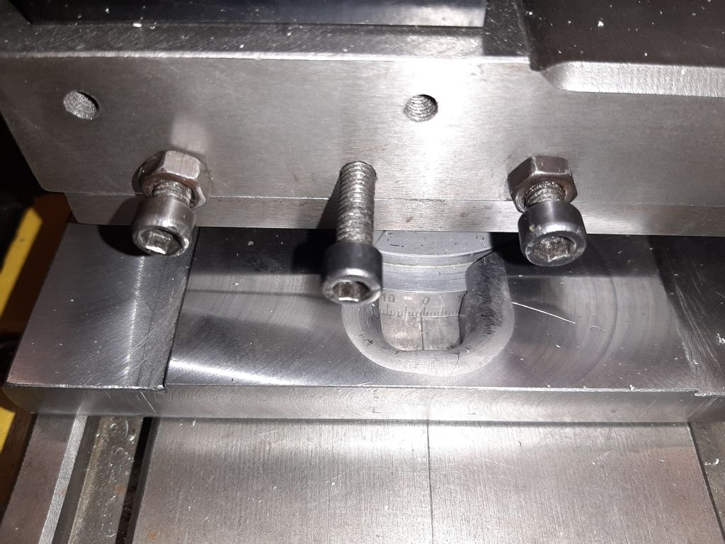

                                Update
                                First, thanks for all the input guys.  This forum and its members are great
                                Got the 222 wedge tool post from Arc yesterday. Fits fine, however ever thought it got two postitions for tool holders only one will fit at a time as trying two one fowls on the other. Aaprt from that very please and soo smooth.
                                Post to hold the tool post and I have also made a new clamping plate similar to the one John made.
                                One thing I did notice and hve corrected was the fact the face of the cross slide was not true so have done some machining to true up. This has given me another couple of mm to play with.
                                Will get some photos posted once my back stops hurting
                                Edited By petro1head on 10/01/2020 14:46:01

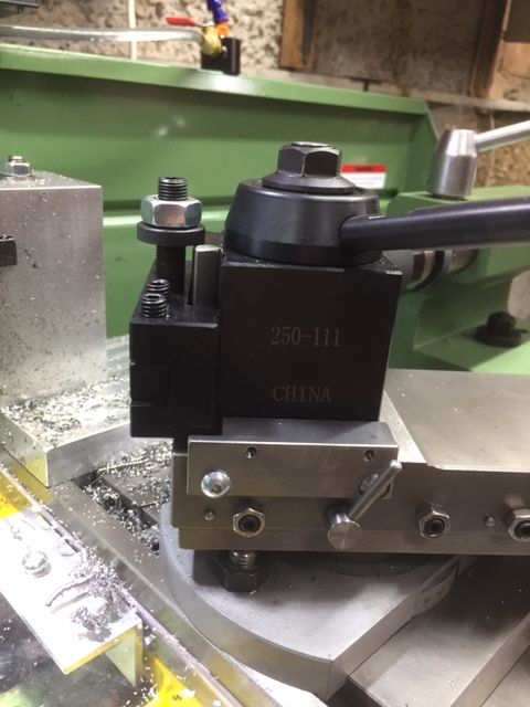

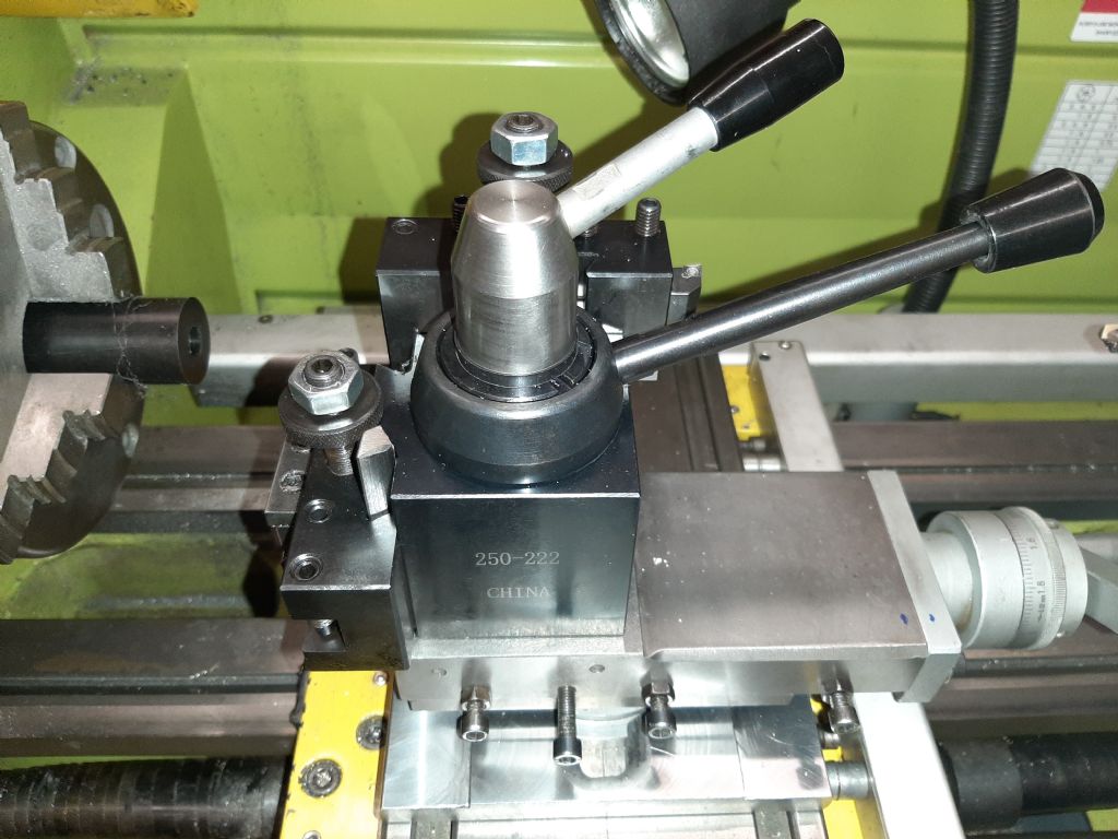

                                      Hi Craig, just sent 2 PM's, I am very happy with my 250-111 size tool post see picture. I took off the solid top slide I had made as per Stefan Gotteswinter & remachined the Warco top slide, much more versatile & rigid enough for big cuts.
                                      Tony

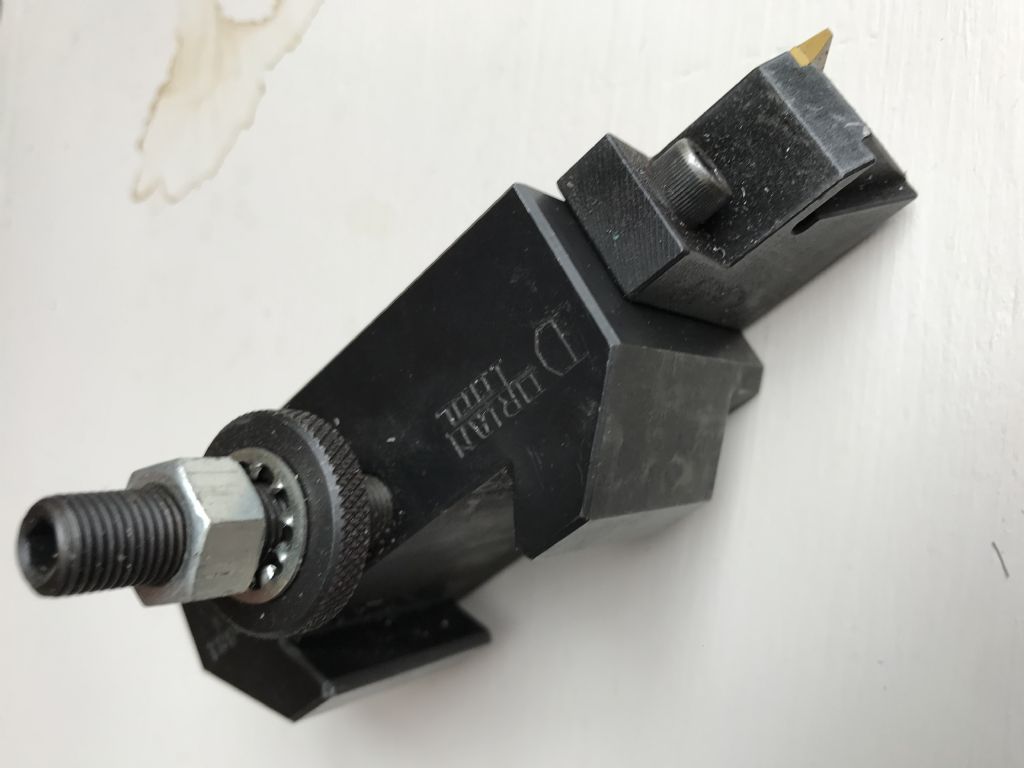

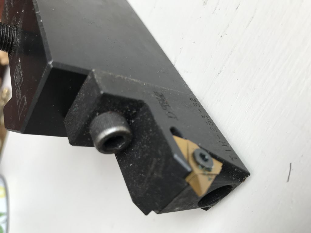

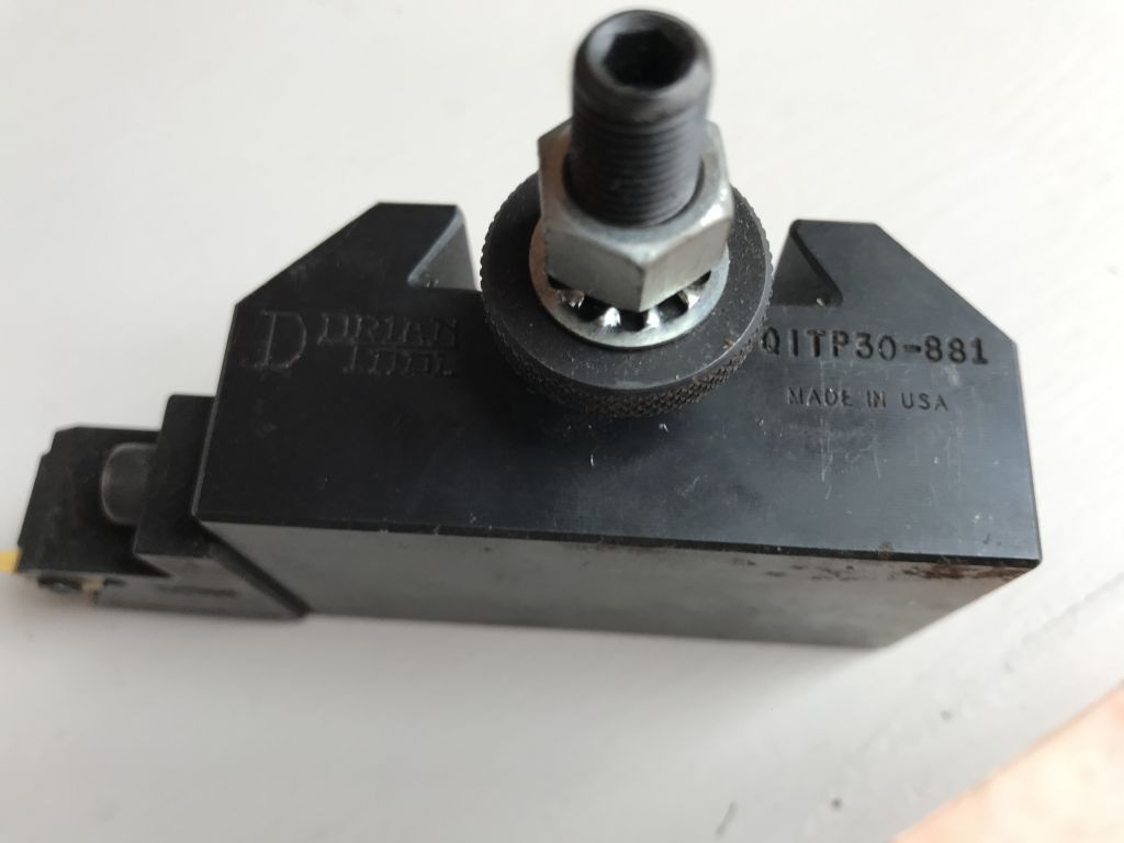

                                                The wedge toolposts seem to be similar to the Dorian product from the USA. I have several Dorian toolholders and one is very unusual in that it carries the inserted tool in a special front mount 'bracket'. The tool I have is an insert tip for acme threads. I would be interested to see if this would fit one of these wedge type posts.
                                                Toolholder:-
