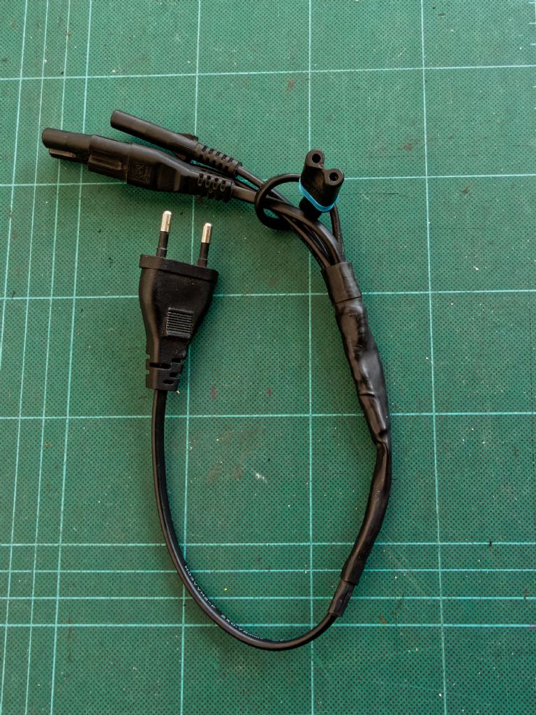

                That was the reason I linked to the one I did, with the switch.
                It might provide a suitable small enclosure to join the wires together; chop off the plug end from the internal switch contacts and solder in the shortened cable hanging out of the flash head.
                I used the heatshrink joining method when I've made by various hydra headed charging leads, for when we go on holiday. I've one with 3 ends on a UK lead, another on a continental lead (below), and a third one on an American blade plug.
                This continental adaptor has had one of theC7s, with the blue band, modified to fit a clover leaf socket as well as a C8
                Hydra Mains Cable
                Bill

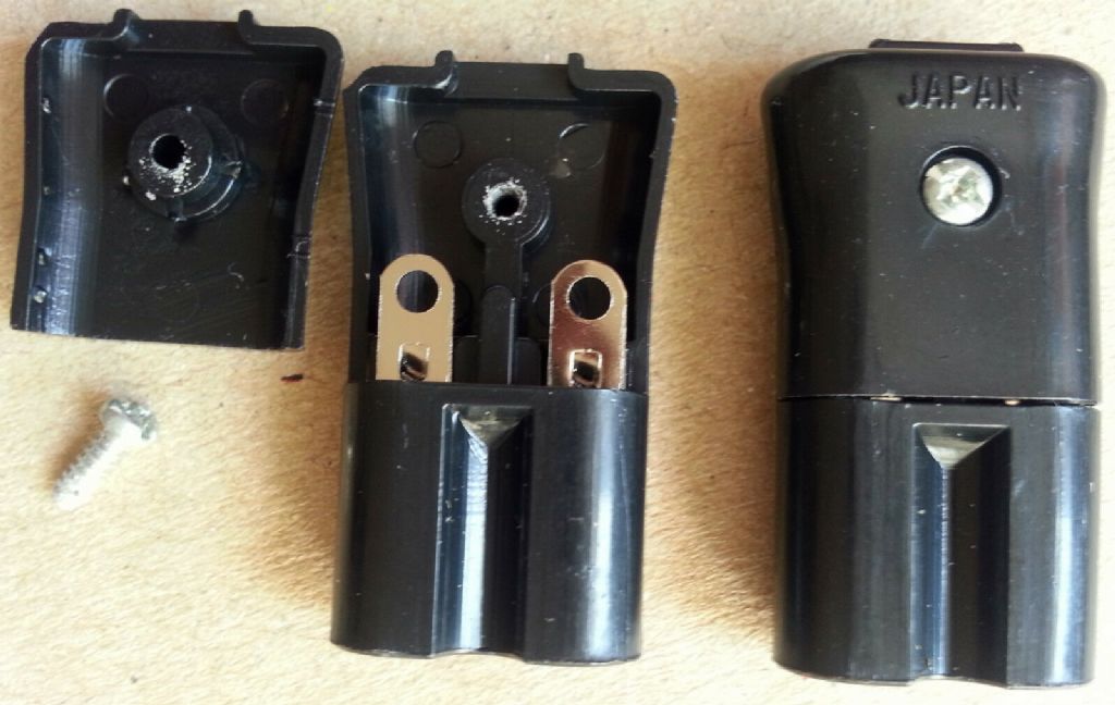

                      This solder plug, trimmed to to leave vestigial ears for gripping to disconnect, sealed with adhesive lined heatshrink, topped up with hot-melt could hang off the flash unit (e.g. eBay item 254292037485). The rewireable socket (eBay item 161839908218) could be wired with flexible 2-core silicone sheathed cable.
                      Andrew
                      Edited By Andrew Entwistle on 01/09/2021 16:27:23
                      #560727
                      Andrew Entwistle
                        @andrewentwistle
                        Would probably want to adhesive lined heatshrink the socket as it has no appreciable strain relief and maybe not the capacity for the sheath. Perhaps straying too far from your 'safe' brief?
                        Edited By Andrew Entwistle on 01/09/2021 16:31:44
