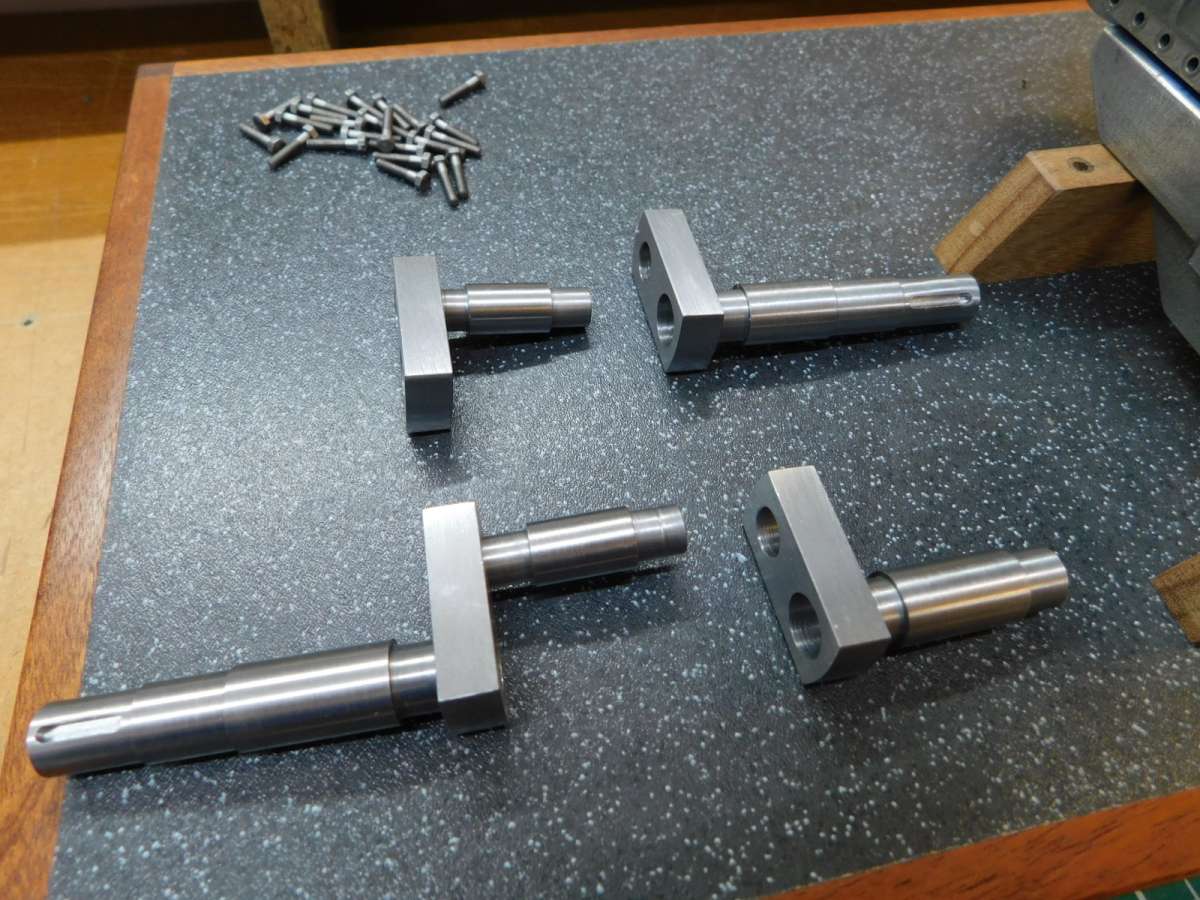

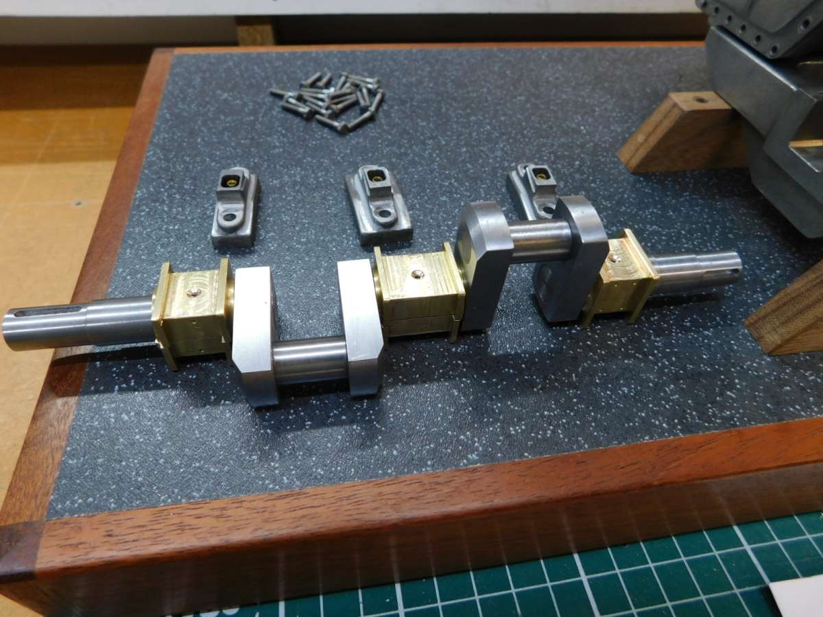

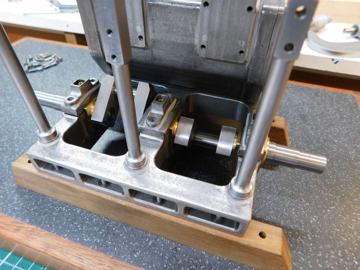

                      Loctite 638 will be more than strong enough- I have used this on cranks before and on my current build a twin throw for a marine condensing engine. I don’t use taper pins but do pin them with mild steel pins through the ends of the crank drilled just a small amount into the other side of the shaft – no need to go any deeper. By doing the ends there is only one area to clean up
                      I have mentioned this before – do not deburr the drilled hole before insering and loctiting the pin in but just peen slightly  enough to swell the pin and then file to clean up. If done right this will leave little or no trace of the pin but if deburred there will always be a witness
                      Here are a few pics to give you an idea of the result done as above – the webs were pinned after the setting of the webs and before turning betweeen centres.
                      Hope that is of help to you
