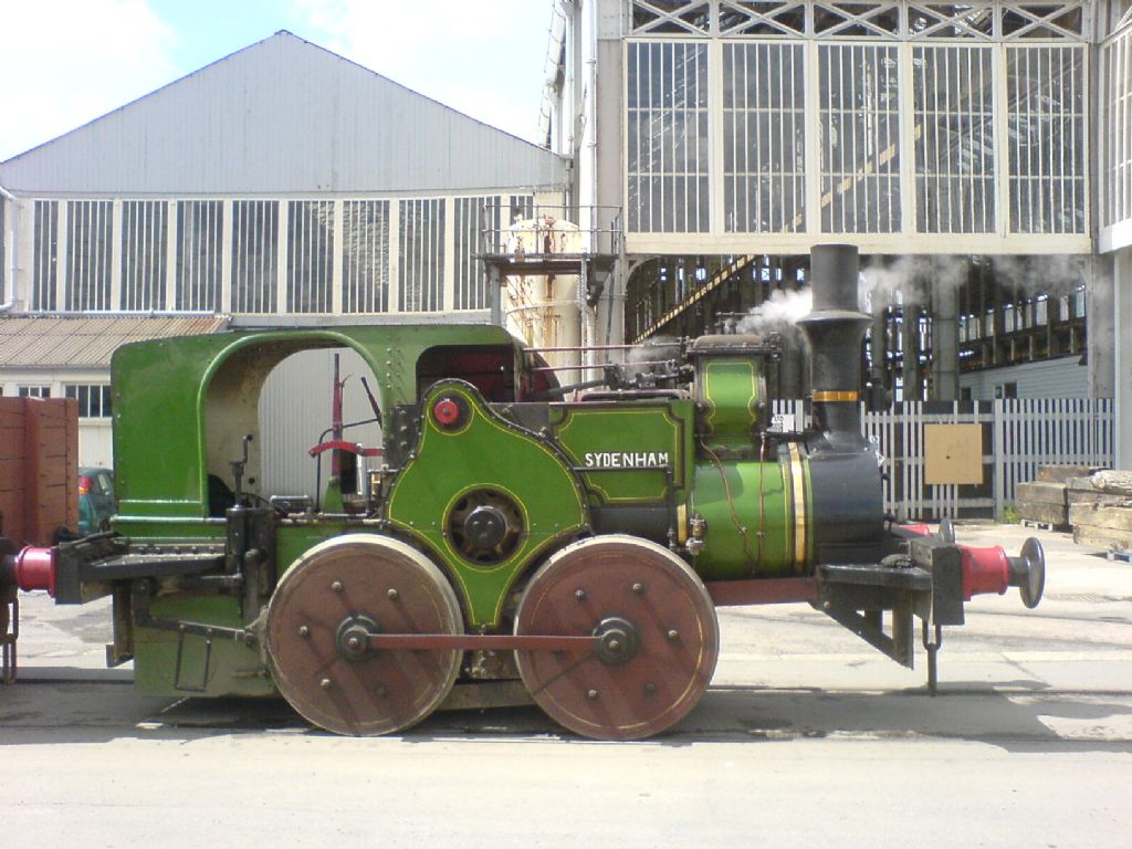

        It looks to me that the boiler is at a similar height compared to the buffer beams as that on Sydenham (pictured), which has 4' drivers. If so there should be enough room for the Marshall loco's axles to be set 9" higher.
        Brian

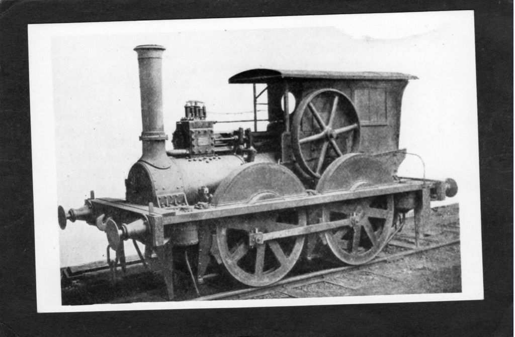

          Brain, did you see this photo from another post on TT?
          Also did you get the works drawing numbers from the guy that offered ?

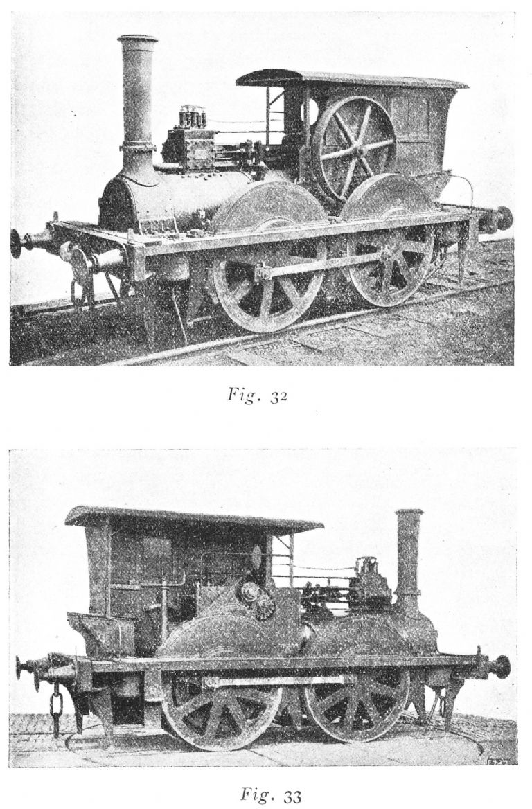

                  I just now came across these two pictures of the Marshall locomotive in "The Chronicles of Boulton's Siding, apparently taken at Ashton before the locomotive became Marshall's shunter, and without the rectangular box (tank or ballast weight perhaps?) beneath the firebox smokebox (whoops). This came as a surprise as I understood that Hall & Co. returned it directly to the builder.
                  Did Marshall's try to palm Boulton off with the loco when it was returned to them? Whatever the reason, they provide a lot more information on the loco and its one-sided cab. Other than the length, which is given as 21' 11". (5" longer), the text confirms the dimensions given in "Traction Engine Locomotives", whilst adding that the water capacity was 230 gallons and the bunker 5 1/2 cwt. Despite the evidence of the photos, it is described as having a "solid fly-wheel 4ft.8in in diameter"!
                  Unfortunately the book and its reprint have been out of print for many years, so hopefully the copyright holders won't object to a single scan.
                  Brian G

                      I think the one in fig 32 is the same image that was on TT but not as clear. Click image to see it larger.
                      Edited By JasonB on 10/09/2019 07:04:01

                                Edit:  Don't look at the picture of the Aveling loco further up the page, on their 0-4-0 geared locos the side rods are just there to keep the axles pointing the same way, which says more than it should about the lack of rigidity of their design.
                                Edited By Brian G on 10/09/2019 21:30:07
