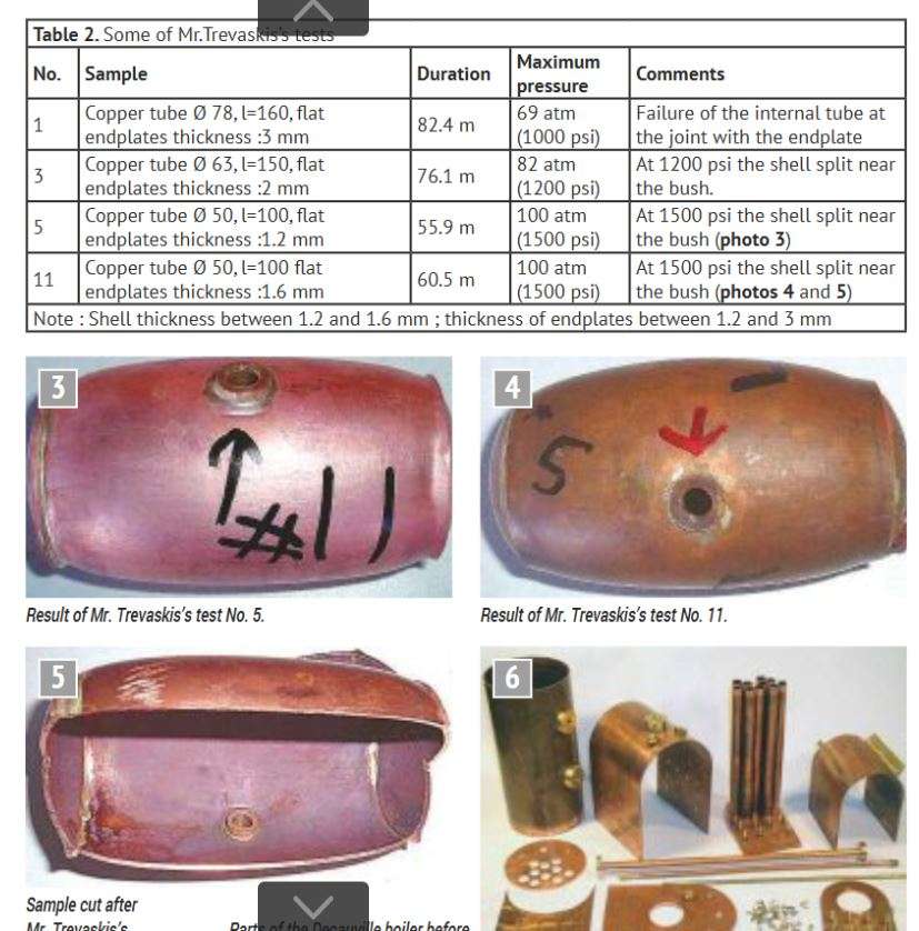

                    There is an interesting discussion about the need to flange copper boilers on this forum and the Twin Sisters flangless boiler design is referenced and discussed. Also on the same thread in that forum, calculations are presented that prove, from a structural strength perspective that flanges are not needed at silver soldered copper boiler joints.
                    In fact a T joint without flanges (such as at the smokebox tubeplate) only has to be 18% as strong as the copper it is joining.
                    Flangeless Boiler Design Vindicated?​
                    Well, to my surprise (April 2025) I recently came across and example of this (5″ Gauge LMS 2F dock tank Twin Sisters) boiler built to the original flangeless design for sale (as part of a loco) for sale (now sold) on a reputable website:-
                    https://www.steamworkshop.co.uk/portfolio/5-lms-2f-3/
                    Quote: The boiler is of course also brand new and made to the published design,….. and fully silver soldered copper construction.

                        Close examination of the drawing shows the joints are slightly better than first suggested, but not much. The barrel is turned to create little rebates that give positive locations and increase the joint areas very slightly. Nevertheless, it is a fundamentally weak  design.
                        The inner firebox plates have plenty of stays but are a mere 14swg (2mm) thick! The outer plates are 1/8” – still a bit thin for quite a sizeable boiler.
                        I could not understand the staying. None of the rods themselves are shown on the drawing, only their locations plus a mysterious instruction implying they pass through only the outer wrapper. Surely not?
                        Incorporating the blow-down valve in the foundation-ring? What – directly in the copper? Apart from the thread wearing rapidly, or evenn stripping, I don’t think it would weaken the ring significantly. However, because it creates an abrupt elbow, it would not be very effective as a blow-down, let alone wash-out point. It’s not clear where it discharges, either.
                        There are other puzzles. What are the two (tubes? rods?) arcing back from the regulator? What are the two hidden-detail (chain-dashed) lines presumably where the safety-valves would go, shown above the crown-plate?
                        Hmmm. Let us turn to the various responses below the quoted drawing from Model Engineer.
                        As for its strength, we now know that a properly brazed boiler has joints that are as strong as, or even stronger than the parent metal, and advantage is taken …. to ensure that the finished article will withstand at least four times its normal working pressure.
                        I think this is what has led our friend in Thailand astray, with his remark about the joint needing be only a fifth of the strength of the plates.
                        Four times…. well, clearly the boiler should have a good factor of safety so four times makes sense provided that is calculated-only, and no-one reads the F.O.S. as the shell test factor!
                        Is this why J Austen Walters’ boilers distort? His comment that tapping the metal back will “instantly” (really?) work-harden it so you can over-pressure it again, certainly ain’t in the Orange-On-White Good Book.
                        300 (psi I assume…) As a shell-test pressure that implies a working-pressure of 150psi: high for a copper boiler on a  5″g locomotive; and especially with such thin firebox walls. Yet that writer calmly talks of the test-pressure “reaching up to 300”, and repeating this “test”.
                        I think he has been quoted only partially there, leaving me wondering about “no more” noises from the boiler’s innards. Yet I don’t think he follows the M.E.L.G. Test Code, which seeks to protect innocent boilers from bad “testing” as much as protecting people from dangerous boilers.
                        Thin? Look closely at the photograph of the boiler on its own, with its front propped on the dome cover. Has the protruding rim of the barrel pushed in slightly where it rests on the dome, or is that an optical illusion?
                        I do not suppose I am alone in having serious misgivings about that particular locomotive; and I do hope the buyer will not find himself with an unuseable purchase whose provenance seems odd.

                          Nigel, referring to your comments on the boiler drawing for the ‘Twin Sisters’ 5″ LMS 2F Dock Tank by JI Austen Walters published in Model Engineer magazine 1949, It is reassuring to know that other model engineers review and comment on proposed designs to ensure the continued safety of the hobby. I should clarify that I have not myself reviewed the design at all – I merely posted the drawing and the reference to an actual boiler said to have been built to this design for sale at Steam Workshop, as a matter of interest.
                          Also I would like to clarify, for the benefit of our readers, that your reference to the four times working pressure as a design target was a statement made by JI Austen Walters himself.
                          Coming now to the “I think this is what has led our friend in Thailand astray, with his remark about the joint needing be only a fifth of the strength of the plates”, let me clarify.
                          Stress calculations for a silver soldered joint applied to a disk of 1/8″ thickness silver soldered into a 2″ internal diameter pipe to determine the maximum uniform distributed pressure that the joint can withstand in sheer were made.
                          https://modelengineeringinthailand.com/forum/index.php?threads/bassett-lowke-traction-engine.55/post-363
                          The answer was 752 psi. This was compared to the yield point of the copper disk being 4,347 psi for fully annealed copper as follows:-
                          752/4,347 X 100 = 17.3%.
                          i.e. a joint strength of 17.3% of the copper yield point is OK (in theory).
                          Therefore I believe “our friend in Thailand” has not been led astray but has simply stated the potential validity of flangeless endplates.

                                I think John’s post is the one to take note of. Although a flangeless joint can be shown by calculation to be upto the job. In practical terms a flanged one is more likely to be successful as when the boiler cools the flange can flex and move a bit so you won’t get the joints opening up.
                                It is also a lot easier to put a couple of loose rivits or screws through a flanged joint to hold the various plates in place while you solder. Not so easy to fix into the thin edge of a bit of 16g copper. So again the joint and overall boiler are likely to come out as you want rather than things moving during soldering, coming apart on subsequent heats and/or ending up twisted and out of line.
                                #797154
                                  The other forum contains this sentence, my bold:
                                  Exactly! The shear stress at the silver-soldered joint (544 psi) is significantly higher than the bending stress in the plate, meaning the joint is stronger in shear than the plate is in bending. This confirms that the joint itself will not be the limiting factor in structural integrity—the plate material will yield first before the soldered connection fails.
                                  Isn’t this the wrong way round?  The shear stress being higher at the joint doesn’t mean the joint is stronger, it means it’s experiencing higher forces trying to tear it apart. That’s backed up by full-size experience – boilers often failed at the joints, for which reason they are beefed up.
                                  Applying the formula to a simplified case can also be misleading.  Instead, I suggest FEA with a CAD package.   Finite Element Analysis treats the object as a whole and colour codes stress concentrations.  And can do so over a range of forces, as when the pressure in a boiler starts to rise.
                                  Doing that shows:
                                  • At Standard Temperature and Pressure, everything in the boiler’s structure is equally stressed, and the stresses are low.
                                  • Initially, as pressure inside starts to rise, the boiler shell inflates like a balloon, bending out unless constrained by stays or other structure.   At first the stress at the end-plate joints will be similar to that on the plates.
                                  • But, as the plates bend further under pressure, the bends start to crowbar the joint apart, and the stress on the joints rises faster than that on the plates.   Note the crowbar, leverage is at work, not just straight pulling.
                                  Although the maths applied during FEA isn’t particularly difficult, it requires millions of calculations.  Briefly, the software triangulates the structure into a mesh and then calculates the stress in the sides of all the triangles – thousands of them.  The tighter the mesh, the more accurate the result, but the number of calculations needed rises rapidly.    The sheer number of sums mean humans can’t do FEA with paper and pencil – life is too short!
                                  The computers results are usually shown graphically by overlaying the model with the colour coded mesh, so it can be seen where the model is stressed and by how much.  Bright red means high stress, down through yellow and green to blue.    Red doesn’t necessarily mean the model will break, it only identifies the most highly-stressed areas.  (* some do identify breaking – if the material is fully specified.)   Anyway, the engineer looks at red areas, and strengthens the design at that point if the stress is of concern.  He also reduces weight and material costs by slimming the design where it is over-strong.
                                  Reinforcing isn’t the whole story.   The design is likely to include a significant safety factor, and, there’s probably a need to allow for metal fatigue too.   Another opportunity is applying FEA to the thermal characteristics of a model, an important, an non-obvious factor in boiler design.
                                  Unfortunately, FEA has a steep learning curve.   The object has to be modelled accurately in 3D-CAD, and then the FEA analysis has to be set up.   FEA assumes the engineer understands stress, it’s skilled work.   I’ve tried 3 or 4 times and barely dented the surface.   Nonetheless, I’d recommend anyone interested in modernising boilers to put the effort in.
                                  Flanges provide useful reinforcement and ease construction.  It suggests builders would need a very good reason for not using them.

                                    Modern industrial steel boilers have corner welded joints, no flanging, and I know of several loco boilers with the same. There is a book about the design of modern steel boilers by a chap called Green (I think) which is well worth a read. He dismisses flanged plates as ancient technology, and he was chief designer for a large boilermaking company, so we can take if that he knew a bit about it. Delving into FEA is not for the novice, especially with ductile materials, which give a bit under initial pressure test to dissipate local high stress. As Jason says, it is a lot easier to hold a flanged joint together with a few bronze screws or copper rivets for silver soldering than with a corner joint. We must recognise that the throat plate to barrel joint on hundreds if not thousands of copper boilers is a corner joint. I’m not aware of any that have failed
                                    Even though I know corner joints can be OK, I’ve been involved in designing and making 3 copper boilers, they all have flanged joints because on balance I reckon it’s easier. If I had the kit and skill to do TIG welding I daresay I’d change my mind.
                                    #797172
                                      Not just modern commercial boilers. The likes of Haining was describing butt and corner joined steel boilers for models 45-50 years ago. Though Welded steel and with proper joint prep. And we have certainly had tig welded copper model boilers about for 20years again no flanges.
                                      Back to practicalities. the difference is they are welded, you can do a few quick tacks and that will hold things together or get as carried away as you like with chunky jigs as they will not act like heatsinks which draw the heat out of silver soldered work and previous joints are unaffected by additional welding.
                                      The heat is also more localised so you will not see say a boiler barrel expand as much as it would if heated for soldering which reduces the risk of joints failing as the boiler cools. Even if the joints don’t fail on a silver soldered boiler it would be wise to allow some factor of safety into butt joints as stressing the cooling joint won’t do a lot of good for it’s strength.
                                      #797203

                                            Better here than for a forum with just a couple of members as it will get seen by far more people.
                                            It was also you that brought it up in a 8 year old thread on here which has started the discussion again.
                                            A read of ME4651 may be useful, this image taken from it. Note that the endplates are soldered onto the tube not into it.
