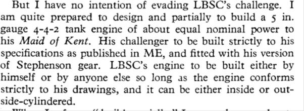

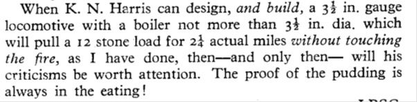

      While I agree with many of the comments in the letter in the latest ME decrying the inaccuracy in many valve gear designs, those on LBSC's challenge to K.N.Harris require some comment.
      LBSC's original challenge was:-
      While the reply from K.N.Harris was:
      So instead of LBSC 'backing out' what actually happened was that KNH refused to take up the challenge as given but instead wanted to pitch a 'Maid of Kent' against a tank engine designed by, but not built by him in order to 'prove' a quite different argument.
      So while the arrogance of LBSC's challenge might be questionable, his opponent never had any intention of accepting it in its original form.
      (Extracts from ME 3292 and 3296)
