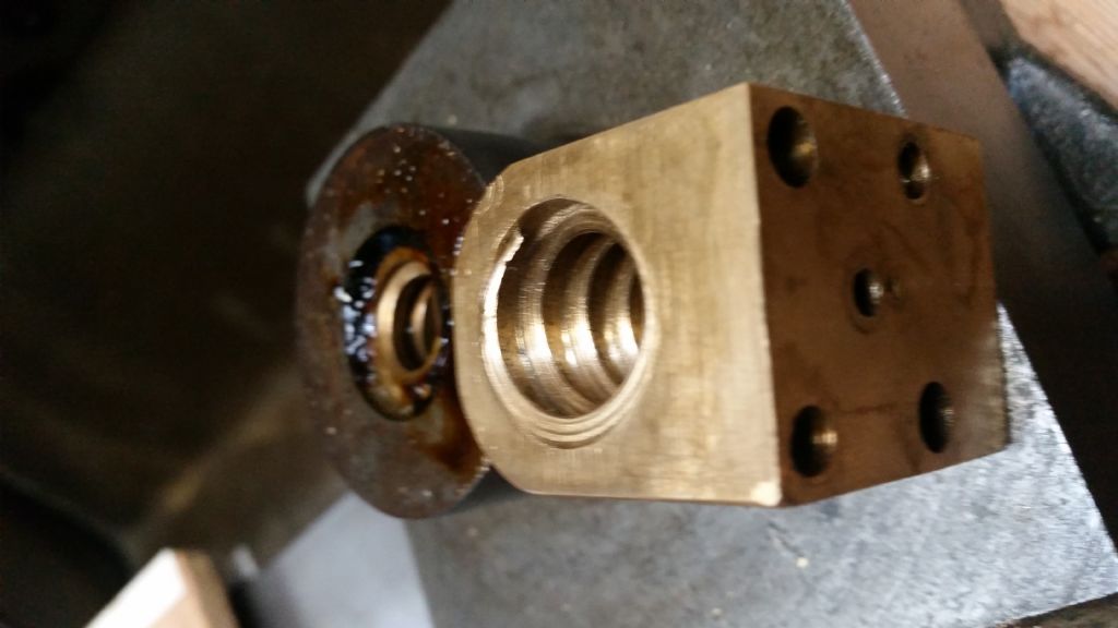

      hi all I've purchesed a Mitchell lathe but the acme nut is badly warm I've tried to find a engineers to make one for me but with no success I live in wigan and would appreciate any help in finding someone how can make one

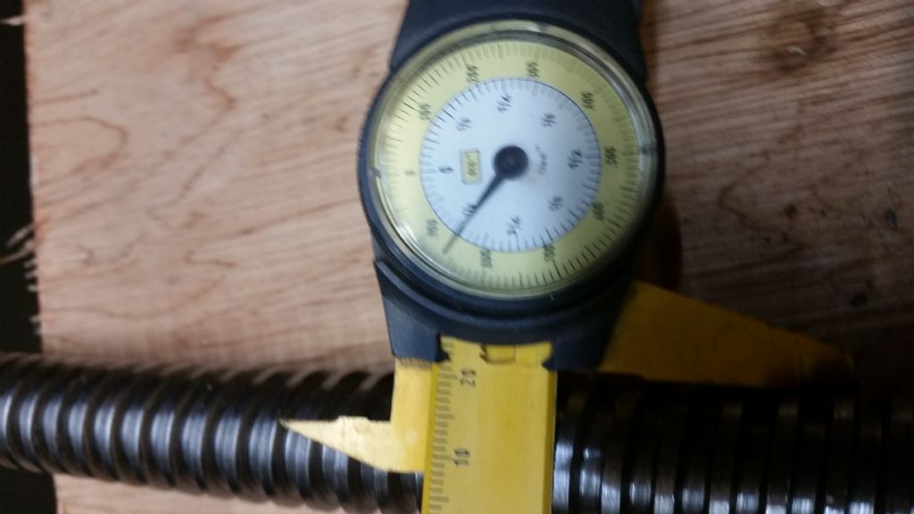

                  Hi thanks for the the help it's a 4 t.p.I for a 7/16th's rod I contacted
                  A couple of places but some didn't do them and other would only
                  Do them in bathes that would cost around £900 to a £1000 I've checked the rod and there's no visible ware on it the nut is very badly warn though

                      7/16" 4tpi had 1/4" of thread and only 3/16" core. Are you sure it's not a 2-start thread with 1/4" lead and 8tpi?

                          Mart, the dial will tell you the lead but not always the pitch. If it's a 2-starter the lead will be .250" but the pitch .125". More importantly the double-depth will be 1/8" and the core 5/16" so much stronger.
                          I can't imagine how anyone would cut a 7/16-4 internal acme thread (unless as you say it's stub acme). I'm sure it's possible I just can't imagine how. Too small and coarse to single-point and a tap would be very weak. My milling machine has a 5/8" .400" lead 2-start square thread screw on it and that would be bad enough.

                                hi all sorry its 7/8ths major diameter not 7/16ths as I stated earlier

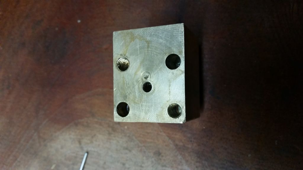

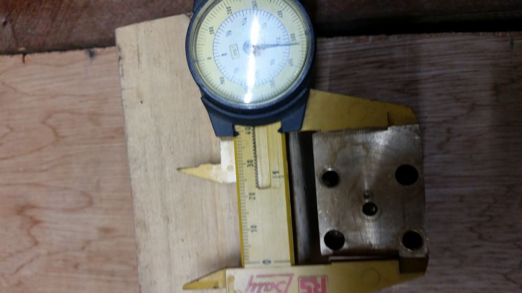

                                        Hi all these are some pic of the screw and the acme nut as you can see in the second pic it is badly warn

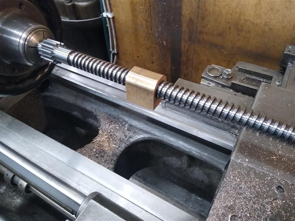

                                                  I made a new nut for Frank and he's now up and running again. The screw was in very reasonable condition so the new nut will last for many years.

                                                      Fitted the new nut pete rimmer made for me and couldn't be happier it fitted like a glove absolutely no play in it first class work
                                                      Thank you very much for your help and to all for their advice
