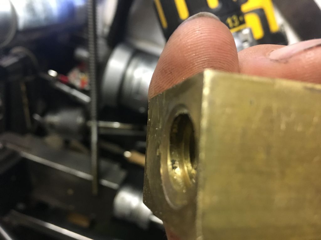

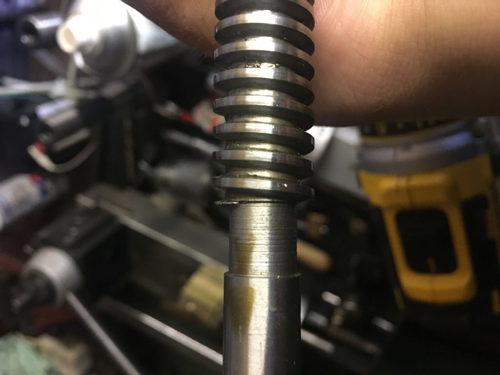

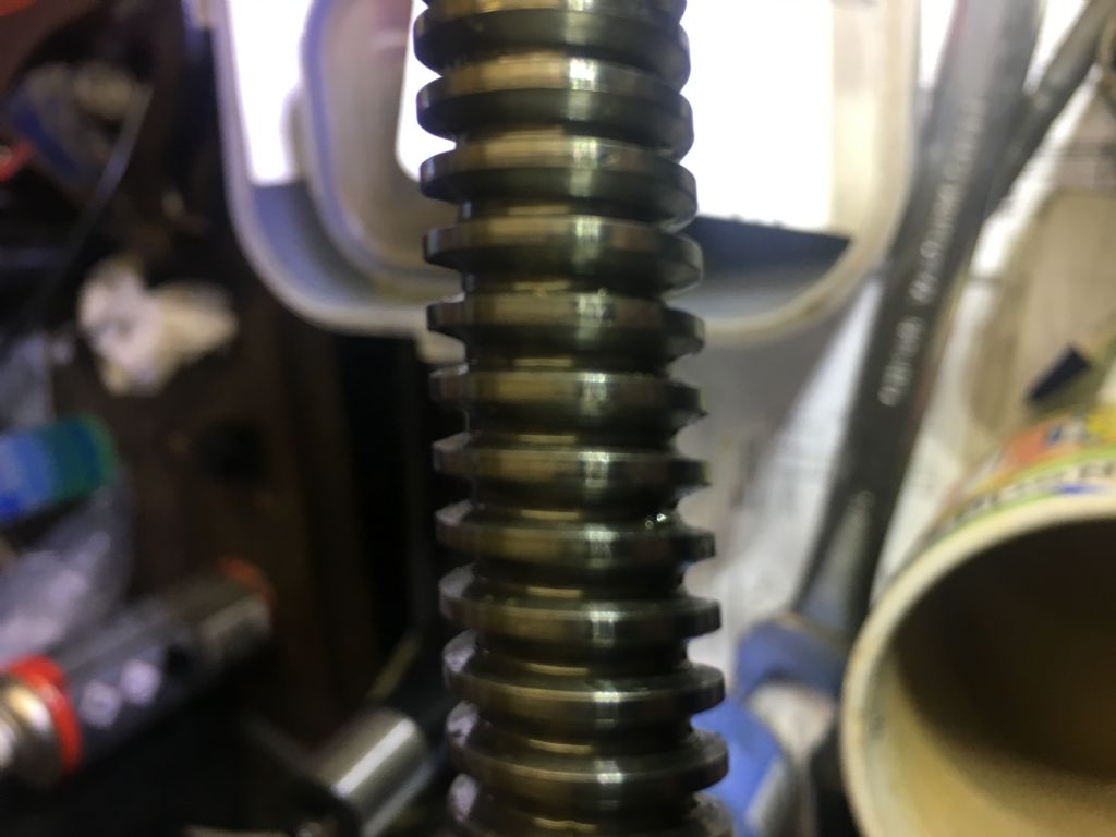

                          46d77de7-5d85-47d3-b8b5-81845f6c3da5.jpeg20388f5c-7f8d-4cb2-80c7-511bc5e0e3e8.jpegEvening all on closer inspection it appears a square thread does it look like it up you lads ? 16dfbbbf-04cd-41c6-8065-415333149368.jpeg
                          #431514
                          old mart
                            @oldmart
                            Richard, that thread of yours looks like ACME or trapezoidal, (29 or 30 degree angle), not square. If it is imperial pitch, it is ACME, and if it is metric pitch it is trapezoidal.
                            Chris Evans mentions that 16 X 4 TR leadscrews and nuts are easy to get hold of, this would be the easiest option, just a little machining of the ends needed. And an opportunity to incorporate antibacklash if there is room to do so.
