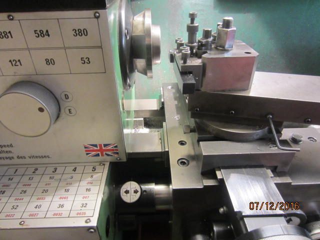

                                I've just realised I have about 10" of 2" long telescoping tubes that came from a fluffy duster. They are a bit stiff but could easily be attached to my existing simple aluminium swarf deflector. They would close up when near the headstock and have to be opened up by hand.
                                The smallest tube is a bit larger than a film canister and they increase in size by about 1/8 inch.
                                This is it, I can't find a pic of just the cover:

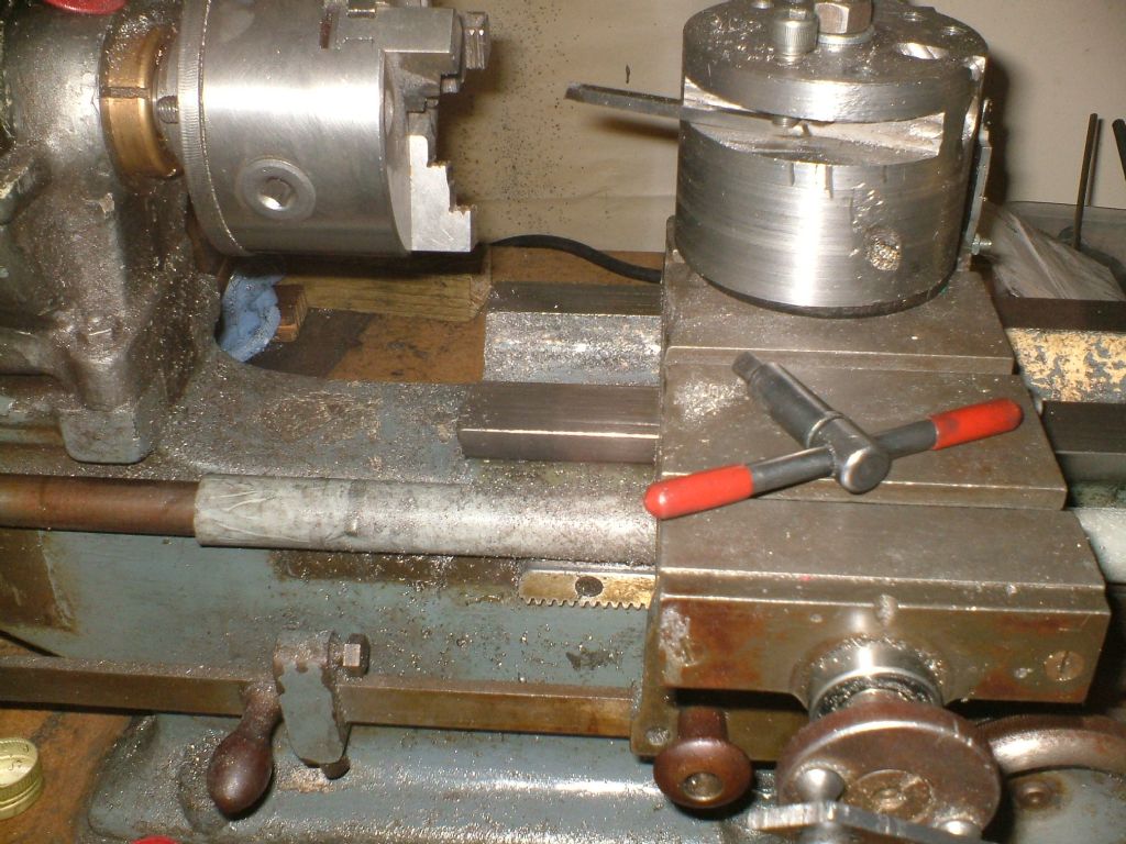

                                                    90% of my leadscrew swarf falls just in front of the saddle so I have a bit of loose plastic pipe which I fitted onto the leadscrew (removed and refitted)
                                                    Cost me about 0.01p and 45 minutes of my life 5 years ago
