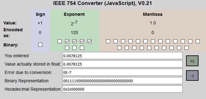

                              It's the denominator that matters, you won't have seen an LBSC fraction whose denominator wasn't a power of two. So 1/128 (for example)
                              Having written a BASIC interpreter I know about floating point representation. You've actually handed me a wonderful proof that imperial fractions are better than metric decimals…
                              As you say figure such as 0.1 can't be stored precisely on a computer using usual floating point formats, but let's try a fraction, such as 1/128, the smallest you are likely to find (I have to input the fraction as the equivalent decimal):
                              Oh look! The error is… nothing!

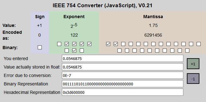

                              Forget multiples of three, let's use a prime number as the numerator, how about 7/128:
                              Wow! Perfect representation again. Clearly Imperial fractions are completely superior.

                                    For the sceptical:
                                    http://www.h-schmidt.net/FloatConverter/IEEE754.html
                                    Hi Neil, You are an interesting man lol. Actually, while I was posting my 0.1 decimal to floating point binary conversion example, I wondered if you (or somebody) would refute that by showing fractions that are powers of two. I honestly didn't think this would be the case on a model engineering forums. But I'm absolutely delighted about your reply!. Having written a BASIC interpreter puts you in a strong position for that. My background is computer software development, and I too have written a couple of interpreters of common (old) computer languages, and a compiler for a specialised computer language aimed at the knitting industry. I am also the main developer of the HMI Draw and HMI View apps in the App Store, which also contain a real time pseudo-compiler to RPN for fast execution of Ruby expressions.
                                    So yes, you are right. Indeed, fractions commonly used in imperial dimensions have a better representation in computers.
