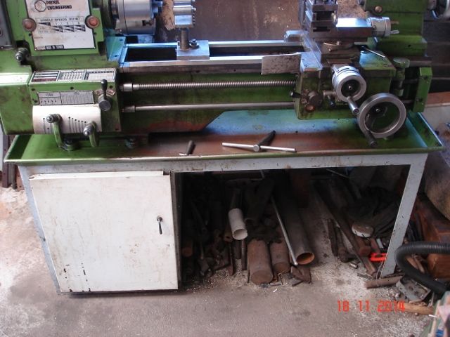

            For my 1326 BH Taiwanese lathe, 275kg, I built a stand from 50 x 50 x 6 mm angle iron, its been very good for the last twenty odd years, today, knowing a bit more about things like that, I would most likely use square tube instead.
            Ian S C
