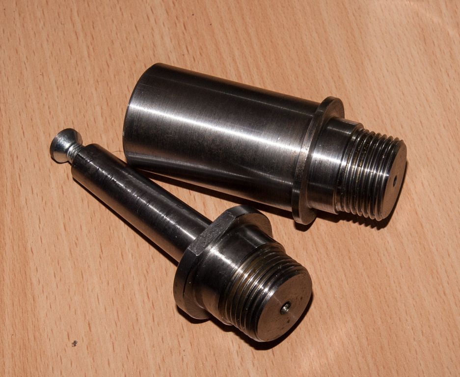

                        I recall, many years ago at a ME exhibition, Myford selling, quite cheaply, short lengths of bar with the Myford screw thread and register machined on them. They also sell ( sold?) a screw thread and register on a No 2MT arbour for mounting chucks in the tailstock etc.
                        I have found the No.2 MT version useful from time to time but am still seeking a use for the other version – although it might serve for " Lambton's" ( Please give a First name for us to use!) purpose. Anyone got any other bright ideas?
                        Regards
                        Norman
                        Edited By NJH on 17/10/2012 18:33:11

                          A dummy spindle nose comes in useful if you want to turn something which screws on to your real one. For example, if you want to make a screw-on ER collet chuck, you can test the thread, and then the register diameter, without removing the job from the chuck. Once right, you can fit the embryo collet chuck on your real spindle and machine the taper etc, thus keeping everything concentric..
                          Andy

                                I could certainly suggest a use for the illustrated Myford nose on a plain shank. Whilst it might not please the purist engineer, I have occation to use a Myford size chuck on the Harrison L15 I use at work. This has a 10" threejaw chuck, so when I want a more delicate part held I often chuck the small chuck in the larger one. I also have an Albrecht 1/2" chuck on a spigot which gets put in to hold little screws etc. for modification. As the saying goes in my industry "It's near enough for farm work".
                                Alan.

                                  Thanks Alan
                                  Clocking it up in a 4-jaw independant might offer more precision though! wink
                                  My equipment is a rather the opposite of yours – the Myford is my "big" lathe and my other lathe is a collet only model with collets 0.4mm to 4.8mm ( x 0.2 mm steps) !
                                  Andy – yes good idea but I already have a screw-on ER25 chuck ( I didn't think of making my own at the time!) but maybe some other similar project may occur and it would certainly be useful for that.
                                  Regards

                                            Norman, as it was made by Myford themselves, I bet it would be worth something to someone. Maybe you could rent it out to those who want to make properly fitting backplates and other attachments.
                                            Andy

                                              Norman's comment re a four jaw is good, but even this has limitations on a ten inch four jaw as the jaws struggle to grip small diameter stuff.
                                              Alan.

                                                I was suggesting that you could put the Myford adapter in the 4-jaw and clock it up to achieve greater accuracy. I guess however that changing a 10 inch chuck is something you don't want to do very often!
                                                Norman

                                                      As it happens I have 2 spindles for my Myford ML10 plus a Myford-produced dummy spindle nose of the type mentioned by Norman. As a complete amateur I was hesitant to enter the debate on that forum but I did make a post reporting my findings in measuring the 3 Myford spindle noses. As regards the registers, each measured 1.250" dead with not a smidgeon of difference. However, a simple measurement across the thread crests showed more variance. One spindle measured 1.125" (nominal), another 1.124" and finally the dummy measured something 1ike 1.121 (I can't be more precise as the post is long gone and my dummy nose has gone walkabout). Anyway, I suggested this showed that one fairly well-respected manufacturer, at least, was punctilious about meeting their nominal register spec but less so as regards the thread dimension. This argued that Myford regarded the register as the ruling factor, not the thread (Lambton's quote from the Super 7 manual confirms this). In the event this data was ignored by the Screw School as they'd done with other challenges.
                                                      The point of this tale is to raise a note of caution about using the Myford dummy spindle nose as a gauge for preparing a backplate. The register will probably be fine for this purpose but any variance from nominal in the thread might produce unpredictable results when fitting to the target machine. It might be wise, Norman, to check whether there is any difference in your case.
