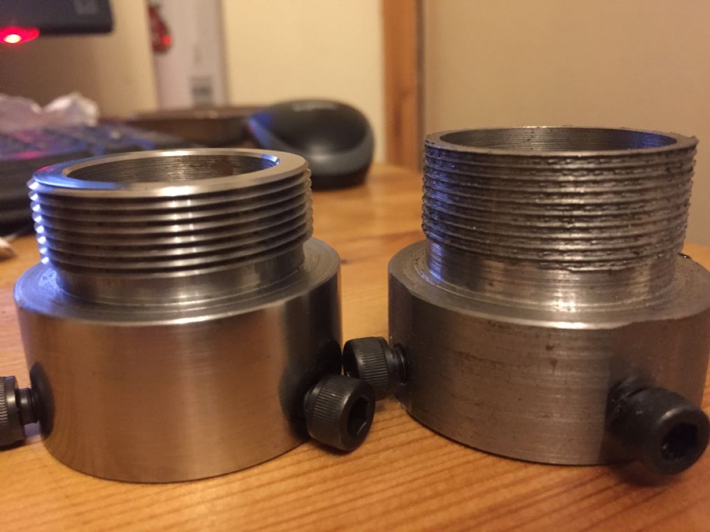

                                                    #399025
                                                    Robin Graham
                                                      @robingraham42208
                                                      Posted by Andrew Johnston on 05/03/2019 19:51:40:
                                                      If an insert where did it come from? Hint: bang good is the wrong answer.
                                                      41 x 1.5mm threads from the same bar under (more or less) the same conditions:
                                                      No prize for guessing which was the bang good insert. I was surprised because the bang good looked perfectly OK…..
                                                      I know many people have had good value from bang good, but in this case it didn't work – a bit of a lottery, which isn't what you want when you're trying a new technique and unsure if it's you or the tool.
                                                      Robin
