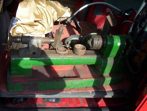

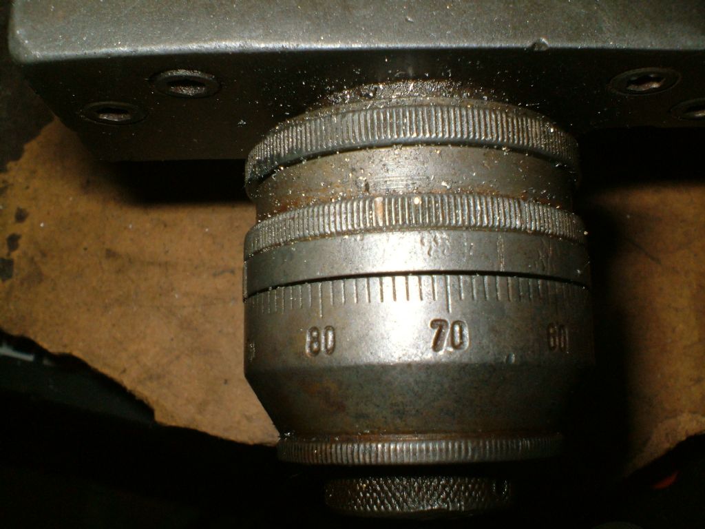

                #85217
                Ady1
                  @ady1
                  Was semi-scrap when I found her
                  One dial came up nicely, the other dial was too worn to see after decades of use
                  I only ever used a soft scrubber, otherwise you will lose any detail remaining on the original lathe.
                  A wire brush is a definite no-no IMO
