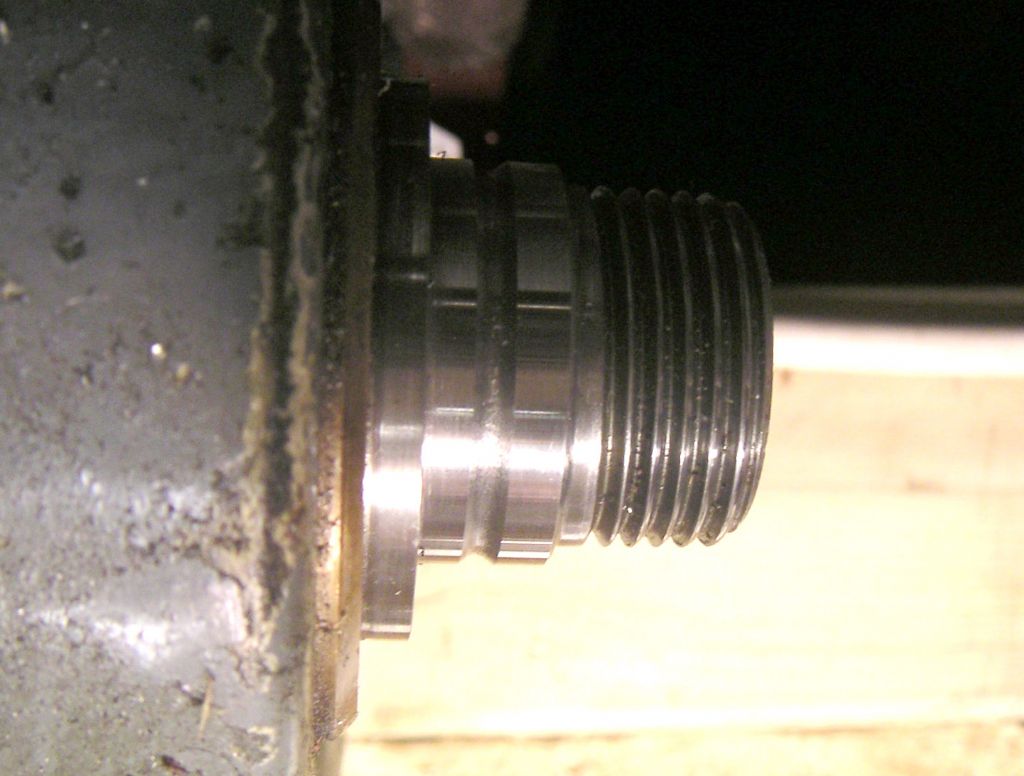

                                          Nick Hulme
                                            @nickhulme30114
                                            If you machine a small groove in the cylindrical section of the spindle register you can add grub screws to backplates which will prevent the chuck from unscrewing if stopped sharply or run in reverse.
                                            This is the standard nose on my 1950s Super 7 with the groove I added, I did loads of turning and threading in reverse and never had a chuck so much as slacken slightly.
                                            The problems cited for screw on chucks are user behaviour related, I never encountered any of them in over 20 years of using this old lathe
