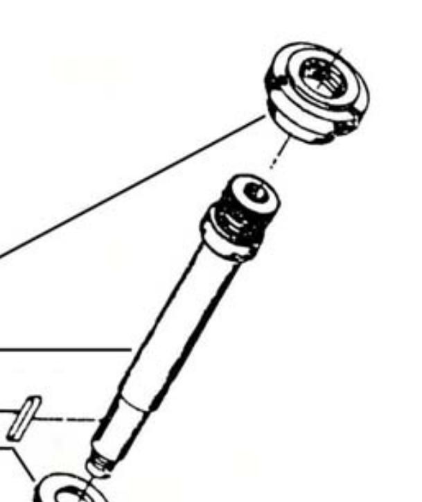

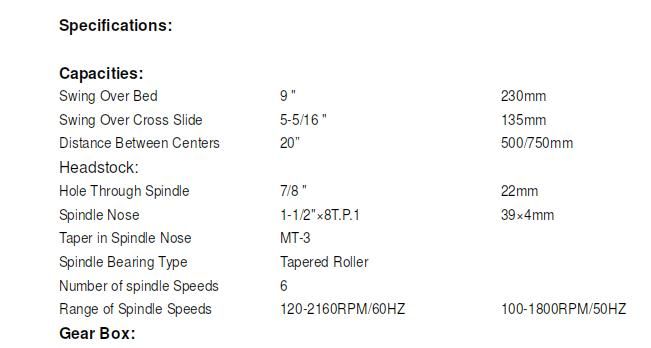

                                          In the related thread KWIL provided a **LINK** to the manual. This reveals:
                                          The manual doesn't say how the chuck is removed but it appears to me that the flange screws on to the spindle and that the chuck is bolted to the flange? I could be wrong. Also, that the nose thread is different depending on whether the lathe is Imperial (8 tpi) or Metric (4mm)? Again I'm guessing. No wonder Christine is confused!
                                          Christine: are you able to take your chuck off and post some pictures and measurements please? Does it unscrew or unbolt? Is your lathe metric or imperial? I think we're danger of misleading you through lack of information.
                                          If all else fails the other thread has some good advice about how to do the job without a 4-jaw. I

                                            You've had rather a bad start to your lathe but that 39×4 spindle thread is really the only troublesome feature to overcome. Everything else you might need is easy to come by and fairly standard. The 9x20s from many sources are all the same machine under different paint jobs.Grizzly, Jet, Enco, Harbor Freight and many others – they are all basically the same lathe.
                                            PDF manual here http://cdn0.grizzly.com/manuals/g4000_m.pdf
                                            This is the Grizzly manual but it is identical to your lathe,
                                            Roger

                                              The Warco 918 metric version will probably be M39 x 4 – backplate part number 5424 @ £36 each
                                              **LINK**
                                              Warco also did a version of the 918 with the Myford nose IIRC, which is probably the Imperial version they show.
                                              Chester list their equivalent as 40 x 4, but while the "M39" is the thread, the parallel register is 40 diameter (according to a Roehm spindle nose drawing), so Chester may be refering to that in their description.
                                              A call to either should confirm suitability. IIRC pretty well all the 918/920 machines were originally supplied with both 3 jaw SC & 4 jaw independant chucks and a faceplate, so probably not much call for plain backplates.

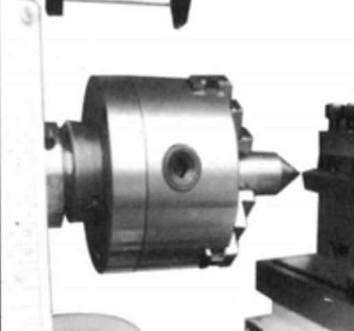

                                                Dave, yes the chuck unscrews off the spindle (as does the faceplate) see the attached URL's:
                                                This one is the spindle:
                                                http://s304.photobucket.com/user/christineanniewalker/media/IMG_3299_zpstv9uyzmz.jpg.html?o=0
                                                This one, the back of the 3 jaw chuck just removed (it just screws on, then held in place with a grub screw):
                                                http://s304.photobucket.com/user/christineanniewalker/media/IMG_3300_zpsex3itbhv.jpg.html?o=2
                                                (This one is the spindle with a digital calliper, does it help?
                                                http://s304.photobucket.com/user/christineanniewalker/media/IMG_3301_zpsdh0tzjez.jpg.html?filters%5Buser%5D=142907852&filters%5Brecent%5D=1&sort=1&o=0
                                                Sorry, I don't seem to be able to upload them to here, it doesn't like my mac! – not having a good day am I!)

                                                      Arc list a 1 1/2" x 8tpi for less than £20:
                                                      http://www.arceurotrade.co.uk/Catalogue/Chucks/Lathe-Chuck-Backplates/Backplate-BOXATL-VICSOU-5-112x8TPI-Plain
                                                      This is a standard for "Boxford, Atlas, Viceroy and Southbend lathes" among a few others.
                                                      39 x 4 is far from exactly the same as 1 1/2 x 8 whatever that manual says! Measure across the top of a few threads to see whether the spacing is nearer 3mm or 4mm
                                                      It is more usual than not to have to use a backplate, as that means one chuck can be fitted to many lathes of different sizes.
