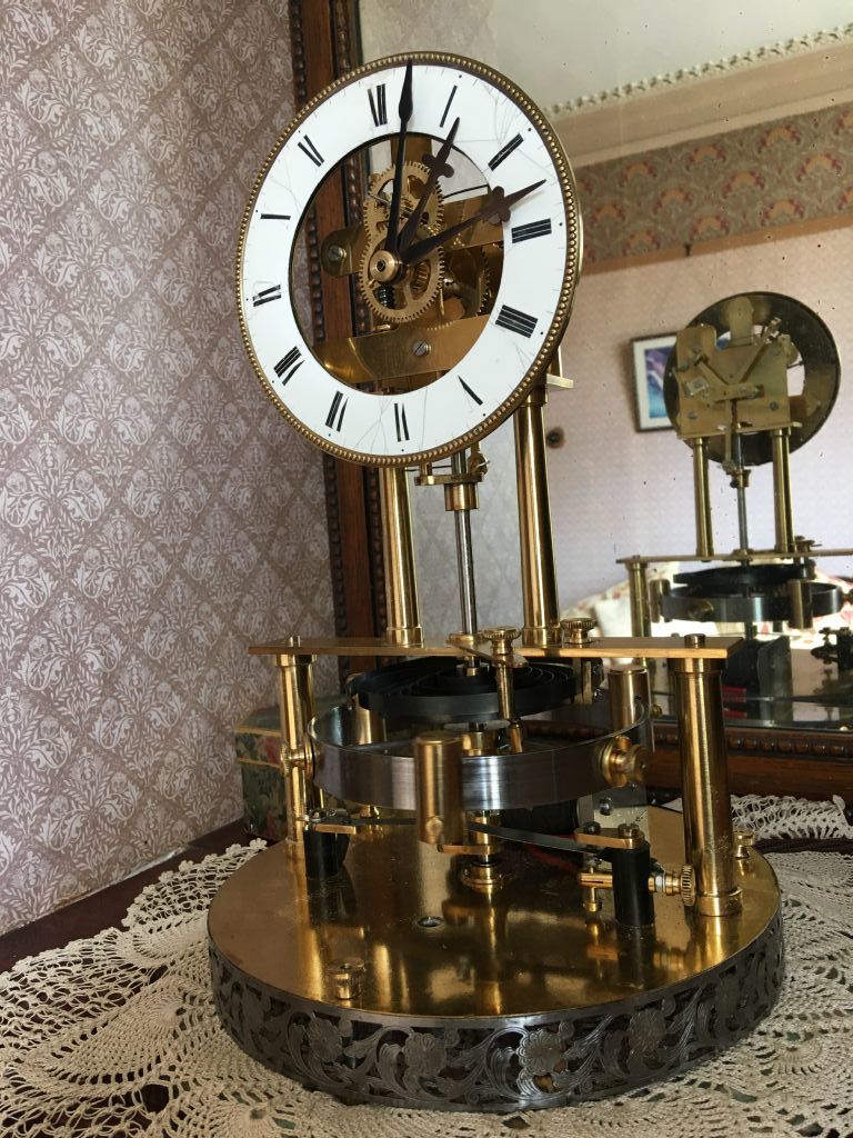

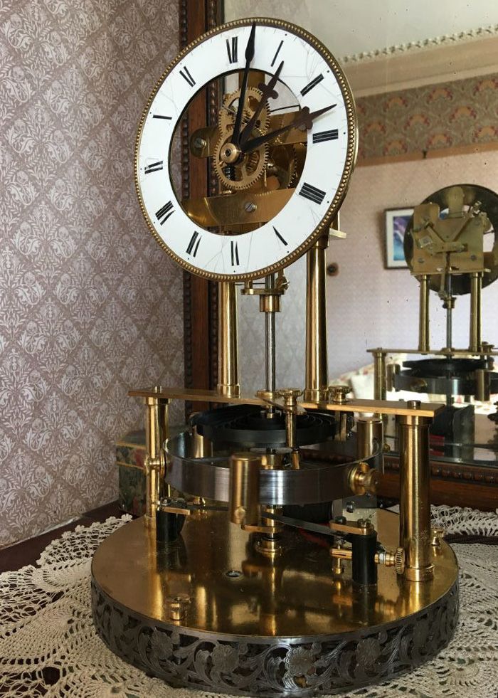

      Just about finished making John Wilding's version of the Murday Reason battery clock. Just to say thank you to everyone here that helped with advice

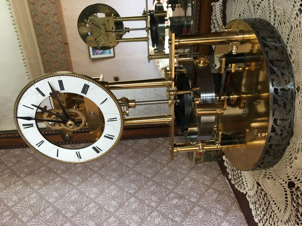

                          Who doesn't like clocks! Here it is the right way up – enjoy!!
                          #471086
                          David Noble
                            @davidnoble71990
                            Brilliant Howja do that???

                              David,
                              What did you use for the electrical contacts? I found that everything I tried corroded after a few months of running. Eventually I installed nickel silver contacts which have worked reliably for several years now.
                              I like your base. Did you make that as well?

                                Well, these might corrode yet, it hasn't run for that long. I thought for a while about contact point material and settled on a set of contact breaker points from a BMW which I found on eBay. I cut them from the existing holder and riveted them to the spring etc.
                                  Another piece of magic.
                                  I take my hat off to you David.
                                  Like Ifoggy, I too am curious about the fretted base.
                                  Sam
                                  PS – I trust you don't mind me tilting your picture 3.5 degrees CW.

                                    Hello Sam,
                                    Sorry for the late reply, I've just seen this.
                                    The suggested wooden base for the clock seemed bit heavy for me so this is my alternative to it. It is called 'Gallery Banding' and it's used in furniture making as a decorative trim. Whether it's going to be permanent or not I'm not sure. We have quite a bit of victorian decor in our house and I thought the Art Nouveau design fitted quite well.

                                        David,….how did you make your embossed bezel?

                                            Hello Bob,
                                            Sorry it's a cheat! I am in the process of making a clear glass chapter ring which is proving a pain so in the meantime I found this on Etsy. It's from an old french clock and I quite like the distressed look with the crazed face. I intend replacing it at a later date.
                                            As an aside, the third hand isn't a second hand. As a clue, albeit a vague one, I live in Lancaster on the west coast of the UK
