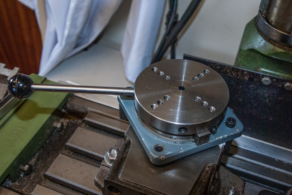

                  Barry – great idea – I've often thought about one of these and your excellent version ( and the pending need to resize quite a few screws) has motivated me!
                  Brian – I fully endorse Barry's recommendation of GHT's little rotary table.
                  Here, as they say, is one I made earlier!
                  A little off-putting for me at first was the dovetailed slot around the circumference of the table and even more off-putting was the need to make curved and dovetailed nuts to slide in it for the stops to fix to! Do not be put off by this – Follow GHT's explanation carefully and it really is a piece of cake!
                  The design calls for four "T" slots to be cut to allow work to be clamped to the table. Not having a "T" slot cutter at the time I chose to tap a series of holes so that I could fit clamps to hold the work. ( I arranged these so that I could cut the slots later when I got a cutter – so far I've not found the need to do so.)

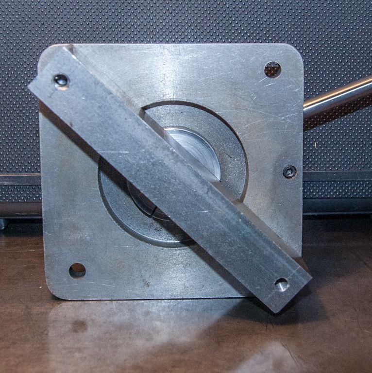

                  To make this quick and easy to use I keep a piece of bar fixed to the table
                  This means I can quickly pop it into the vice on the mill for those "little jobs"
                  I've made up a number of different sized "pins" to fit he centre hole – these can be used to locate through the holes in rods which need their ends rounding off. ( If that makes sense)
                  It's an interesting and useful project.

                    Handy idea for that blank taper i've got lurking about

                      Norman the rotary table looks good.
                      You guys have hit on a very good idea, with suitable adjustments to scaling i could make a "common" base which will take the compound slide (still haven't found it), rotary table and ball turning jig. Someone else put up some pics of a good looking ball turner but looks like maybe a little complex when reduced in size for the C1 (but wil check it out anyway.
                      Would need to make up a spare base so can use the rotary table on the mill (Emco 3).

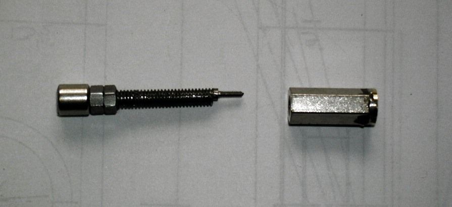

                          I recently had to shorten some 10 & 12 ba screws so made the simple chuck shown. I used a hex brass body with a plate soldered to the end with a suitable hole. The screw to be cut is held on the end of the 4ba steel screw by a magnet and is inserted into the body, tightened up and put into the 3 jaw chuck on the lathe where it is gently filed to length. I found the magnet useful in keeping the screw in place when the chuck is dismantled and can hold it intil it is inserted into the job.
                          Peter

                            Peter,
                            Neat little device for those tiny screws. For what I build I am mainly wanting 6ba or larger, on rare occassions 8ba. So the lantern chuck was sized for my own needs. That said your solution could be adapted to the sleeves I use, if I ever do any tiny work.
