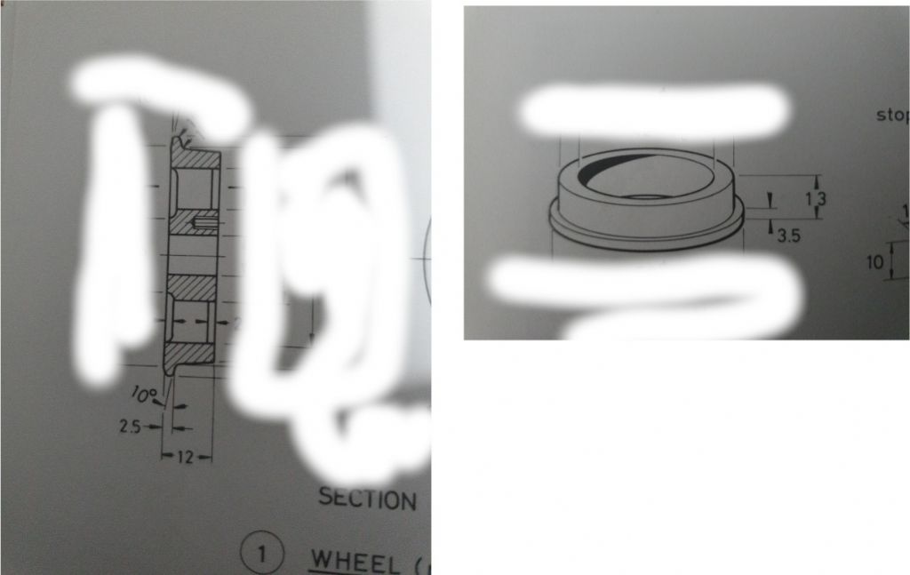

      I've just started building a kozo shay, and I'm currently on chapter 1 building the wheels. I've started with one so I can see how the process goes, but I think I might have got too keen and made the flanges smaller than they should be.
      I've got to the point where the blank needs to be mounted on a fixture to turn the tapers for flanges and tread, but the plans are difficult to read and I think that I have misread the flange width.
      Apologies for the scribbles on the plans but I thought I should probably blank out the non-relevant dimensions to avoid copyright issues.
      I've turned the blank (without tapers) to 2.5mm thick on the flange, as I thought that was the finished dimension for the base of the flange, but i think looking at the plans it may actually be 2.5 at the top of the flange. Should this cause an issue? From what I can see the worst thing that will happen is the flange will be slightly thinner at the outside edge, but given where the wheel runs and the small angle that might be fine? Any advice would be massively appreciated.

          I doubt that it will make any practical difference. If you want to calculate the difference of the 2.5 dim at the OD or at the base of the flange, you can find it by solving a right angle triangle of 10 deg and the adjacent side as (od-base dia/2). probably not a big number. In addition the Shay is not a high speed express locomotive so it will be unlikely to "hunt" on the track as a high speed loco might if the wheel gauge was a bit wide caused by thin flanges. The original Shays were specifically designed to operate on rough temporary track, sometimes badly laid, in areas being logged.

            It's a fairly poor drawing! I'd get a copy of the SMEE wheel standards and work to that. Even that is a bit iffy, measuring to the intercept between a cone and a radius. I did have a way of measuring it using a roller against the tread and flange, if you're interested send me a PM and I'll try to root it out. I't for 5"g, but I could work it out for 3.5 if that's what you've got

              Full size wheels often had a "tyre" shrunk on them as the old profile wore down. You could do the same with yours if you are very concerned. As already mentioned, it will not be particularly noticable if practice.

                Sorry for the delay, thanks for all the responses – It sounds as though it shouldn't be the end of the world.
                Given I still need to make at least 7 more I think I'll chalk this one up as a test part, finish it off to see how turning the tapers goes then proceed with the SMEE 3.5" standard wheels for the 8 that will actually end up on the loco.
