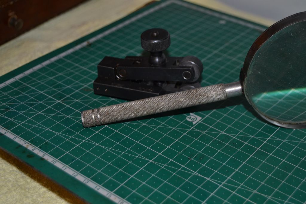

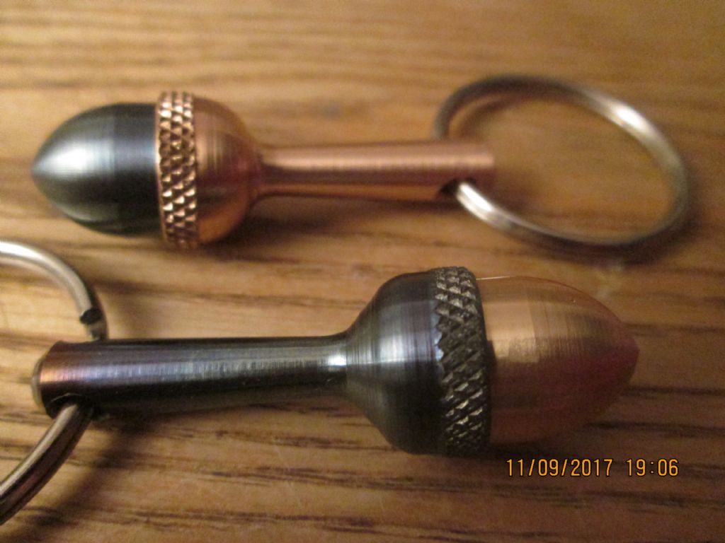

                      Mick B1
                        @mickb1
                        Posted by Neil Wyatt on 06/02/2019 16:23:34:
                        How do you know the 'cheap chinese' knurls are rubbish?
                        I think this one was £9.99 or suchlike. Every so often I have to squeeze the cheekpieces lightly in the vice as the pressure forces them apart, but it'd only be worth replacing it with something better and dearer if I was doing it a lot.
                        Edited By Mick B1 on 06/02/2019 17:16:44
