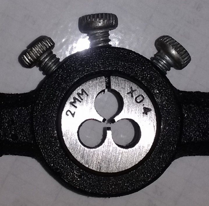

      I think this guy had too much of the old Baijiu, one of the knurls runs right off the top of the screw and the screws wobble more than he probably did. I actually laughed out loud until I remembered that I had handed over hard-earned money for this 'workmanship'img_20161201_192602819.jpg.

                  The quality of the holder is clearly apparent. If the die is of similar ilk, the user will not get value for money – however little it may have cost. Unless use once and throw away.

                      Now, that takes real skill! The knurling on the right hand screw is particularly impressive.
                      An apprentice, a hammer, file and cold chisel, Birmingham comes to mind. Certainly not China or India.
                      Do the screws have an ACME thread?

                        It appears to be, as far as I can see. The bad knurl is probably the result of a single sided knurl that has made poor contact, a clamp type wouldn't do this.
                        Infact, They don't look particularly "lathed" to me, more like a forged or cast kind of look about them, is it possible they did the knurl with a kind of a crimping hand tool?

                            The picture appears to show a low cost, badly made, die holder. It probably a cheap import from a non English speaking company (mm shown in capital letters).
                            The screws will have never been anywhere near a lathe, they look to have rolled threads but I cannot work out whether they were rolled before or after the head was upset.
                            I doubt the 'Knurling' was done by any rotary process.
                            If the holder body is usable why not just tap the holes and use some hex socket capscrews?

                              Thats always assuming that the diameter of the hole is the correct size for a die!

                                            I bet the knurls were not done by knurling, as we understand it. Rather they look as though they were broached – by pushing them through a die with internal serrations. Hence the result – cock-eyed in = cock-eyed out.
                                            And the threads are rolled, but again on undersize stock. So, make some proper screws and William Morris ( the one who made motor cars for the masses, not posh tat for the rich) will indeed be pleased.
