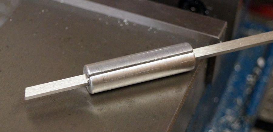

                            There is no need to buy a set of broaches, only the size that you need and make your own guide bushes. 3mm keyway broaches are available from $29 on ebay, 6mm for $43. I have a couple and good enough for hobby work. Larger sizes get more expensive.
                            You will need a lathe for makinging the bush, milling facilities for cutting slot in bush and shaft and a means of pressing the broach thru the bush. (before I had a hyd press, I used a drill press to push thru a 3mm slot)

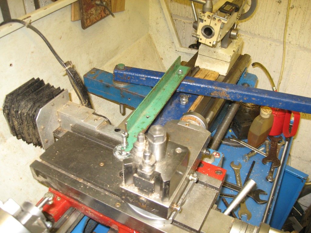

                                Les Jones 1
                                  @lesjones1
                                  This is a very crude thing I made to move the saddle backwards and forwards for slot cutting in the lathe. It avoids putting too much load on the rack and pinion.
                                  The lever pivot part is clamped to the lathe bed with blocks of wood and lengths of threaded rod.
                                  Les.

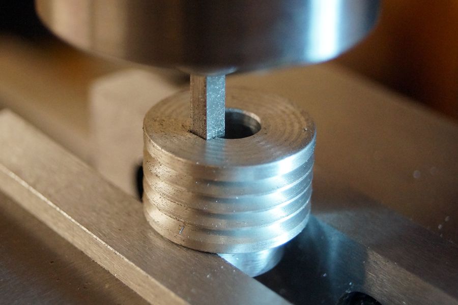

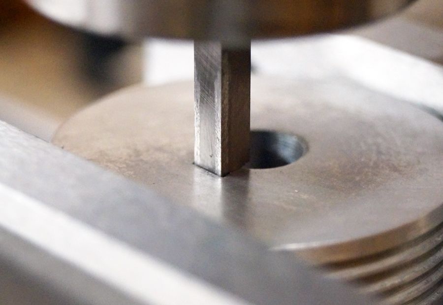

                                                  #393091
                                                  Ron Laden
                                                    @ronladen17547
                                                    I cut my first keyway recently using the mill and a piece of HSS tool steel, it worked fine and was easy and quick to do. See Jasons post above, it was after he showed me the method on the lathe that I gave it a try. I went with the mill as I suspected it would work as it does with the lathe. I found that the diagonal of the 4mm tool steel gripped nicely in a 6mm collet which made life easy. I also removed the bulk of the material with a 4mm cutter which just left the tool to square it out. I have a 3mm keyway to cut but not having a suitable size collet I thought of making a slotted sleeve to suit the tool diagonal and use a larger collet. I have also made a spindle lock from bits out of the odds box, works fine.
                                                    #393578
                                                    Ron Laden
                                                      @ronladen17547
                                                      Made up a sleeve to hold the 3mm tool and to fit a 10mm collet. I didnt machine out any material as I did with the previous 4mm keyway, just went with .001" cuts and it worked fine. Sixty cuts for the 1.5mm depth but it is really quite quick to do, I set the column head stop for the length of stroke which makes life easy.
                                                      I have only cut aluminium and small keyways so far, so dont know how it would cope with steel and larger keyways.
