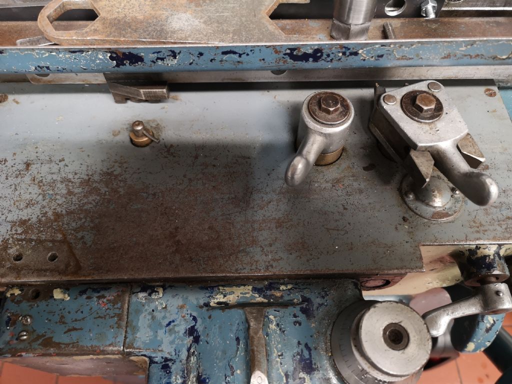

      I have bought a 540 surface grinder and the Dwell control lever is missing someone has put a bit of welding rod through the roll pin hole and the shaft seems to be dropping down into the bed so does anyone know where i might get one or where i can get a drawing so i can make one? i have tried all the normal places that google list for spare parts and flebay etc.
      A part number might help if anyone has it?
      any help would be great Bob

          Hi Bob,
          I have a 540 and a user manual. By dwell control lever do you mean the one that controls the table traverse speed? Further in the manual this seems to be called the table throttle valve and is listed as Item 15 E under section 15 " valve block and fittings"
          I think J & S still exist ? The manual says to quote code number, description and serial number of the machine.

              I have rang and emailed most places with no joy According to Hardines its the Feed Choke Lever they dont have any and are not sure when they will be making some more. it should be on the left the one with the wire through itimg_20190221_081710_resized_20190221_081824475.jpg

                Have you thought of making one, it is only a piece of aluminium you should be able to make a copy.

                    I had one of those but for an older machine so it was in brass. Threw it out a few months ago along with all the other 540 bits.
                    TBH for the half-hour's work it would take to make one I would not bother sourcing a genuine part.

                      Hi all just had a message back from Jones & Shipmen Hardinged Ltd they can make one at £175.50 so can anyone just do me a quick sketch of theirs with dimensions please and i will make one from billet.

                        Mine was a simple brass casting drilled for the spindle and cross-drilled for the pin. There's a reasonable image of one here:

                          I have someone making a drawing of theirs and measuring it thank you for all the help and replies.
