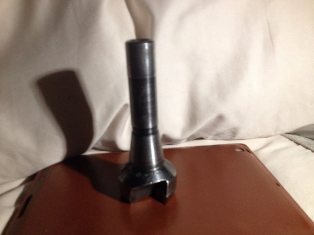

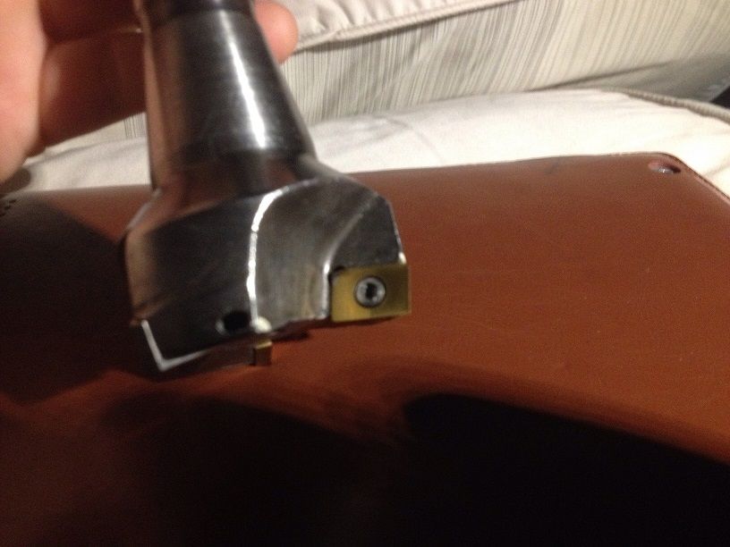

      img_2985.jpgimg_2984.jpgHi,would anyone have one of these and could tell me what inserts these are?Its and Iscar F75A -D50/2.0-R8.img_2981.jpg

              They look very much like these:
              **LINK**
              I'd have said the AD.. suffix was a clue. Available in two sizes from JB – you'll have to get the tape measure out.

                  It looks old and obsolete so you would probably spend more on inserts than it's worth.
                  The most popular modern cutters use inserts like the AP** style and you can get them from many outlets. Search for something like "BAP300R 50-22-4" which would be a 50mm diameter cutter with 22mm arbor hole and 4 inserts AP**1135 or the "BAP400R etc" which take the larger AP**1604 inserts. I believe these are based on a Mitsubishi design but I may be wrong.
                  For steels you might go for coated APKT style and for loominum you might want uncoated APGT. You can get these on ebay, Aliexpress and other places closer to home such as APT Tools, who stock these and other modern types.

                    Looks like an early Iscar Helimill. Not in my catalogue and inserts listed all have chip breaker rather than flat faced inserts as on you example.What are the dimensions of the inserts as fitted?

                        No, Oldiron, the inserts you linked to are modern, positive rake things which are much more advanced than the flat faced, zero rake inserts in the photos. They will generate lower cutting forces and produce a better finish under most conditions. Whether or not they fit is unclear but it seems unlikely.
                        Unless you are nostalgic about old, inefficient tools, you'd be better putting that tool on the mantle piece – or possibly filing it.

                          These look more like whats in the holder.
                          Why not contact Iscar and see if they can tell you the old number and then have a google to see if any crop up but as Murray says you can get a 50mm head, arbor and box of inserts for less than what a couple of iscar inserts will set you back.
