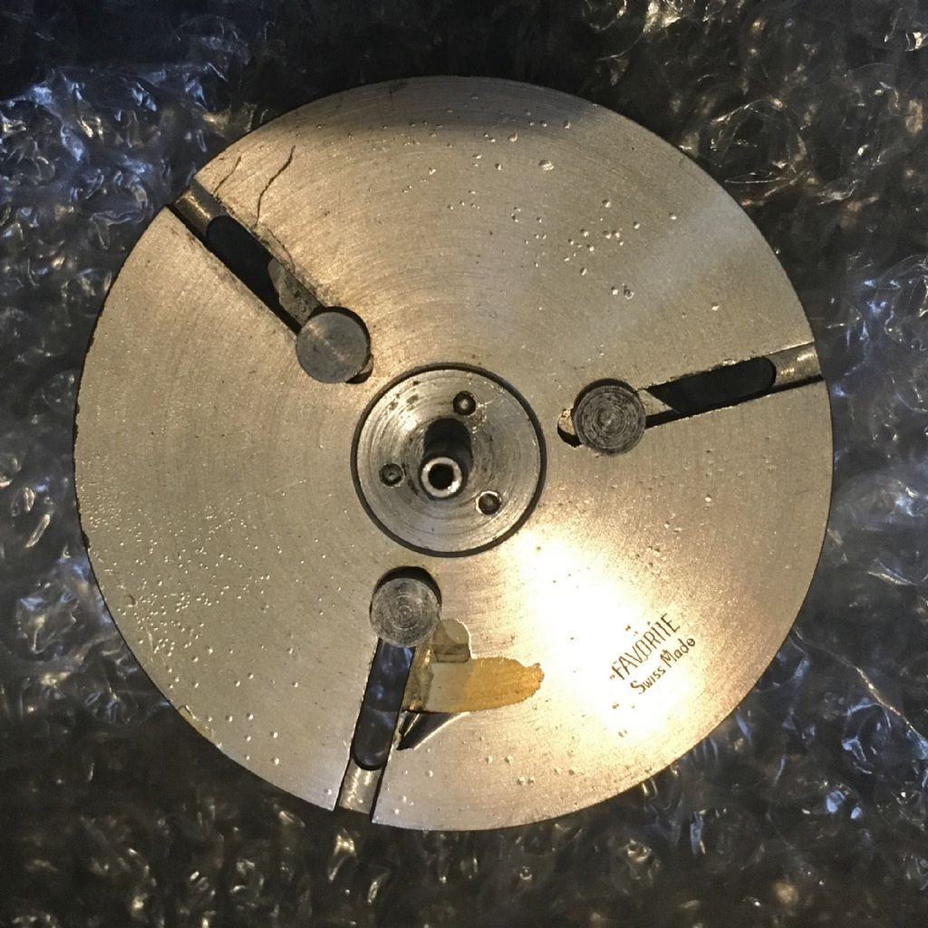

        I have a small table on a watchmaker's jewelling press.
        … The shiny plating is bubbling and peeling sad
        …. Please excuse the ‘moody’ lighting
        Horological tools are commonly Nickel plated, but this looks [perhaps] more like Chromium plate.
        I would be interested to know which it is; but have not yet found a simple, economical, test for either or both metals.
        Can anyone advise, please ?

          If there are flakes that you can pick off try one for magnetism. That said I'm not sure that chromiu isn't magnetic, just that nickel is.

              Chrome plating is much harder than nickel plating and usually much brighter. Compare a few items that are chrome plated using a fine steel scribe. Do not press hard and try to scratch the surface. The difference between that and normal steel and nickel is striking. Do not press hard because the plating is thin and if you press hard then the metal underneath will deform and it may appear scratched, Practice on a few chrome plate items and mild steel to see the difference.

                I would be surprised if it was chrome plated. Nickel has a slightly off silver colour towards cream or yellow. Chrome would be a cold neutral grey. An alternative called tin-nickel has been used on certain scientific instruments, like nickel in colour but less creamy yellow.

                      Thanks for the responses so far
                      To my eye, the plate looks a little more like Chrome than Nickel [and I have seen a lot of both] … which was the reason for my question.
                      It appears to be plated direct onto the Brass surface … which probably explains the problem.
                      I have not yet looked under the bubbling, but will be removing some samples of the ‘foil’ for inspection.
                      Ultimately, I may wish to strip it all from this component … which is why I feel the need to know what it is.

                            A brief update …
                            I peeled a strip of the plating from the Brass and have confirmed that it is slightly magnetic.

                              In the old day (ha ha) it went steel>copper flash>nickel1>nickel2>chrome. Chromium at ecenomic plating thickness is water porous so the water is heading for the steel. The two layers of nickel are put on under different regimes so do not have the same electropotential. This makes the water attack along the outer layer leaving the inner layer to protect the steel and stave off rusting until the warranty is over. Of course the side effect is your shiny chrome is undermined and flakes off but that is after the warranty period too.
                              Should have said if not obvious that chrome offers no protection it is only there be shiny. All that stuff about oxide layers etc is to protect the shine, not the metal. Only the nickel protects but now they skimp on that putting on just enough to key the chrome to get the shine to get out the door.

                                      Nickel will readily come off with an electric current and a mild acid bath giving a green/blue solution (reverse of nickel plating). Just start the process to see if the surface suddenly brightens.Chrome will not come off in mild acid.
                                      My experience from stripping chrome and nickel off old parts.

                                              When I was in plating, nickel was never removed electrolytically. A commercial stripping solution called Ni Plex was used. This was for nickel and decorative chrome on steel. I don't know about a brass base, though.
                                              If the plating will peel off, it will be nickel, that thickness of chrome would not be ductile at all and would crack off.

                                                Good point !!
                                                Despite it being shinier and less yellowish than most Nickel … I am rapidly coming to the conclusion that it must be.
