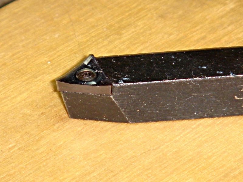

                  I did buy what ever of ebay but found that some didn't last as long as they should so am pretty sure that they were used and had been on cnc machines being used for production work where they are removed before performance drops off. Actually I saw a whole bucket full of tips like this at a dealers who was thinking about selling them. He invited me to look at them with an eye glass and no problems could be seen but the coating will have been part worn out.
                  Following suggestions from some one else I tried TCGT types. These are representative of the latest ideas on inserts. The form on the top of the insert is changed to provide a sharper cutting edge with rake. I went for 11mm ones as they fit holders such as these
                  **LINK**
                  Those are actually fitted with this style of tip and even come with torx screws. Mine had something else on them and used hex keys which are hopeless, the key soon rounds over. 16mm tips and holders are also available. The triangular shape is good because they can be used up to a shoulder even for facing it. I think 9mm are also available. I've since bought a proper holder but can't find one with the V pointing forwards so will have to stick with the 10mm ones or make one myself.
                  I feel that these tips do compete with HSS but I haven't tried highly polished HSS with more extreme rakes – yet. The performance drops of when the coating wears off but there are versions about that are polished and have no coating at all. These are mainly aimed at none ferrous and abrasive materials but some are also suitable for finishing stainless so I will be trying these on all materials at some point. I have used coated finishing tips for stainless as these were what I originally bought. They work well on ms, silver steel, brass and al. Al is probably the stuff that tends to wear the coating off.
