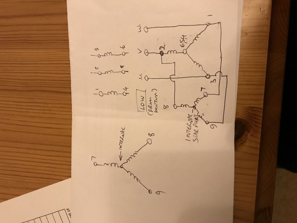

        So some investigation was needed. It seems I wired the motor to a choc block as in fig. 1 from the motor plate as shown in fig.2. It seems that this connection as shown in Wikipedia  is a modified star as shown in fig 3. As the motor should have been wired in delta as in fig 4 it should not have run at all!..
        But here is the conundrum, this diagram shows 6 coils so there should be 12 wires not 9. Some must be connected internally, or is it that I just don’t understand the workings of the two speed motor.
        fig 5 shows the coil resistance at 2.4 ohms for all but 7-9 and 7-8 @ 4.1 ohms
        I have tried unsuccessfully to sort out the diagram to account for this and the grey matter is spinning! I do not know what the colour coding means on the 9 motor wires

          It seems the left of the diagram fig 1 has been cropped. The connections from the top left are
          6
          4 blue
          9 red
          3 blue

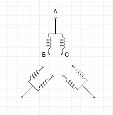

          John Rudd
            @johnrudd16576
            image.jpegDahlander motor wiring……
            Best if you can identify each set of windings using a meter, so you end up with all the wires identified. Then connect them as the sketches….
            #500564
            Zan
              @zan
              Thanks I was using something similar, problem is which wires are which, I have only 9 wires not 12 so which coil is where?
              #500569
                Posted by Zan on 10/10/2020 16:27:38:
                … I have only 9 wires not 12 so which coil is where?
                3 sets of two coils connected internally give 9 wires. With an ohmmeter (low resistance range of multimeter), first identify which groups of 3 wires are connected together. (A, B & C)
                Then identify the centre connection A of each triplet. The resistance between the two coil ends B to C should be greater that of either coil end to the centre, AB and AC.
                Write it all down, it's the sort of job I get wrong!
                Once the ABCs are identified, John Rudd's star and delta circuits can both be made.
                #500671
                David Davies 8
                  @daviddavies8
                  Zan
                  you have readings for 7-8 & 8-9 of 4.1 ohms. You don't show one for 9-7. If this also reads 4.1 ohms this proves that there is a star point buried in the motor windings. (The value of 4.1 ohms is equal to 1.732 x 2.4 ohms).
                  Following your link diagram taken from the motor, the low speed connection is double star, where 4,5 & 6 form the other star point and linking 1-7, 2-8 and 3-9 puts the two star configured winding sets in parallel.
                  If I knew how to attach my sketch I would.
                  HTH
                  #500673
                  David Davies 8
                    @daviddavies8
                    Sketch of double star connection added to photo album.

                    #500713
                    Zan
                      @zan
                      Thanks sod and David. Yes I missed the 9-7 at 4.1 ohm I discovered that at 2 am as there was no way for this to happen in a delta connection and found the 7-9, with repeated meter readings, and thus 78&9 could only be connected as a star, after 4 sheets of attempted drawings being the only possible way it would work . However by that time my head was spinning Too much to post!
                      I was under the impression that any star connection would not work at 240 v however after a lot of trawling with the Dahlander connections (thanks John, the actual name of the connection was a great help) I did find one reference to a star working at 240v but John’s diagram now makes this abundantly clear…
                      it seems that it was connected in the only way it would work and actually there was no problem at all! That’s The trouble with limited understanding, it’s hard to actually pin down to a faulty motor or inverter, and which caused the problem, one ,the other, or both!
