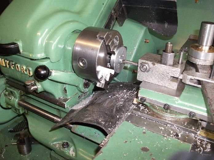

                    I've only had to do one keyway for which I used the lathe (S7) and fed with the rack. It was tedious but worked, in a pulley that I had to sleeve to fit a motor shaft when I added a VFD to my mill.
                    I have wondered whether the leadscrew would be stronger than the rack – though tedious by hand, since my lathe has CNC one could write a bit of G code that simply drives the Z axis back and forth over the required distance and slowing adds X feed to put the cut on. The same thing might be done on a CNC mill. My lathe has the standard Acme leadscrew on Z.
                    #510987

                        Posted by John Haine on 01/12/2020 09:52:58:
                        Could be a bit wearing on the old halfnuts I reckon.
                        LH Sparey or Ian Bradley suggests an easy way of converting the existing topslide into a slotting cutter by removing the topslide feed screw and using a long lever to crank the topslide back and forth.
                        The lever is pivoted on a bolt sticking up from a piece of 2" round bar stood on end and bolted to one of the cross slide T slots behind the topslide. And is attached to the topslide via a nut and bracket etc on the toolpost clamping stud. Lever then sticks out about another 18" or so. Easier to crank and no stress on feedscrews or racks etc.
                        I swore after the last time I tediously slotted a faux-Myford change gear using the rack method I will never do it again and will make one of the above.
                        A bit of fettling and a variable stop could be made to use it for engraving lines on handwheels and the like.

                        #511009
                        Roderick Jenkins
                          @roderickjenkins93242
                          Like this:
                          I think it's  a Len Mason design.  Came with my s/h lathe.
                          Rod
                          Edited By Roderick Jenkins on 01/12/2020 11:19:33

                              Posted by Roderick Jenkins on 01/12/2020 11:13:32:
                              Like this:
                              Rod
                              That's the way to do it. Even simpler than attaching to the toolpost. I have a new project for the week. Thanks for the pic.
                              #511139
                              Nigel Graham 2
                                @nigelgraham2
                                Simpler than attaching to the tool-post, and possibly stronger.
                                Might be worth making a special tool-holder that goes on the stud vacated by the QCTP block, to bring the tool much closer to the line of action, and with a down-projecting flange that transfers much of the force from the stud to the front face of the slide itself.
                                My thinking there is that although taking very light cuts, using the lathe like this may still put more force on the top-slide than does normal turning. The flange would also automatically align the tool every time with the slide, if the clamp part is bored in-situ.

                                  Roderick Jenkins
                                    Posted by not done it yet on 02/12/2020 06:25:22:
                                    …Why try to make a shaper out of a (small?) lathe when you have the proper machine for the job already?
                                    In my case it's because the job is already set up and securely held in the lathe and cutting the keyway is just one of a number of operations on the part. Much the same reason that I sometimes choose to use my tool post milling spindle rather than the milling machine. So many ways to skin a cat 🐱
