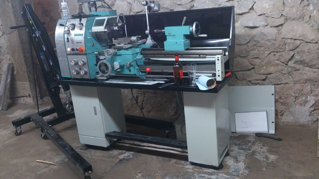

            Robin Graham
              @robingraham42208
              Hi Russ, not too late, when I read your post I had sort of come to the same conclusion, though it would be more like 10 of me than 5 to make 550kg! I was thinking those Victorian cast-iron baths which weigh around 150kg, say 200 litres of water and a portly Victorian gent must come somewhere near, and these are often found on suspended wooden floors I think.
              Anyhow, job now done, machine is sitting on eight levelling feet direct on the flagstones. Seems steady enough. John S brought an absurdly sensitive level along and declared himself satisfied with the setup, so I'm happy.
              For the rest of it, it looks as if the flags are indeed about 5" thick, and laid direct on 'dirt' – there's some redevelopment work going on to adjacent buildings and they've taken the flags up there which look to be of the same vintage. So there will be some damp coming through I guess. At the moment it's liveable with, RH was in the 90's @ 16C when we moved in, now 70-60 @ 18-21C. No rust so far!
              Thanks again all for your comments on both the lathe installation and cellar renovation, Robin.
