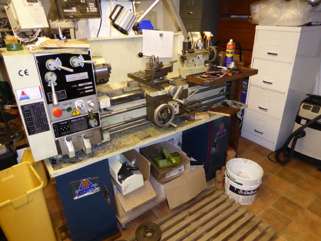

                                  I had the same problem as you. I purchased a Chester 12×36 Geared Head lathe and had to get it into my cellar workshop. The lathe weighs about 650Kg and I was warned NOT to remove the headstock to ease getting it down the cellar steps. I didn't remove the saddle 'cos it helped to balance the lathe during the move. The bed was attached to a hefty lump of wood that could be used as a skid. All moving was done on short lengths of scaffold pole rollers.
                                  I rigged up a sort-of ramp on the cellar steps – it had saw-tooth shaped supports that rested on some of the stone steps. I also made a reinforced surround to the cellar door, which held a length of scaffold pole to which I fastened a small block and tackle. The lathe was manoeuvred to the top of the cellar steps, and the block and tackle used to control the descent. The rest was just plain sailing by the use of rollers and an engine crane.
                                  The lathe sits on machine supports on a 4" thick concrete floor laid over a membrane on earth. It was installed in 2003 and its fine and stable.
                                  I made some duck boards to stand on – warmer than the floor and the swarf drops through the slats.
