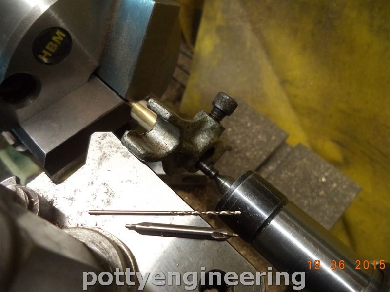

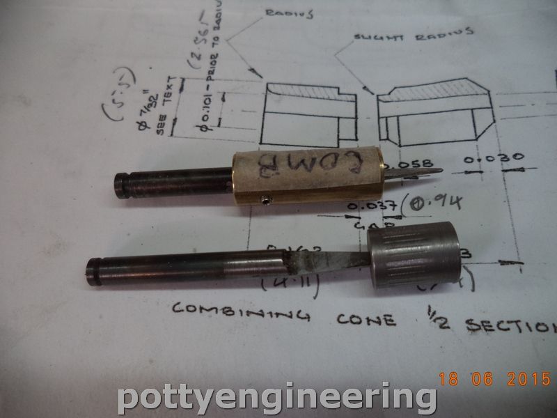

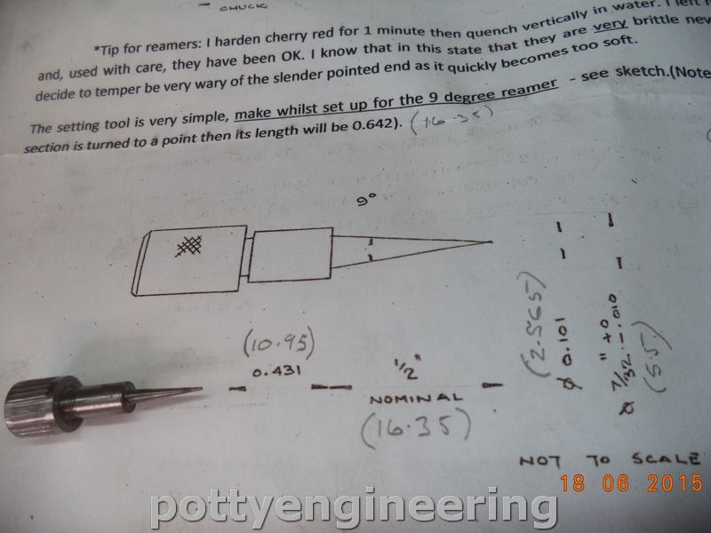

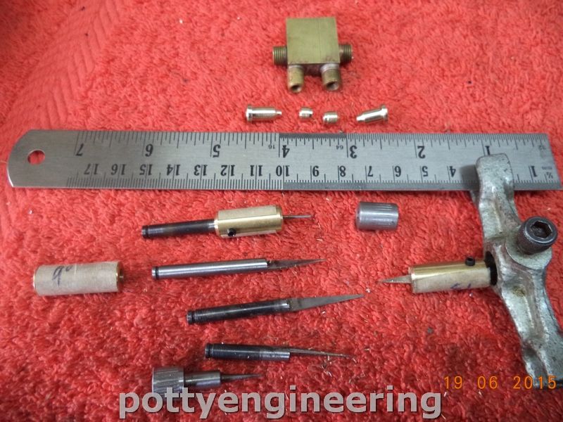

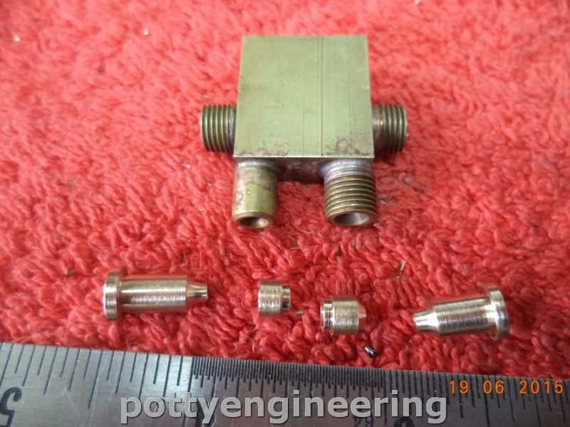

        This is a very good thread:-
        Quote from Julian
        to make a successful injector in miniature you dont have to know 'why' but 'how', and appreciate the nuances and pitfalls of what makes these things work.
        How very true I made a batch of five the first one worked a treat so I just nocked the remainder out whoops not a one worked:- traced the problem to a change of brass bar that was a little softer than that what I used for the first:- result was that the D bit belled out the mouth of the steam cone when I cut it, so I changed the machining sequence to machine the OD last so taking out the bell mouth.
        just for interest her's a few pictures of the process.
        Stew
        PS got the pics in the wrong place OK now
