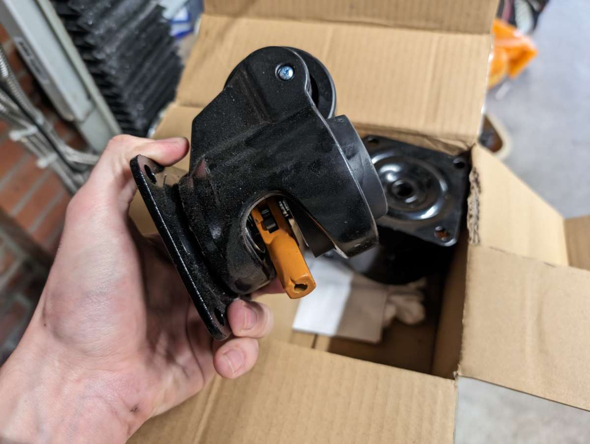

                    As for the hatch at the bottom for removing the sand, it’s only going to be a small base, and it’ll have some very heavy duty leveling castors (rated for 1000kg) on the base as well.
                    It’ll make more sense once I get it made. It’s only a small milling machine (125kg) so it shouldn’t be a problem. I could do with the machine being a bit taller too as then I won’t have to lean down as much.

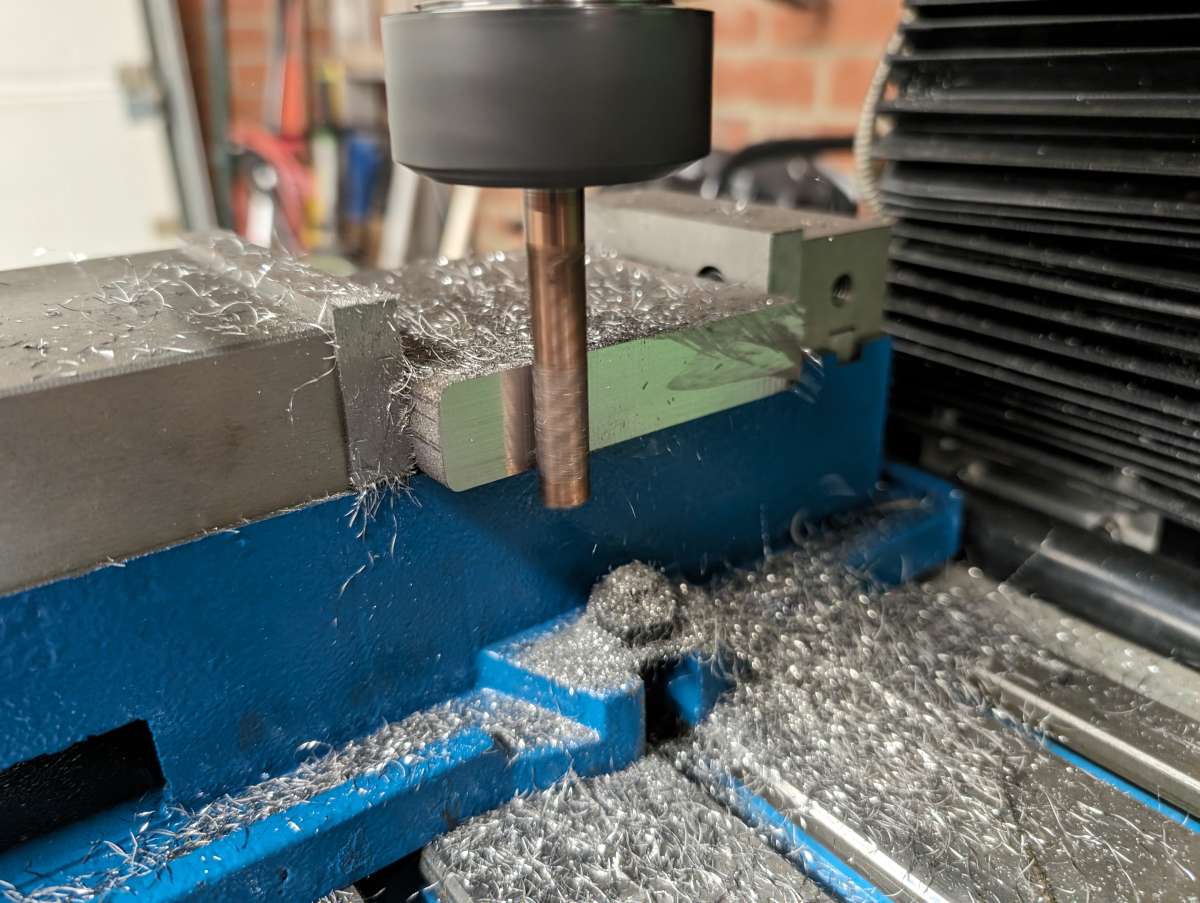

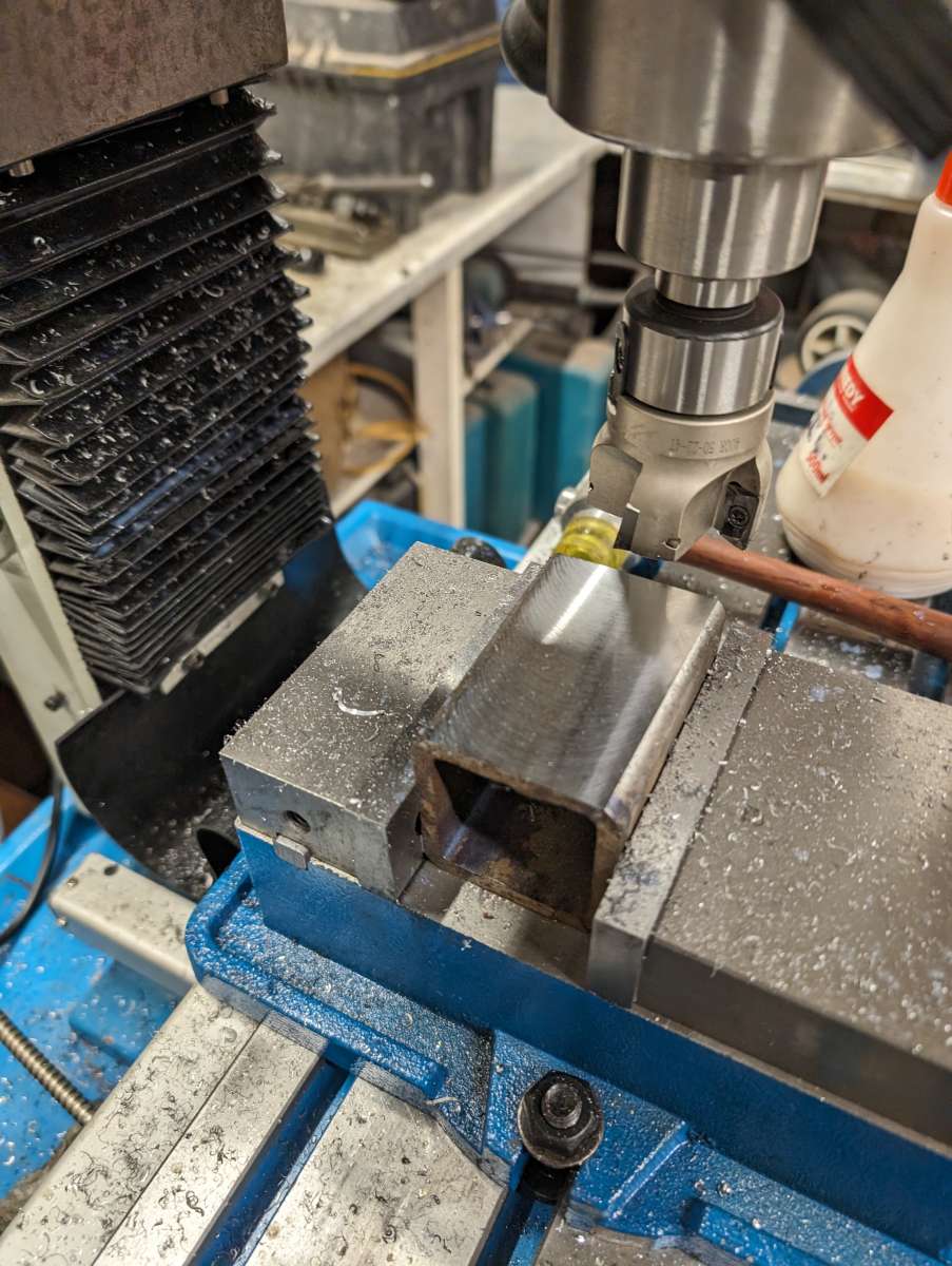

                    PXL_20240531_124915313.MP

                            Hi Hopper, thanks for the message, yes I have seriously considered that these machines are not meant to be on wheels.
                            Realistically this machine may be moved once or twice until I find where I am wanting to keep it in the garage. it will not be moved frequently.
                            I’m mainly using these casters as they have the option for leveling (the garage floor is not level) so consider them leveling feet rather than casters.
                            The cabinet will be full of all the attachments and accessories.
                            If anything, with the base i am making, it will increase the footprint and ensure that it is level.
                            Once again, it is a small milling machine (Amadeal AMA25LV), not dealing with a Bridgeport here. I understand the risks and i think they are not going to be an issue for my use.PXL_20240527_104228969

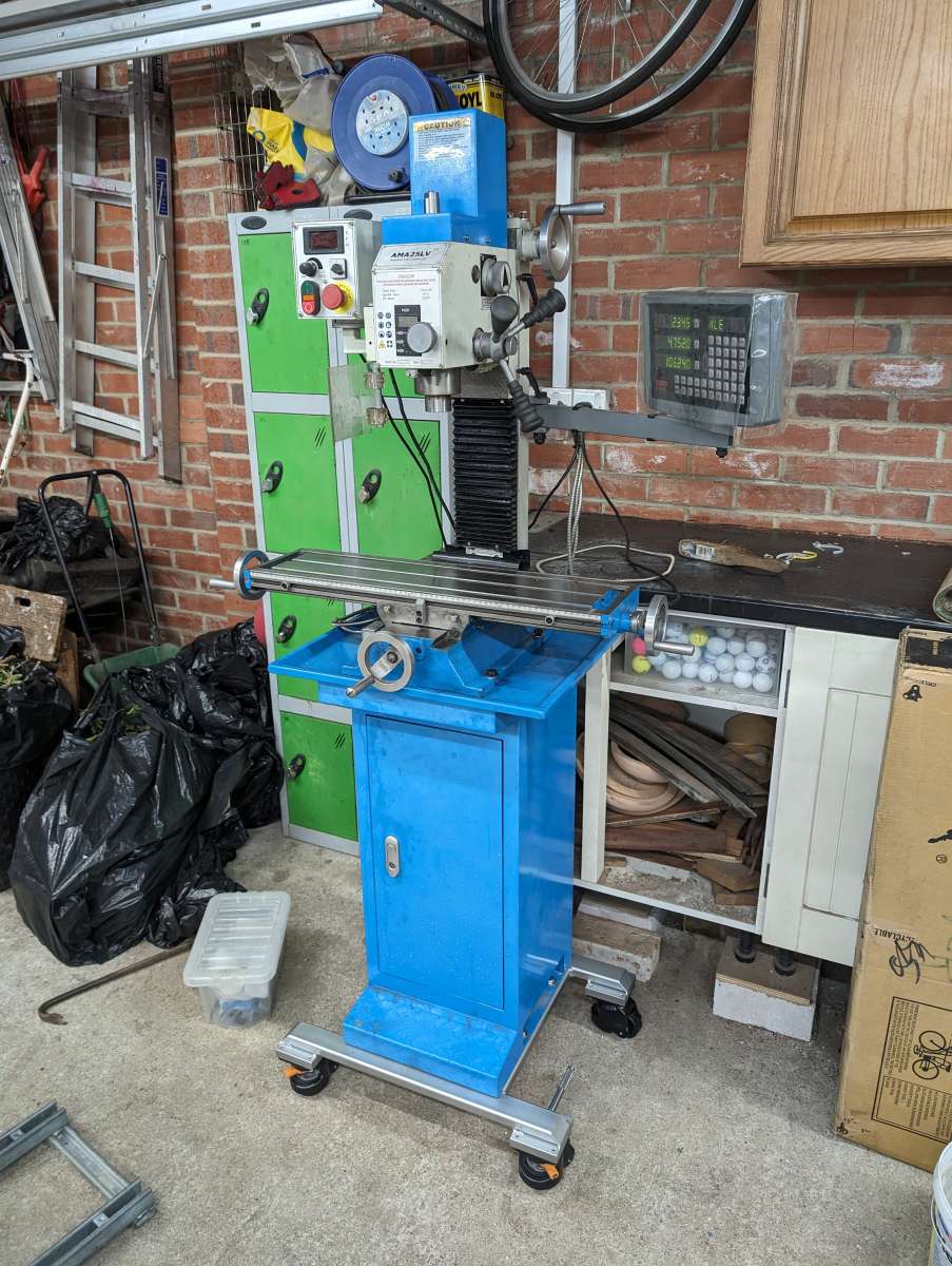

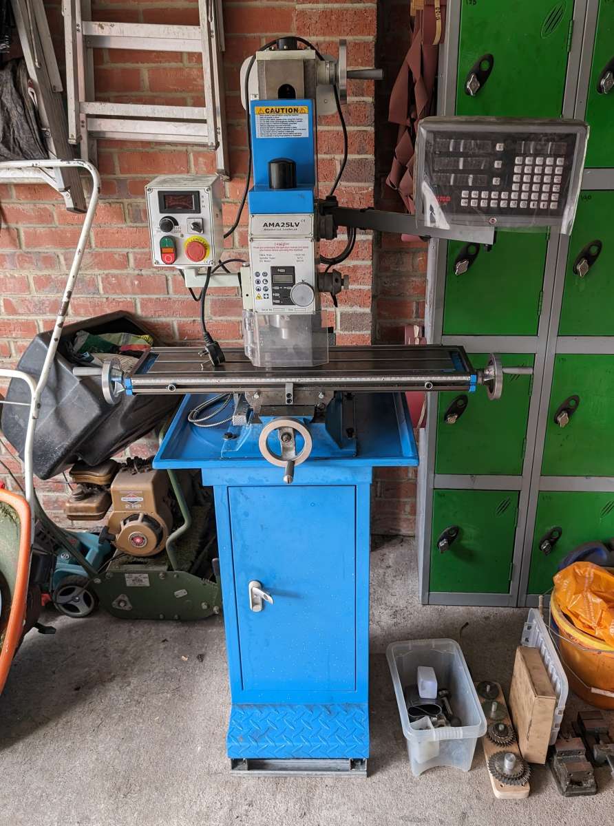

                                          All done. Very happy with how it turned out, i do wish I’d made it slightly larger, but the mill is very secure when the feet are down, and is very easy to move otherwise.
                                          Adding the sand did help overall, but minimally as expected. I didn’t get around to weighing the stand, but it was not easy to move around.
                                          Having used the mill now, it is at a much better working height for me.
                                          Thank you all for the advice!
